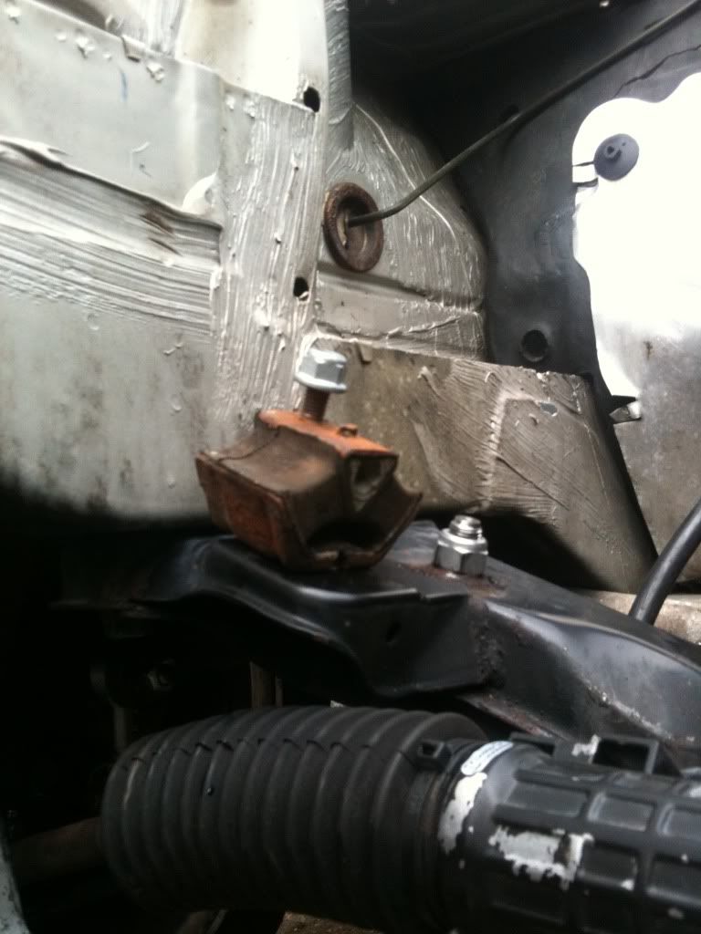

Does it matter if I use hex bolts on the clutch plate> flywheel. I know the ones they're meant to be are Alans but doesnt seem to be fouling anything.
Also I am not happy with the big 30 mm gap between the engine and firewall, even though its sitting on the mounts perfect, the angle (as in linear> engine to back of car etc)
Hmmmmmmm. I know some have used the larger e46 mounts which do look manlier! Info pls

No 30mm gap on my engine.... actually its a -160mm gap to the bulkheadturk wrote:Does it matter if I use hex bolts on the clutch plate> flywheel. I know the ones they're meant to be are Alans but doesnt seem to be fouling anything.![]()
I'm not too sure what you mean by the angle... do you mean the engine is sitting in crooked?
You possibly have the rubber mounts turned the wrong way, have you got the AKG ones or still using the E34 ones.
Mine was sitting perfectly with some used but still perfect E34 M50 mounts I ha lying around just for test fitting etc until I get the AKG ones.
I'm using custom mounts now however based on E36 mounts but also bolt upto all the holes available so no chance of them moving about on the block or fear of them not looking manly enough:D
If you feel you need the E46 M3 mounts, give me a shout and I can send you over mine if you can't find any on your side of the pond.

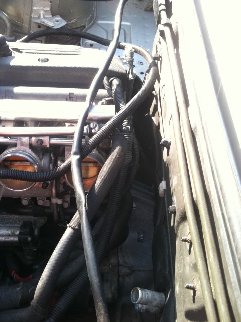

I have e46 m3 mounts here, Havnt tried em yet. Theyre a hell of a lot higher then the m353i ones, which would consequently make the engine sit higher. which may not be a problem, but also look too wide to be able to match the holes without fouling the chassis rail.
When I say the engine is off angle, I mean if u were to measure the space between the right and left side of the engine to the front where the rad sits, the right side (from inside the car) is about 2 cm closer then the other. It could be the mount but i ran out of patience so left it for another day and started playing witht electrics instead.

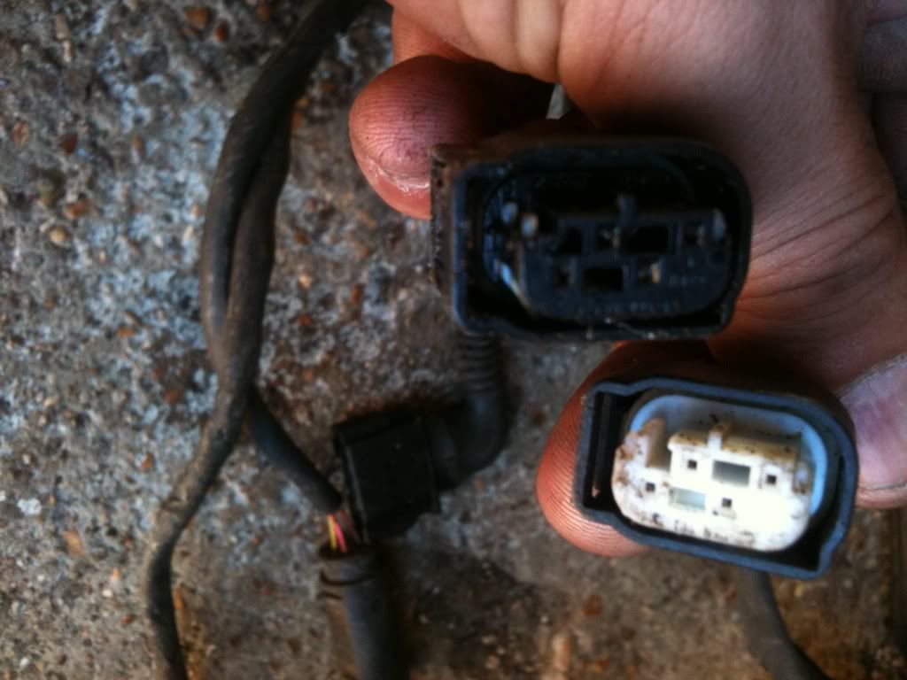

can anyone tell me where these go? There is nothing Ive got they'll plug into, poss something on the car?
looks right at home if u ask me
this is my gap as it stands, i havnt had a proper fiddle with the mounts yet but hopefully it dorts it...
turk
- E30 Zone Squatter
- Posts: 1879
- Joined: Sun May 20, 2007 11:00 pm
- Location: Portsmouth
they come off near the large round plug(smg plug I think), near with what look like the rear 02 sensor plugs.

would they reach to where the air-pump would be?
roughly where the e46 m3 header tank would be
turk
- E30 Zone Squatter
- Posts: 1879
Nope, the airpump has a fairly hefty 2 pin plug which im gonna have to make up as thats not on the loom either, but these are female 4pin and look very thin. can only imagine them pklugging into some sort of measuring unit like a temp sensor or similar. doesnt look like theyd carry much current. Im probably wrong mind

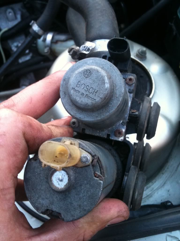

Ps!, did u reuse the electric pumps on the heater pipes? didnt know if they were to be used with the e30 heater matrix

no, i ran the coolant/matrix pipes in a similar way to a s50 conversion

GermanGorilla
- Posts: 528
- Joined: Mon Feb 07, 2005 11:00 pm
Hi,
I am assuming your going to 'push' that
S54 back so that the rear face of the head
is very close to the bulkhead/heater cover plate ?
At around 190 kgs in standard, you want the
6 cylinders as far back in an E30 as you can
possibly get it, no matter how hard it is.
On engine mounts are those Shore 80 Poly ?
If so they will work but will twist a lot.
For a Road car, you can use the BMW E28 M5
round rubber mount on the exhaust side and
an E36 M3 Evo on the intake side.
Rotataing them through 180 deg should get that engine
back to a better position in the engine bay.
If not you can rotate them backwards till your as
far back as it will go, and then drill some new locating
holes in the subframe engine mount plates so that the
anti twist spigots locate to stop them rotating.
Regards,
The Gorilla.

I had never considered drilling new holes... I will be trying to get the engine as far back as possible of corse, just havnt had the time to play lately.
I have these mounts spare, is this what u are referring to as the evo ones?
They are a lot taller then the e28 ones, hence it would push up the inlet side.
If u have done any drilling before have u got any pix?

Hi,
No I do not have any pics but have
done it a few times now.
The further back the engine the better
the steering clearance.
You should also fit the E30 M3 Front subframe
gussets that fit to the underside of
the subframe if thats a std E30 one ?
You will see them at Turners, Vac and BMW2002
and AKGMotorsport Websites.
AKG do some good mounts as well.
Regards,
The Gorilla.
Regards,
The Gorilla.

So if im understanding u right, i need to drill a new hole (and weld a reinforcement plate around it) somewhere between the exiting hole and the wishbone nut?
should i yank the engine back first and see how far back it will come or set the hole in a position where it wont foul the wishbone nut and twist and beat the engine into submission?
S54, S62, S65 & S85 Plug & Play loom/Ecu Kits
Sump Baffles
Engine Conversion Kits/Parts
TrackDays
Sump Baffles
TrackDays
GermanGorilla
- Posts: 528
Hi,
No, the reinforcing plate is welded underneath.
You do not want to raise the top 'flat' that the
engine mount bolts through, otherwise you
would be 'rasing up the engine'' thats why you
weld the plate/gusset in underneath.
In welded it in underneath, make sure
the 'new' plate is tight against the flat surface,
you can the drill you locating hole where ever you
require it.
Make sure the plate/gusset is not to thick as
the thread on the bottom of the engine mount
will not be long enough.
Regards,
The Gorilla.
require it.
Regards,
The Gorilla.

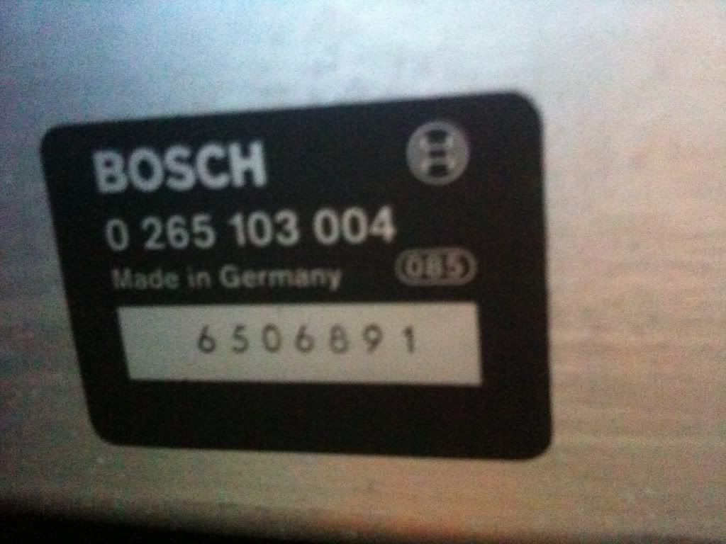

is this a auto box ecu or engine ecu?
I seem to have 2, one on each side of the dash, Any ideas?
