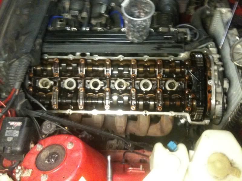

guys from the pics that you saw which areas can you pin point as the bodges i have now called my solicitor wont take this mess now

not damaging it, but it won't make anywhere near the proper power with that manifold fitted, the S50 engines need the equal length headers and the x pipe to make the power. I'd doubt they have even fitted up both lambdas either
Fri Dec 30, 2011 2:14 pm
Air fliter is too small, wrong exhaust, wiring looks shoddy and the ECU should definitely not be mounted on the inner wing!
God knows whats happened with the brakes or coolant pipework but its not likely to be any good looking at the above pics.
Basically, as has been said previous, it looks like you will need at least £3k to get it to a 'basic' acceptable standard

I thought the M50 manifold doesn't line up with the S50 exhaust ports.

The stud pattern is the same but the manifold ports are a lot smaller than the ports in the head, the exhaust gases are literally hitting a wall when they leave the head. Probably 30-40% smaller

Fri Dec 30, 2011 2:43 pm
The whole thing looks an epic bodgefest..
What engine mounts have been used?

The problem with the ecu is that it was designed to be housed inside the cabin along with the other black box above it which i think is the vanos controler. These use non waterproof connectors and wont respond well to getting wet.
It all looks a bit thrown together in the easiest manner but should be sortable once you get it back. I think i would be looking to get all the other leftovers back from the M3 too so you have all the parts you may need and can ebay off whats not required to fund getting this put right.
