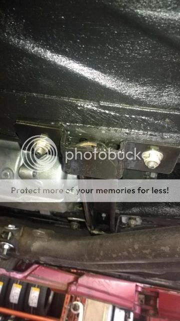

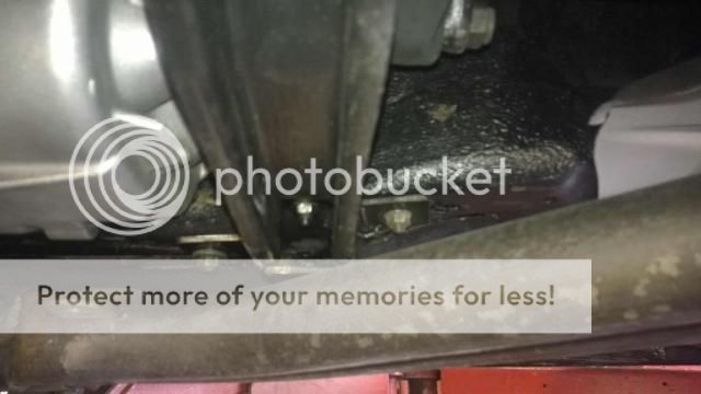

you can use an e36 m52 prop but it needs to be shortened and balanced , i'm having this work done soon for £60 ...are you aware that you need to make some sort of custom brackets for the gear box mounting ...
i have pics of a decent design and a bosh it one lol

Sat Feb 07, 2015 9:13 pm
in the top 2 pics the gearbox crossmember is actually welded to the 2 brackets also.
The 2 supporting brackets are made from 3mm thick steel
It's strong
