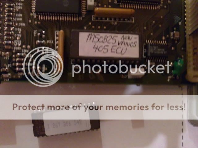

chipping m50 ecu ??? >>pics<<
Post Thu Apr 14, 2011 8:49 pm
i've removed the top cover and cant see anywhere to put the chip.
where does it go :?
it's much bigger than any of the ones in the pic ^^^

Its a dual layer pcb ecu. You need to remove that pcb board and the chip is on the layer below

Cook318IS wrote:Its a dual layer pcb ecu. You need to remove that pcb board and the chip is on the layer below
gonna check that out now :D

Its a bit fiddly to split the board for the first time but its easy after that
http://3seriesblog.com/how-to-change-th ... n-dme-e36/

Cheers Paul,very helpful :thumb:
the chip has a new home.

magpie, you may want to check that the 403 ECU works with this chip, as it's intended for a 405 ECU.
Post Tue Apr 26, 2011 3:55 pm
Speedtouch wrote:magpie, you may want to check that the 403 ECU works with this chip, as it's intended for a 405 ECU.
it's now fitted to the car and working well,rev limiter is up to 7.5k rpm now and seems a bit more responsive :)
