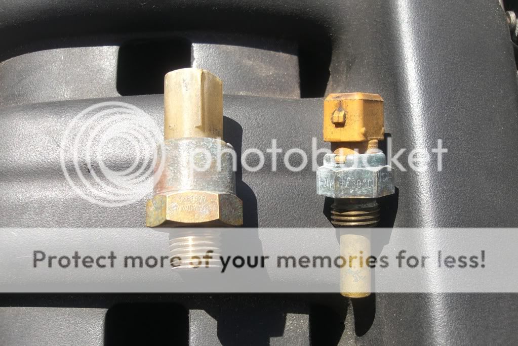

I`m ready to make the wire loom for the fan.
I`m using a 80c thermostat,not sure what temp switch to use for the side of rad.
I`ve got these
The one the left is from an E36 323 and says 91/99
The one on the right is an E30 and says 130
I`m assuming these are both too high? If so which one do i get and from which model car?
Not actualy got a fan yet but want to get it all ready, bar the connector until i know which one to use..

The rad temp switch that I use is from a E36 318. The temp is 80/88. PN 61 31 8 376 440.
I use E30 aux fan wiring diagram for this.
