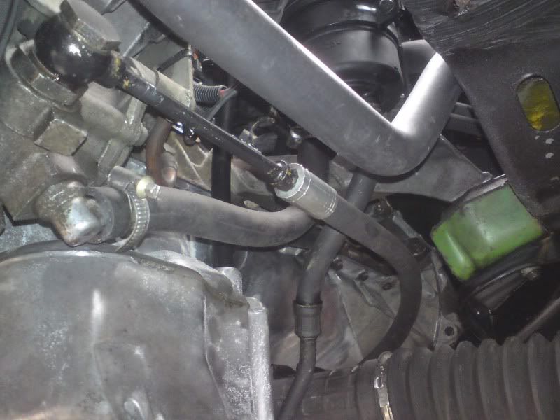

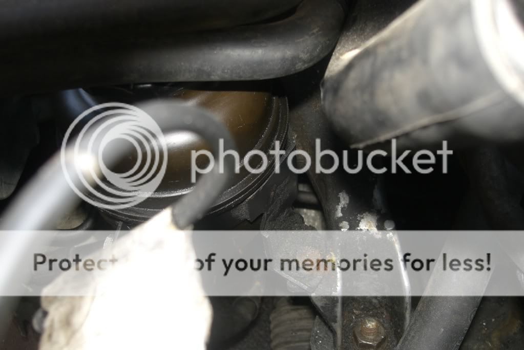

Yeah it was a PITA indeed.bimanut wrote:Not the best of pics but you can just see the mounting bracket for the bottle.
It is a bit of a pita to fill but i use an oil syringe to make things easier and cleaner.![]()

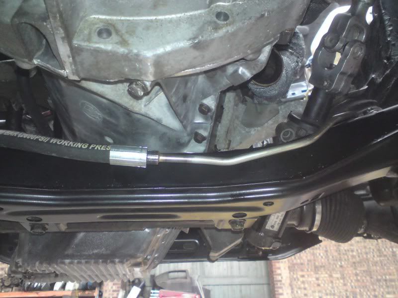

No idea yet, I can tell you the pipe I had made at Pirtek on Saturday cost £45, according to their computer it should have been £90 but he gave me discount and didnt charge labour as ive used them before.
Hopefully I will be able to get the pair of hoses (pressure and return) for around this price

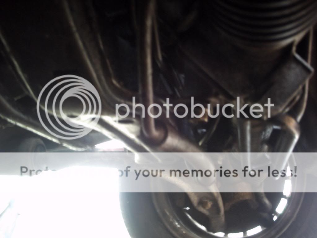

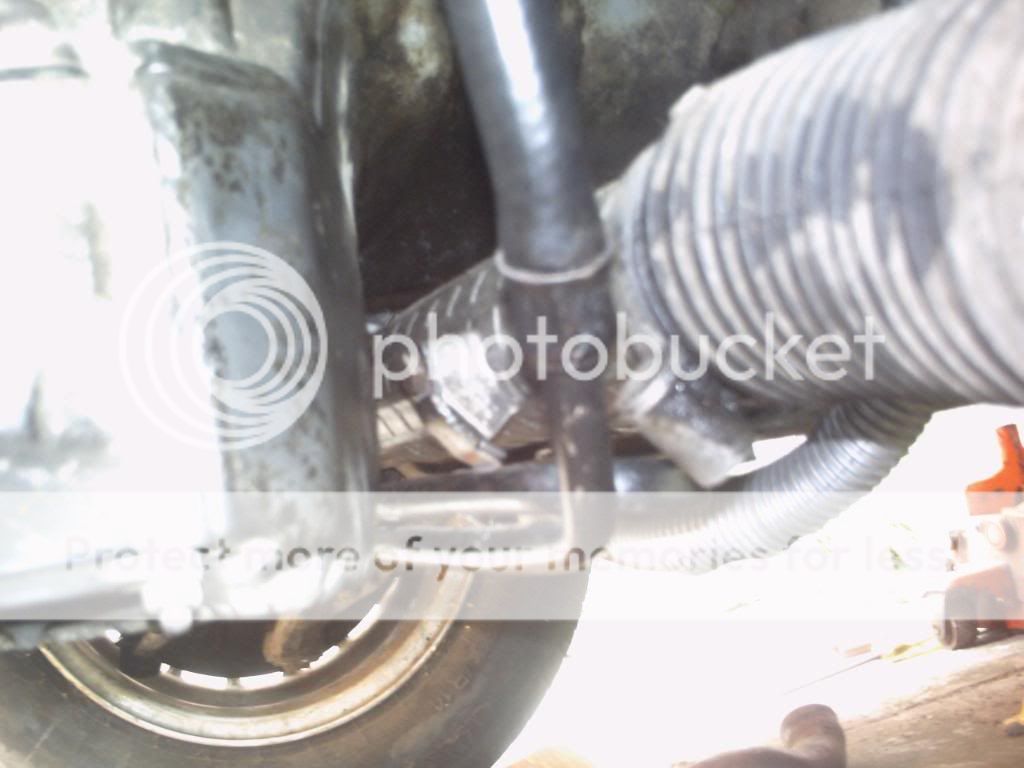

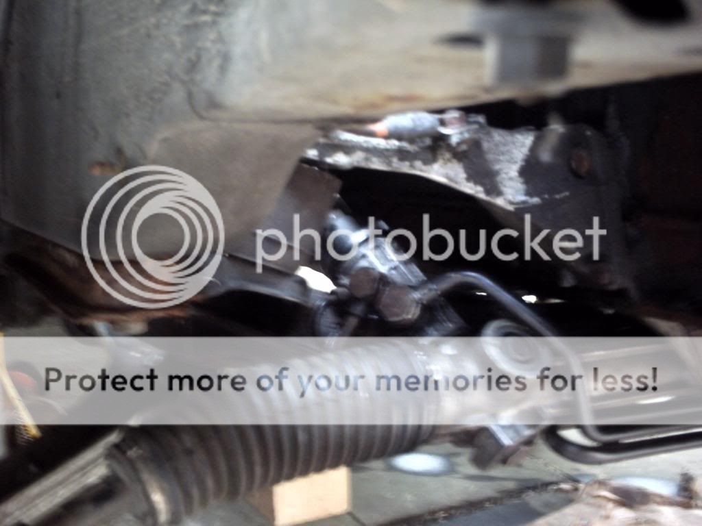

both of mine were well and truly butchered into place, and they still don't fit right. particularly the return with the cooler loop.bimanut wrote:There was plenty of sqawking rages now and then but after a few bends and tugs it fitsDanThe wrote:Tweak is defo an understatement

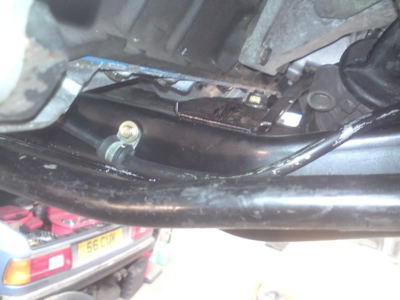

same here, i left the feed running round the back of the subframe and bent the hell out of it to reach the pump. the return is just bent a bit and left hanging lower than the sump ATM.DanThe wrote:I did similar with my first M50 but didnt like the idea of a pipe under the car open to damage from stones etc, will post some pics of the pipes ive had made later
