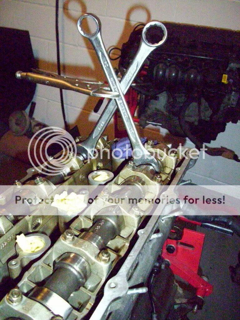

You don't need the special BMW tool to lock the camshafts you can do it this way....
Dan will be cringing now

Nope, even Bob used the BMW tool. He's sleeping with the guys in the parts department at our local dealer though - so they lent it to him in return for something.......!Jhonno wrote:That has to be a Bob_S solution..
