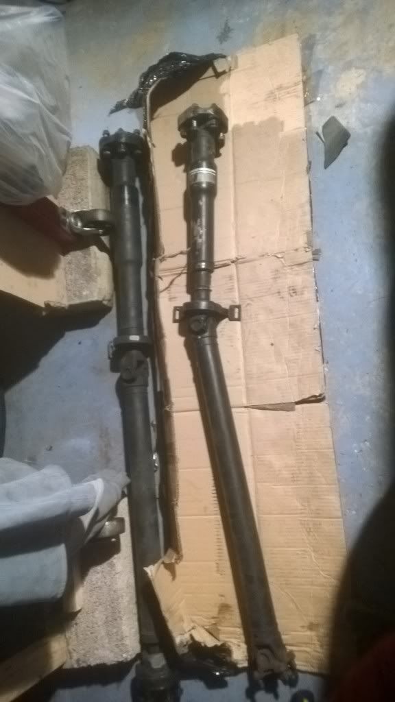

Hope this will resolve the great prop shaft debate.
So the m52 with the e30 m3 prop fits perfectly, nice and tight
The e36 m3 3.2 6 speed box is exactly 7cm longer
Here are the measurements
Length of e30 m3 prop is 146cm flange to flange
Length of e36 328i auto prop is 128.5cm flange to flange
So basically the 328i auto prop is too short, even extended fully it was too short, like Dan said
Interesting the e36 m3 3.2 prop is 131cm , again too short and of course has the wrong flange on the diff
So basically we need a 139cm prop (maximum) in lengh, lets say 138cm to give us a fighting chance of fitting it easy.
So the only answer is a custom prop
Hope that helps
Anyone recommend a good place I can get my e30 m3 prop shortened and balanced?

jimbom30cab
Tech 1 freak
Posts: 7634
Location: in the garage
Tue May 13, 2014 11:08 pm
e36 328i auto prop on the right
e36 M3 3.2 prop on the left
Posts: 28644
Wed May 14, 2014 12:05 am
You are better off getting an E30 prop front half shortened and an E36 large flange welded on the front end of it
