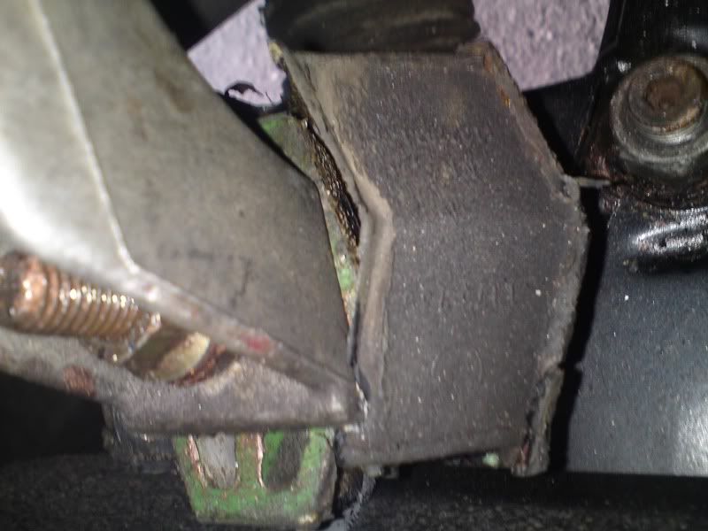

Why not to fit the square mounts,,,

how long they been in for?
Wed Feb 09, 2011 12:43 pm
Used them for a couple of years on my M50B25, they were fine when fitted to the chromie with the 2.8 but I noticed the drivers side started to crack/craze which I assumed was from the heat being close to the exhaust, so the manifolds were wrapped. The drivers side seemed to deteriorate quickly with the 2.8 (240hp) so when I fitted the alpina after 3,000 miles of running the 2.8 I didnt use it again but the passenger side was still good, ive done about 1,000 miles with it and its now in two pieces :?
AKG mounts will be going on now...

DanThe wrote:Used them for a couple of years on my M50B25, they were fine when fitted to the chromie with the 2.8 but I noticed the drivers side started to crack/craze which I assumed was from the heat being close to the exhaust, so the manifolds were wrapped. The drivers side seemed to deteriorate quickly with the 2.8 (240hp) so when I fitted the alpina after 3,000 miles of running the 2.8 I didnt use it again but the passenger side was still good, ive done about 1,000 miles with it and its now in two pieces :?

AKG do specific ones for m5x and s5x swaps with a special angle and IIRC group N grade poly. I have a set.
Expensive mind. Think I paid around $200 but well worth it.

i have them too. been fitted a year and not moved a millimetre in the relatively small 2k that i have done.
