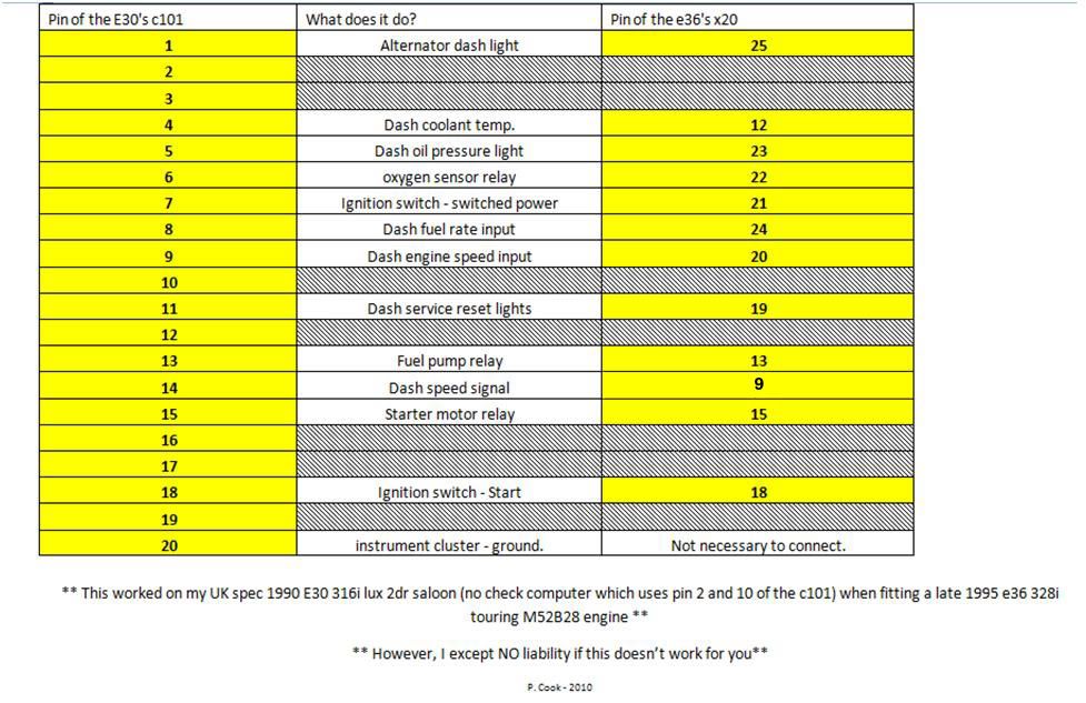

you have wired the ews in yeah? The unused cores of x20 i just essentially taped up and tied them into the wiring cover (not quite that crude but it gives you the idea).
Did you use the wiring diagram in the sticky of the engine conversions section? I found that pin 14 on x20 wasnt there either. i made this of the connections i used
it doesnt include the connections for the check control panel because i dont have one of them.

ok , thanks guys, i did not think my engine had EWS so if it has then it is probably that ! it does turn over though, i have tried the fule lines both ways round , and i am pretty sure i had it right the firs time ( fuel pressure regulator on fuel return ) pin 14 is now connected to pin 9
