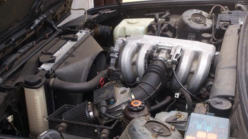

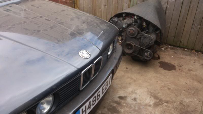

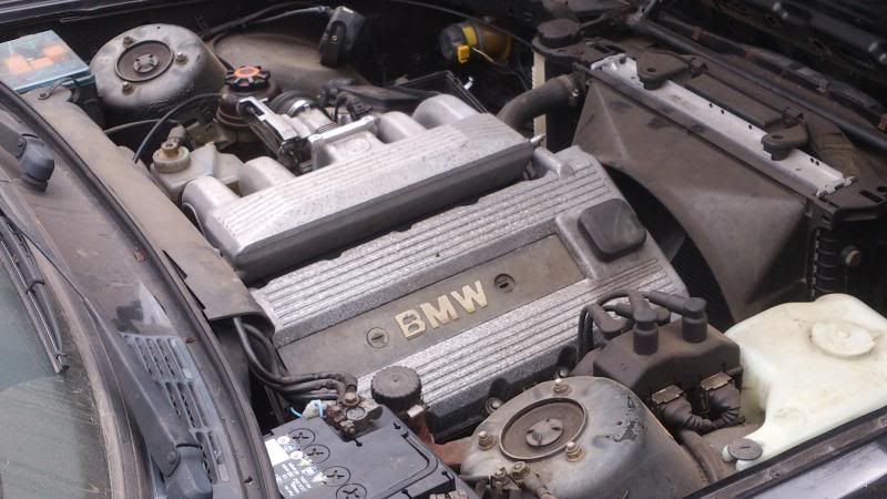

First job was to get the 318is engine out.
dough wrote: i got the old out and new sat on the mounts bank holiday monday, as you can see its very, very tight! The engine is an M30 3.5, with around 220BHP as stock, good basis for turboing, as BMW used to race these turboed back in the day!

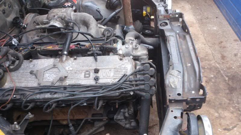

Had to ahem reshape the slam panel slightly to allow the motor to fit, its very tight and i was working alone, i will redress this at weekend when i refit the bonnet

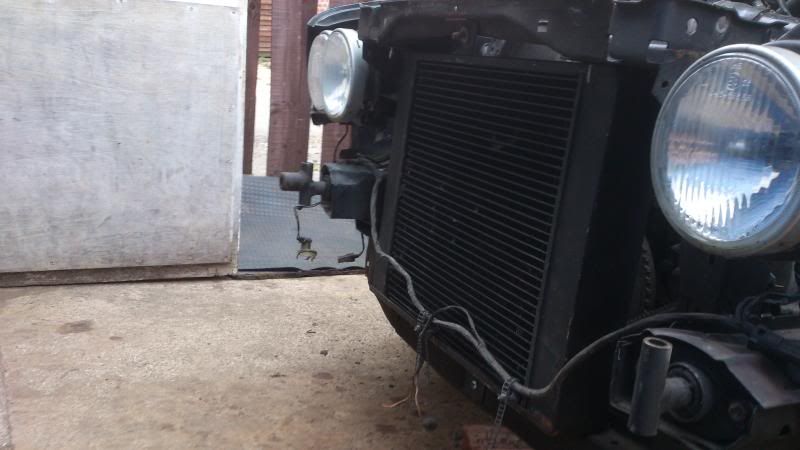

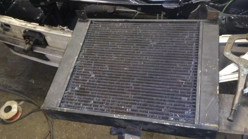

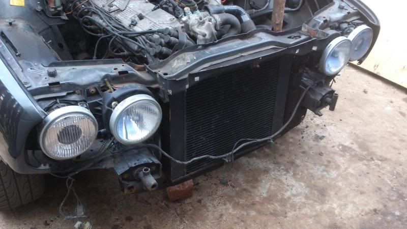

here the rad is fitted, its a deep narrow rad (alpina derived), and is again a very tight fit!, had to remove the existing fan to get it in, and dress the seams back with a hammer, also the car had been towed by the front crossmember, so had to reshape it into line and dress the seams (sledge hammer job!) As you can see, i had to remove all the bumpre, spoiler and front panel to fit the rad, fan etc

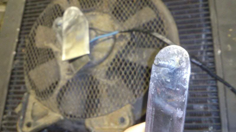

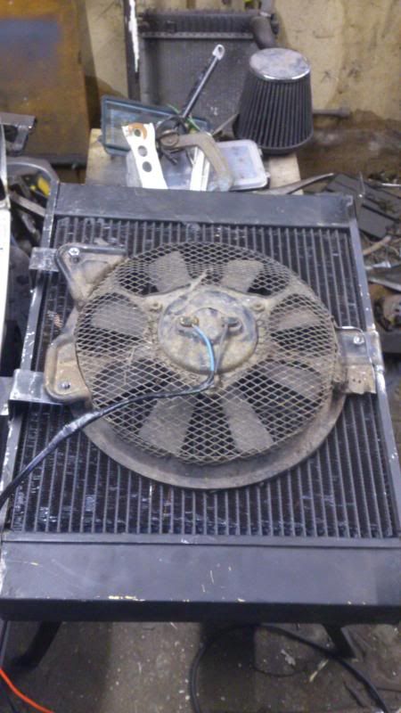

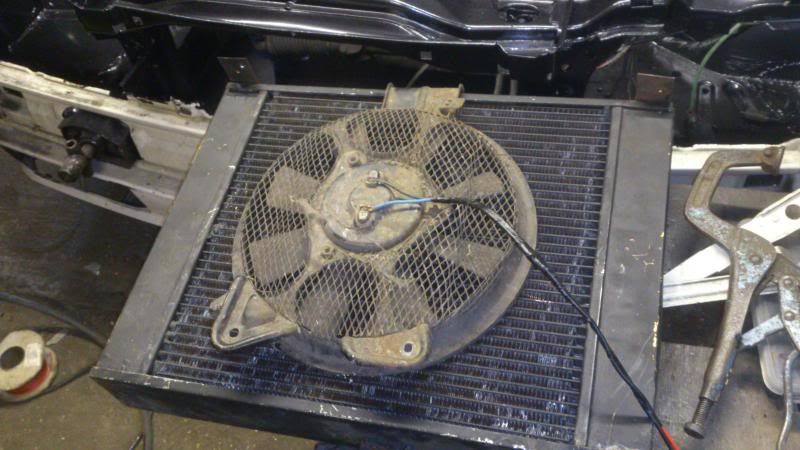

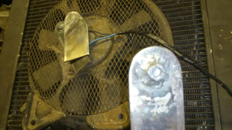

tonight i decided to fit a fan in front of the rad for joel, to make some space and tidy the bay, its from a pajero, i extended the wires and made some mountings thus
rad
fan position

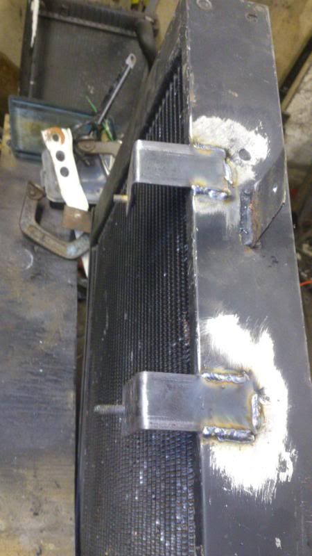

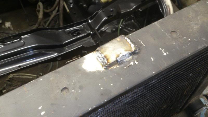

brackets, using captive fixings, 2mm plate steel
brackets bent and welded on
and fan in place, done this way so the fan can be rempoved without disturbing the rad if necessary and to save valuable space and weight!

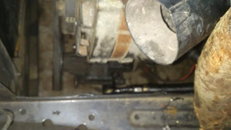

refitted, belted and piped the powersteering pump. Needed to nick a pipe from my car, as the pipes on the 4cyl cars come out at odd angles that wont reach

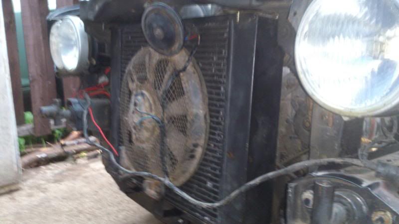

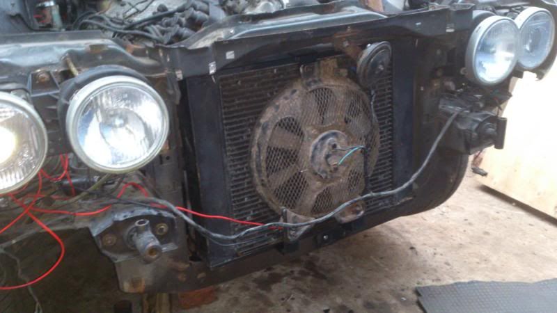

Final fitted the rad, fan and wiring, horn relocated, but i may move it elsewhere as i dont like it obscuring the top of the rad where it needs the most cool air, 6 cyl e30s usually have twin horns under the wheelarches, so may move it there, but will move easily if there is a problem

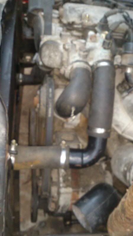

And finally made ad fitted all the rad hoses, the elbow was supplied wit the car and has a tee piece that goes to the heater

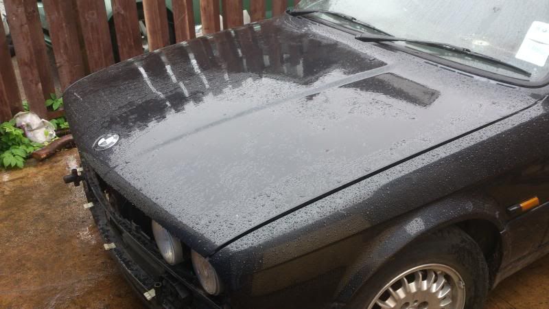

refitted the bonnet, and it actually closes!

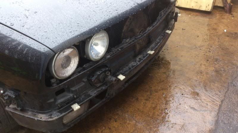

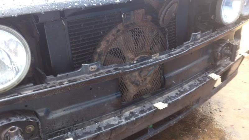

refitted the front panel, including a clearance hole for the new fan (will be invisible behind the bumper)

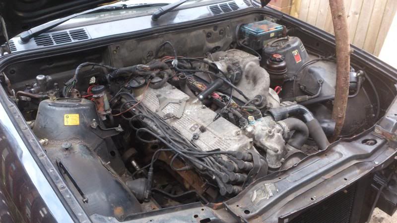

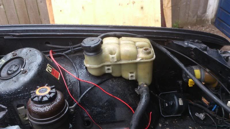

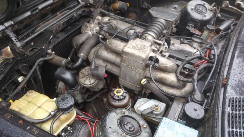

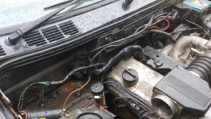

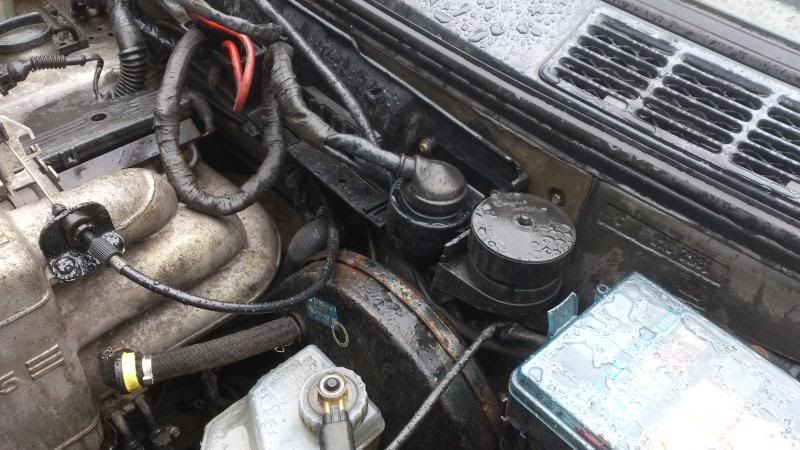

This side of the engine and bay are now complete, fuel and return pipes fitted, header tank brackets made, painted and fitted, heater hoses made and fitted, rad filled and part bled. Made a throttle cable adapter to use the stock cable, fitted the harness shielding at the bulkhead top, and reharnessed the wiring, which is now all in place, just needs tywrapping into place
red wires in the above pic are power and switch feed to the fan relay that i tucked out of sight behind the front panel, they will be harnessed into the main loom once routed and trimmed to length

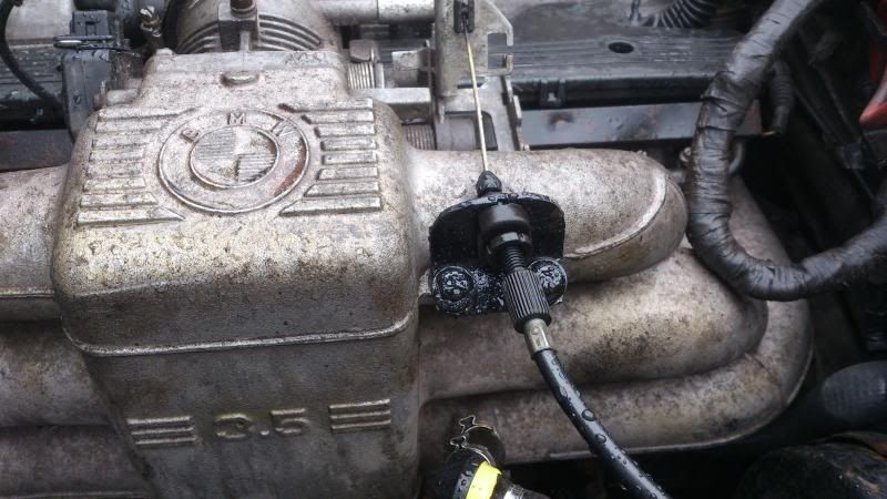

throttle cable bracket
header tank

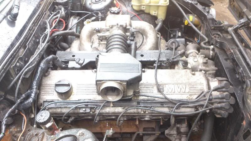

maf fitted and wiring covers all done
wiring routed, relays nowmounted in the car out of sight

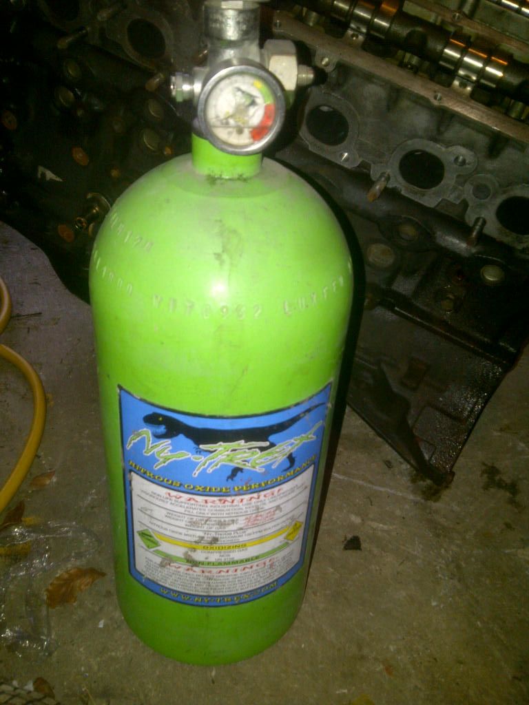

What nos set up are you planning for it ?
M30 Tech 1 Touring on gas.

zaust wrote:What nos set up are you planning for it ?
I got a kit off a mate who does some Pro level drifting. Doug tells me it's a good kit and he'll hook it up in half a day once I'm happy the engines solid etc.. I think he said it has 3 jets? Like I said I'm not a spanner man. I just know it's got a 24lb bottle!

Can't wait to see this.! How big is the NOS shot going to be?

Got to get her running yet, take her up the dragstrip see what sort of times she'll do, then once I'm happy nothings gonna go pop we'll start thinking about the nitrous :)

3 jets will be a 2 stage. Nitrous doesn't pop things miss use and a bad set up do. Just keep an eye on the plugs. Keep us posted on the progress.

^^^ I know :D. But a 24lb bottle! I run a 11lb bottle in the touring don't know how your gona mount that correctly.

zaust wrote:^^^ I know :D. But a 24lb bottle! I run a 11lb bottle in the touring don't know how your gona mount that correctly.
Dougs the man when it comes to nitrous. He's got a V8 mk1 Capri running NOS and a 325i which he's putting NOS in. He'll suss it ;)

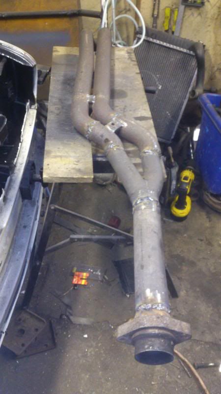

right, short update as the two vids upload

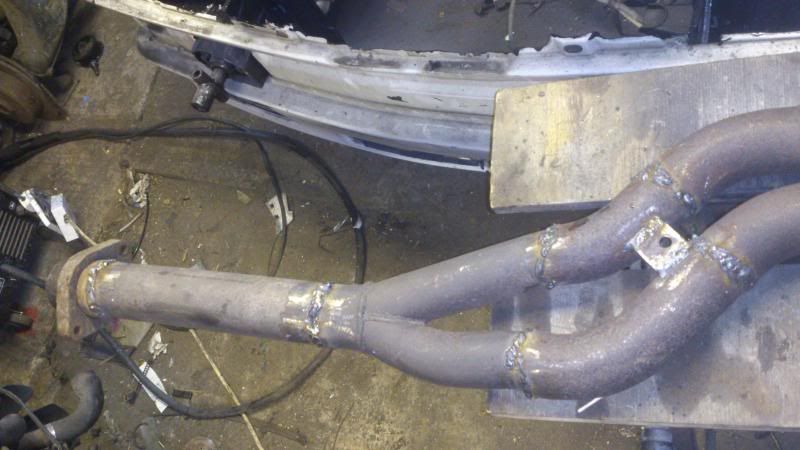

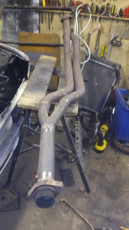

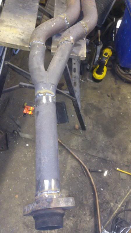

first the pics are of the new modded downpipes, excuse my scabby welding, the pipes were reasonably thin so took some welding!
I have used the old Y piece out of the 318IS downpipe, used this to siamese the pipes, and of course, cut and shut the pipes to centre them, please note the strengtheners between the pipes were to stop them moving when i cut them up!
the flange on the rear, mates to the scorpion backbox
will upload the you tube links once the vids have uploaded, when i do, the blowing at the front is due to no gaskets being fitted between the head and manifolds, as joel hadnt dropped those off yet! (has now!)
will be all done by next weekend
cheers :D

dough wrote:first vid, ten scott mills points for spotting why its hunting profusely!
I'm guessing because you didn't have the idle control valve fitted, and there appears to be a leak in the exhaust.
Ten points, yes exhaust manifold gaskets arent fitted yet, those and the prop, few odds n ends and its done
