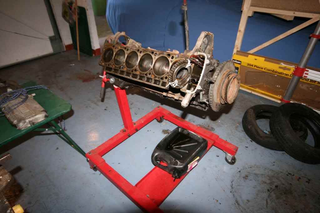

few pics:
the turd:
the lump:
now in bits
box of stuff for blasting and powercoating
lifting the head off
looks ok
need another one of these then
taking the cam out was a bit of a bitch of a job
[IMG]http://i1181.photobucket.com/albums/x43 ... G_1905.jpg[/IMG
ok so next thing is get the head sorted, remove all the rocker arms, springs and valves, send the head off to be pressure tested and skimmed. i'll clean up all the valves and re-lap them in when the head gets back. Shrick cam to be fitted. :D
Anyone know if a 1mm skim and a shrick 284-deg cam will still keep sufficient piston/valve clearance...?? I'll better do some maths to check also !!
Need to get a whole load of stuff also including engine service items and additional kit to fit the lump.
wish me luck, am going to need it !!!

little update, managed to find a replacement head thanks to a well known M30 Guru zoner on here (winx) sent it off to Corry's and got home from work today, looks like Christmas come early, this was in the garage:
reconditioned cylinder head. Replacement rockers, exhaust valve guides, oil seals, skimmed 0.5mm, valves lapped in and pressure tested and best bit.....a Shrick 284/280 cam fitted. All looks nice and a good job done at not a bad price also really
Quite pleased with that. Next up is continue to clean up and paint all the bits and bobs. Really need to get that crank nut off so i can replace the chain guides as one is cracked.

yer, can't compain at all. Really need to get that crank nut off now, then i can strip down the rest of the block. I've got 3 boxes of stuff now:
Box 1 - Blast and powercoat black
Box 2 - Blast and powercoat silver
Box 3 - Blast only and will get the TB media blasted with soda if i can
Spent ages looking at peoples M30 conversions mostly on here to see what the best looking colours are for the various bits. Lee - your's looks great so i'll probably do something very similar to yours if you don't mind!!!
Then i suppose i'll be robbed by the stealer for a box of gaskets and seals, might have to wait until after xmas for that :D :D
