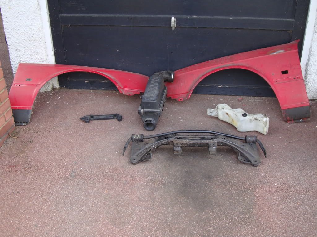

i also forgot to mention that i went and done a bit of shopping the other day at my local E30 parts place -->"E30partz.co.uk" and picked these up :
--2 Good wings
--A 325i front cross member
--An E34 washer bottle
--An E34 airbox
--A Radiator bracket as mine was held on my cable ties
--2 Good wings
--An E34 airbox
