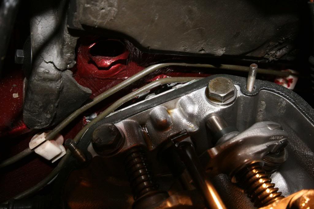

BUMMER!
I've got an oil leak and it looks like its coming from the back of the head
looks like gasket part number 11 here is leaking and quite a bit unfortunately
I got it on the ramps today and had a good look with a decent torch and I could see where the oil is coming from
looks like the gasket is damaged and I guess I over tightened the plate when fitting :(

Delete all that, there was oil bubbling up out the oil pressure switch, the actual inside part where the electrical connection is.
Should I be worried, other than changing the switch?

Clean your injector that sits right below.
The same failing sensor killed mine as it was soaked in oil
johnl320
Posts: 3124
Post Sun Aug 25, 2013 5:31 am
jimbom30cab wrote:Delete all that, there was oil bubbling up out the oil pressure switch, the actual inside part where the electrical connection is.
No, seen a couple start to do that, just get a new one

And the new oil pressure switch has cured that leak also.

Here is a few pics
M20 injector connector housing, with loom removed
test fitting the M20 injector loom
here you can see the TPS and AFM connectors, the ICV is plugged in also.
new small alternator connector made up
here you can see how I positioned the fuel rail loom large circle connector
more details to follow
