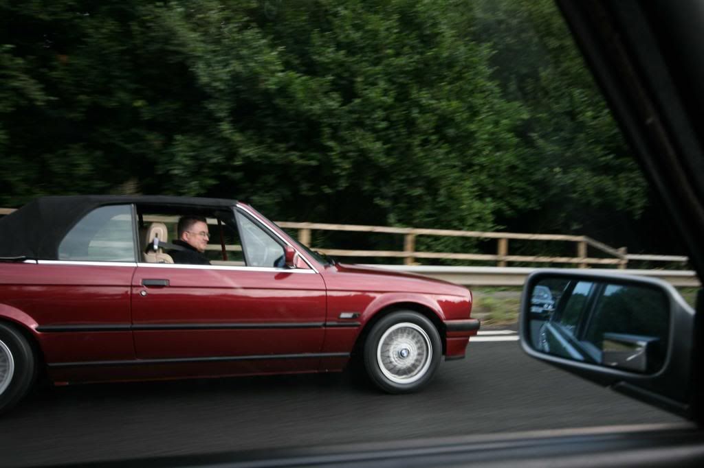

:P
jimbom30cab
Tech 1 freak
Posts: 7634
Location: in the garage
Post Sat Jun 29, 2013 9:48 pm
Hey Chris, yup its now gone huuuuuuuuuuuuuurrrrrrrrraaaaaaaaaaayyyyyyyyyy
Love the pic Phil, I am looking a bit fed up with it there to be honest
