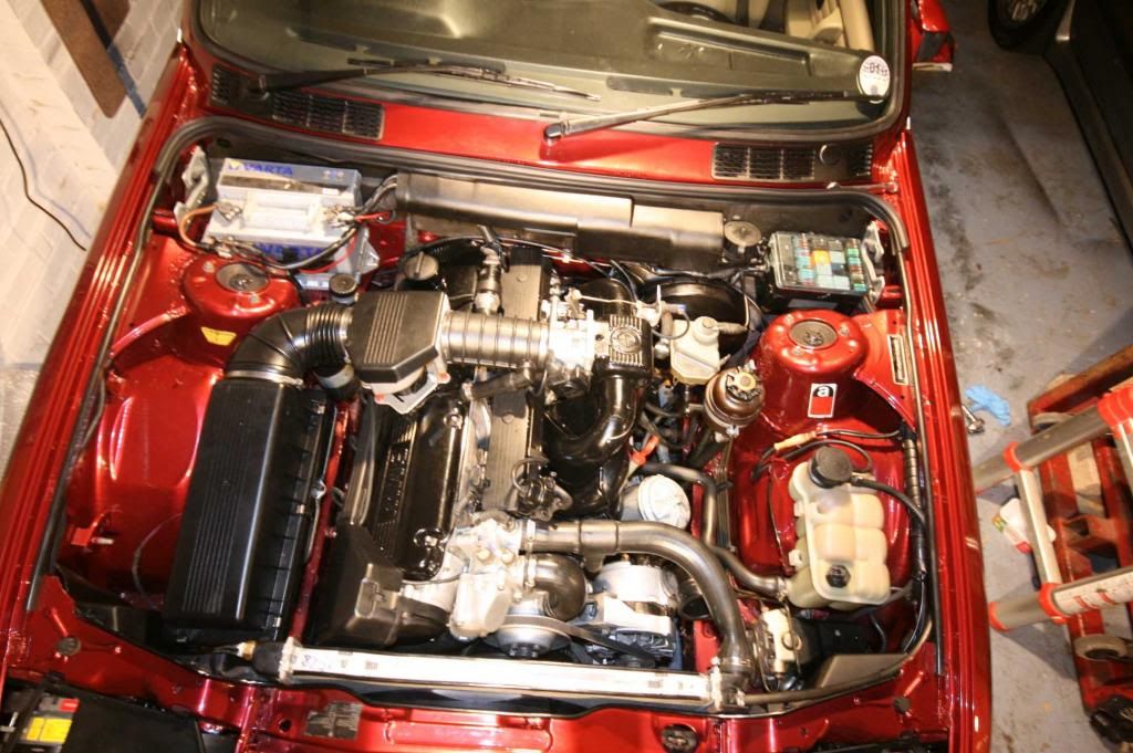

M30 install into calypso cab. Back on the road :)

Today is a good day
The old turd is all back together and the gear selection all works perfect. The short shift from the Z3 feels nice.
I'm in serious poo with her in doors for the unexpected £££ spent though
So bits left to do:
Ecu wiring tidy up and bulkhead grommet
Final torque on the cylinder head bolts
test the electric fan cuts in when it should
Fit bonnet
Coolant might need longer upper rad pipe
Give it a run and hopefully this might sort out the high idle
Change suspension springs and shocks - do you think a set of 325i boge turbos should be ok?
Sort out oil pressure light which is stuck on at half brightness
change clocks to 6 pot clocks
then we're good for the MOT

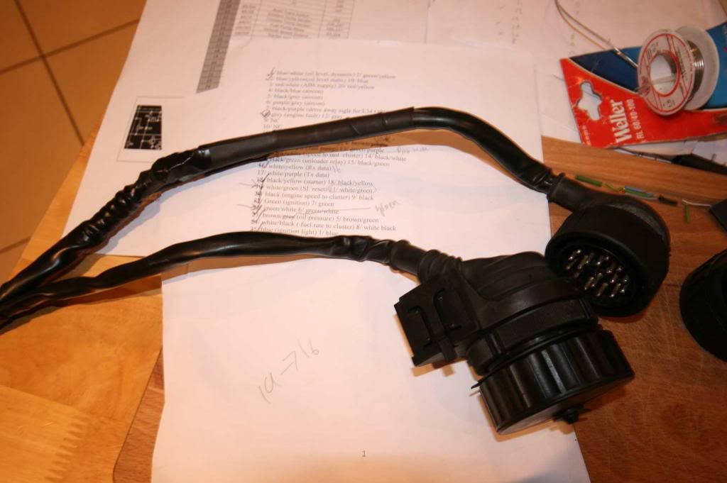

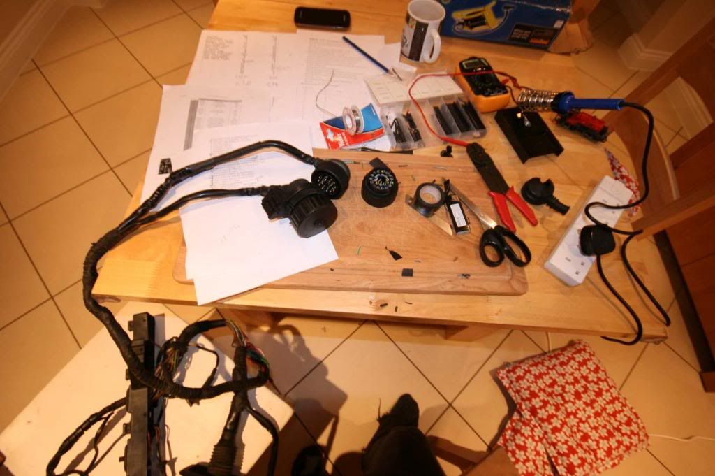

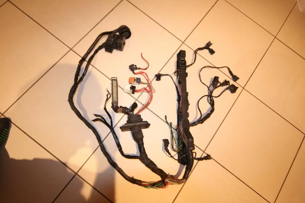

Quick update, been really busy with it all actually but still fixing snags.
Spent ages and ages trying to sort out the oil pressure light problems. Even with a new working switch, the previous 3 were no good, the oil pressure light is still on
A few zone legends had a look at it over the weekend and said it sounded ok but I was still having this nagging doubt that I might have genuine oil pressure problems.
So I took the oil pressure switch out, put a few rags around the hole in the cylinder head and with the torch ready I flashed her up.
OMG this full bore oil pressure snake went over the car and hit the garage shelves about 4 foot away, must have been about a pint every 3 seconds, foooooook, so I ran round and switched it off quick. Don't think there is any oil pressure problems with this then.
So, I'm still getting 0volts when running on the the oil pressure switch supply and as my m30 loom is looking really mullered now, I'm going to swap it for another factory fresh one.
The spare has the x25 plug so I've done some research and worked out the pin swap exercise for the x20 plug , I'll do this this week.
I hope this will restore the electrical gremlins I have. It should do as the body loom has not been touched.
Also, I fitted new boge turbo shocks all round and changed the springs to 325i standard springs.
So it's literally, new engine loom and then finishing off jobs left to do now like fit the bonnet and add the PS fluid etc etc

New loom in
Engine runs
Oil light out
GET IN THERE

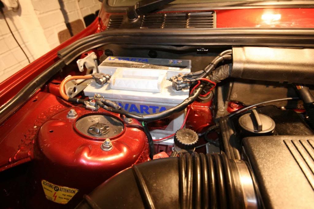

Big thank you to everyone who helped me with sorting out these little problems, thanks very very much

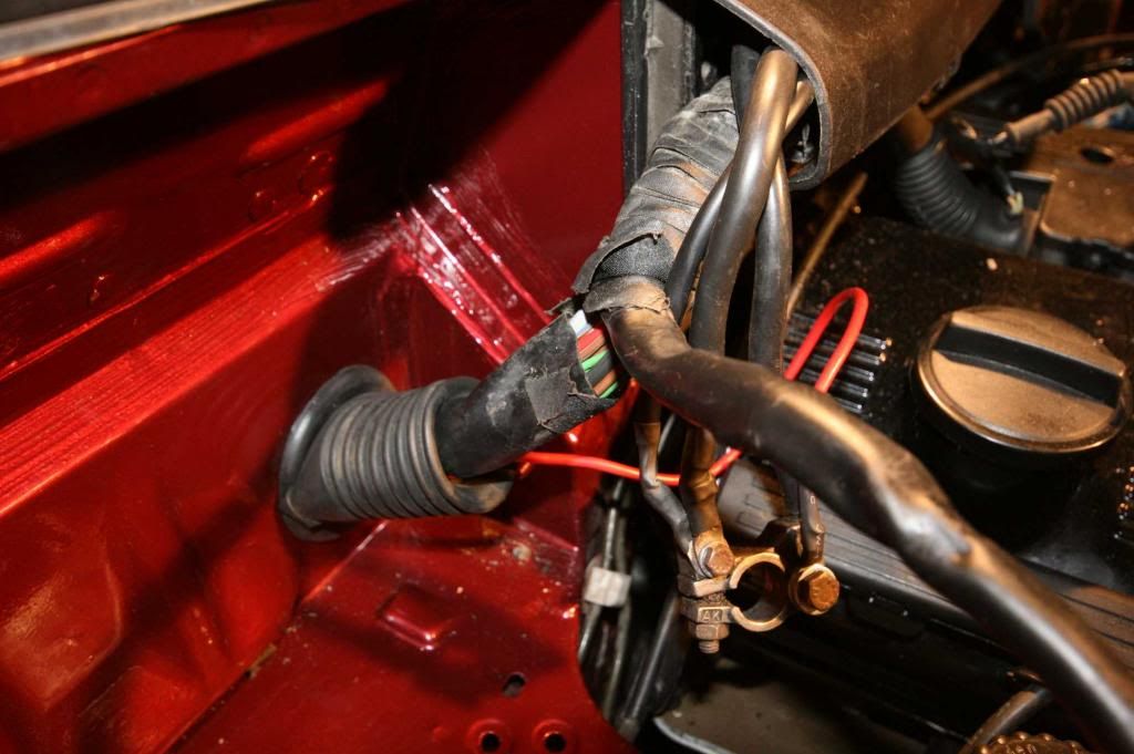

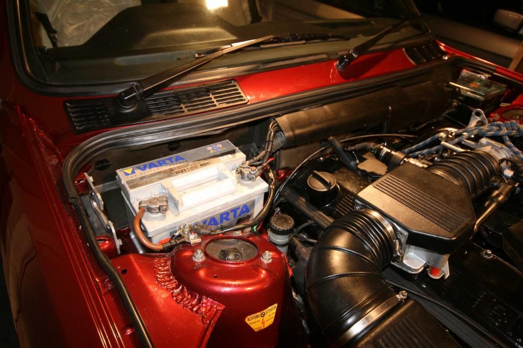

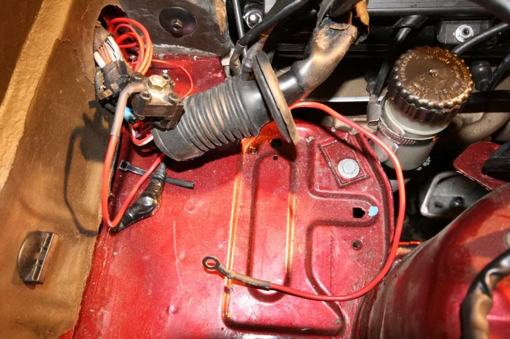

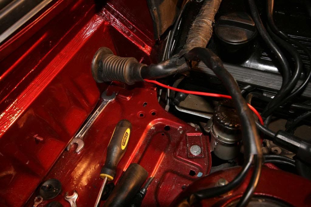

so this eve I tidied up the wiring:
In the below pic I decided to extend the red live wire that goes from the relays to the battery +ve terminal. This way I can pop all the relays and wiring in the cabin under the dash.
That was the only mod to the wiring loom, the bulkhead gasket is from e bay.
And finished off
And finished off

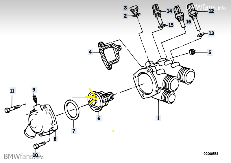

zaust
- Zone day release
- Posts: 13007
- Location: Somewhere in Hertfordshire , or press Ctrl + W
when you look at the thermostat there is a small arrow stamped on it to show which way up it goes. Drill the 3mm hole through the arrow.
Personally i'd look for the flow problem rather than masking it. If the bottom of the rad is not getting hot then thats the first place to look. new rads can swell inside and stop flow.
Stellar work on the loom Jim, perseverance will get you everywhere.!
Sounds like your thermostat is stuck shut, test it in boiling water. New cheap thermostats (not saying yours is) have been known to fail within a very short amount of time. You got the old one laying about still to eliminate the new one as failed?

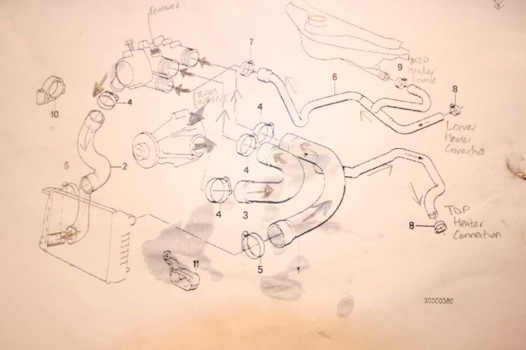

Yer I'll change the stat and see If its better
It does seem like a flow problem though so I might run the engine with the stat removed and check everything has an even ish temp.
At the mo, the bottom of the rad is stone cold and the upper pipework very hot. I only ran it for a short time.

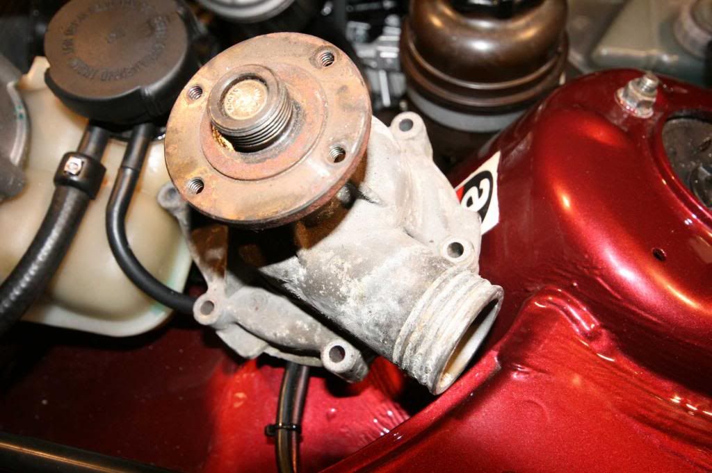

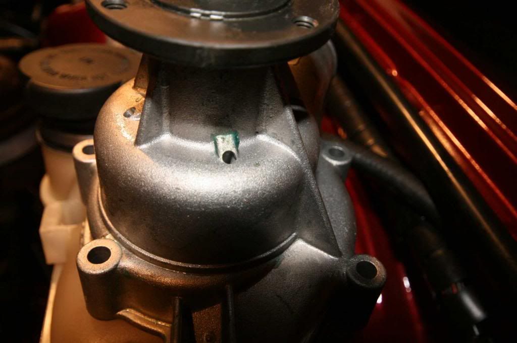

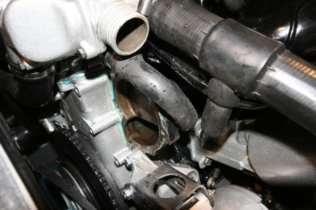

yes mate, just got back inside
I dug out the old stat which I knew worked and tested it in boiling water, opened perfectly so I fitted that one
then tried to bleed the system and noticed when I removed one of the sensors which are straight after the pump there was no flow coming out. see below where - top left where I have written "removed"
so had a chat with the M30 God and to us both it seemed like there was no flow. It really did seem this was the case as I could remove stuff and get no coolant leak out.

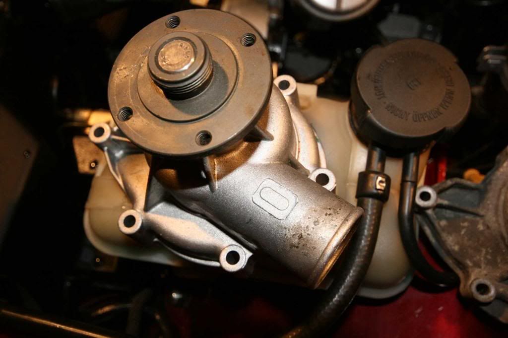

So I took off the pump, nice easy job actually, not the nightmare I was thinking it would be.
This one was brand new in the box from a Zoner.
I also found the one which was on the engine when I got it.
whilst the pump was off I got the garden hose out and flushed through the block and rad and got a good flow out, certainly no blockages.
So the pump that came off looks perfect, span lovely, nothing loose, all perfect.........then I noticed a couple of holes in the top which the original BMW pump doesn't have. They don't seem to be connected to the pump bowl though which was my initial thought but as the passage way is all hidden inside its hard to be sure, I ran water through and it looked ok
can you see the 2 holes in it
I really thought this could be it, but I doubt it.
so back to square one really which is put it all back together and bleed again.
i'll use the tested stat and pump that came with the car, I know they both work.
then bleed, bleed, bleed
in theory it should all then work fine
i'm just a bit nervous about overheating the engine

D=20,64mm means the cylinder diameter is 20,64mm.
The good news is that the cylinder you need on a E28 gearbox is the same one as used on e21's, e30's, e12's, e24's, Z1 so it can be sourced quite easily.
The bad news is E34 is not in that list indeed, so you'll prolly have an embarrassing moment at the garage...
Really sorry you have these problems bleeding your system.
As far as I can remember bleeding mine felt like a 10 minute job.
Only things I made sure of:
- set heater core controls to full heat
- make sure all your hoses will flow, including the overflow tube from your radiator
- remove the bleed screw on top of your thermostat housing
- hold the expansion tank as high as the connecting hose will allow you (disconnect the overflow tube from your expansion tank if this gives you more room)
- fill expansion tank until coolant comes out of your thermostat housing without bubbles
- fit bleedscrew in thermostat housing
- lower expansion tank and attach overflow tube from radiator
- start engine; and wait until thermostat opens. You can't miss the moment, as the coolant level will drop in your expansion tank
- keep adding coolant until the overflow tube spits steadily
- put cap on coolant bottle (the system will start building pressure now)
- check a few times if opening the bleed screw doesn't give you any more air bubbles
that should be it

Thanks Walinsky, I'll fit the water pump back on and do exactly your procedure this a afternoon
Hope it works
Thanks
Hope it works
Thanks
jimbom30cab
- Tech 1 freak
- Posts: 7634
- Location: in the garage
So I fitted the old pump back on, I know this is ok, topped up the system and bleed it as best I couple using all the tricks. Seemed to go ok but have a little leak where the thermostat housing bolts on.
The coolant is flowing round fine and with the stat out the rad gets hot all round. I does get very hot very quick though, are these m30 engines really hot?
Thought I better test the electric fan, worked perfect and the switch in the kettle boiling worked perfect also.
Unfortunately I had th fan switch connections bridged so I could keep the fan on whilst bleeding. Then I turned the engine on and the fan stopped. Bridging the connections doesn't work, the relay doesn't click and the fuse is not blown. I changed the fuse and relay just incase and tested the fan worked with a 12v supply, all is fine.
So I'm not sure if this the case why that would happen.
I can only think that starting the engine burnt through the wires maybe? Odd that the fuse was ok, it was a 15a fuse.
So zero steps forward and one step back today.
I'm seriously thinking if jacking it in to be honest.
Also, there still is no indication working on the right side of the dash, the temperature dial never moves past cold.
I think I'm getting out my depth now and am just not sure how to get this finished off.
