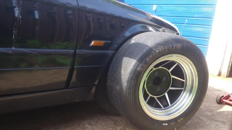

These are the shoes I've got for it:

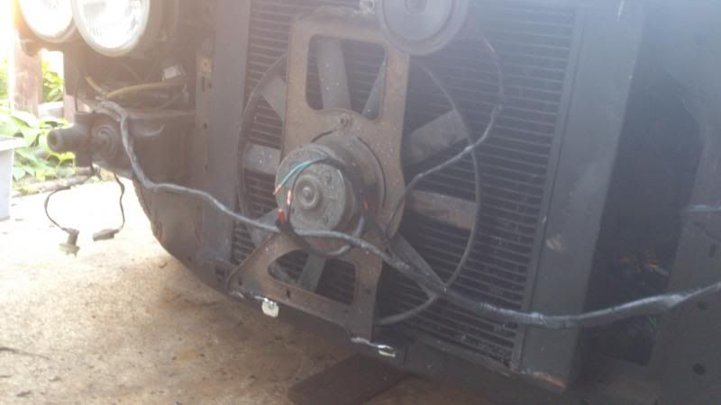

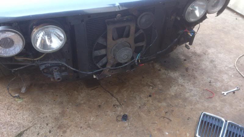

The fan i fitted decided to work for a few minutes, then seized up solid, so most of the afternoon and evening involved sourcing a replacement, and grafting it to fit into the mods id made previously!
so the motor now has a larger fan (that works!)
I then refitted the front of the car, again, inc bumper (modded slightly to clear the fan) and front spoiler/airdam affair! you can just see where i trimmed the bumper beneath the grill, assume thats OK joel?!

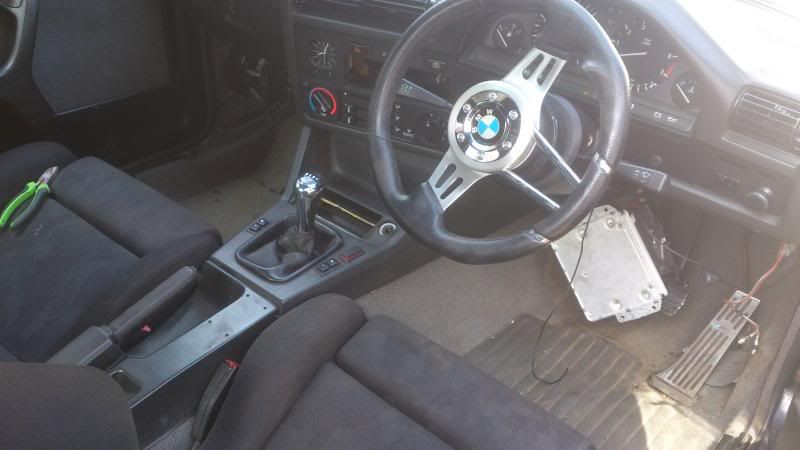

The interior now has the shift knob in place, gaitor, and i have rejigged the power windows so the switch that was the lockout is now the fan switch (stealthtastic!)
I also bled the water system, which was traumatic as the thermostat was stuck shut, and the bleed screw was blocked, so i bled the system through the housing and blanking plug, worked just fine in the end

Bummer about the fan.
Do you not have a thermostatically controlled operation, or just the manual switch?

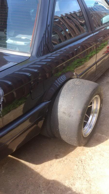

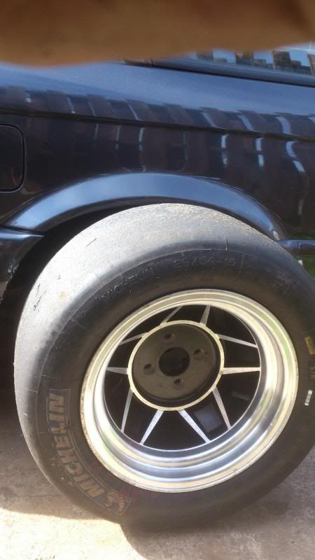

Tasty set of wheels and racing slicks - what were they used on?
dough
- Posts: 86
- Joined: Sat Aug 04, 2012 11:00 pm
Brand new ats classics in 10x15 for my capri actially!
No fan stat yet, going to fit one at a later date

I'd highly recommend fitting a fan stat ASAP, they are only about 12 quid, you'd be surprised how easy it is forgetting to put your fan on.! The m30 donk will overheat in minutes.

Those rims are Badass.

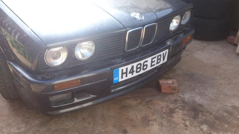

Errr ..... front valence fell off on the trip home! Went over a speed bump and it fell under the car and got dragged a few feet, so that now needs a shedload of paint lol.zaust wrote:Have you got the upper cut out on the valence to allow somme extra air and I found a slight bonnet lift did wonders.
Having said that the temp seemed a lot more manageable in my afternoon hooning once that had come off.
