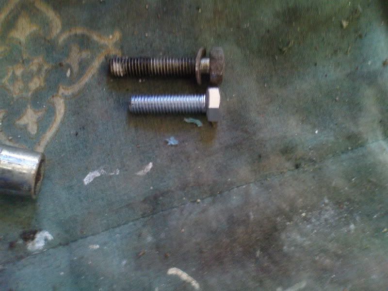

this is the problem i was having with the mount nuts being too long, so got some new smaller ones made from a local machining shop:

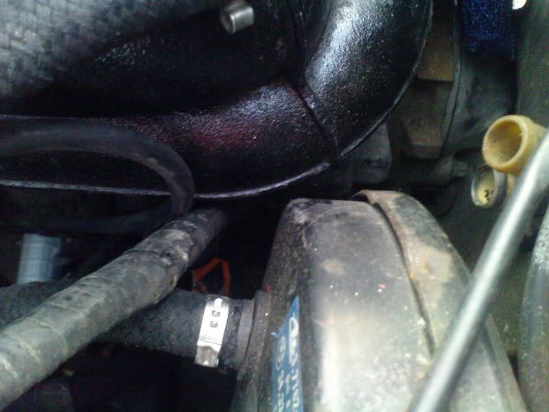

im using lee's mounts and this is how far away from the brake servo i am in position 2, should just be enough room for swinging
leeparkes
Posts: 9538
Location: Black country
Post Wed Jun 30, 2010 12:08 am
plenty room :D
