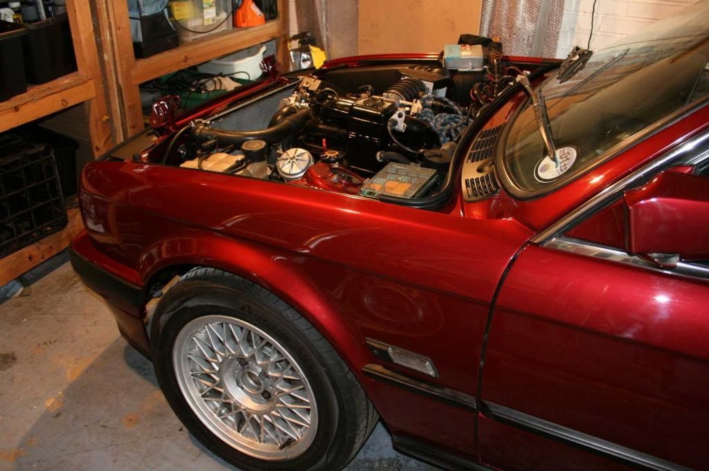

Ok so I bleed the clutch properly and the gearshift is just not right at all
In my m20 with the clutch pressed I can select all gears fine
In the m30 with the clutch pressed I can not get 3rd or 4th at all. I'm not happy with this as this was the problem with the box originally so i took it into a specialist and had it fixed for the sum of £120 notes.
Actually even 1st, 2nd and 5th is a bit notchy.
I have the 325i sletor arm with all new bushes and a z3 shifter.
Do you think I'm looking at a gearbox change? Feeling like it to me.
Luckily I have a spare getrag 260 which I know is a good box
What a pain
What a pain

What box is it, E34 or E28?
leeparkes
- Posts: 9535
- Location: Black country
That gearbox is a duff, if you can get 1st, 2nd and 5th then it can be nothing else but a problem inside the box
Id pull the engine back out to change it too, Trust me!
- E30 Zone Meets/Events Team
- Posts: 27978
- Location: Mad mad mad
No need to pull the engine if Jim left the 2 top Gbox bolts off.
Undo the engine moun,ts lose, don't remove the nuts, undo the g/box mounts, prop, and tilt the lot down.
I've taken my g/box off twice in the cab this way this way.

I was thinking if doing it that way Rav to be honest I might give it a go but am tempted to take the lot out as I wanted to tidy up the bulkhead where I scratched it a bit last time I put the lump in.
It should be quicker now I know what goes where.
Great fun hey !!
It does have a little running issue. If I close the throttle when running the revs blip up a little after the throttle has closed. The throttle plate definitely closes perfect first time but then there is a little blip of revs after it has shut. Could this be the ecu needs to learn a new map? Or could it be the ICV as it opens, it's opening a little too much. The TPS is set perfectly.
Great fun hey !!
