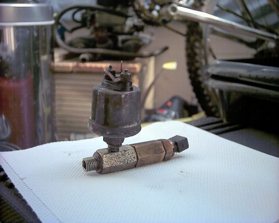

Just lots of silly jobs really! Fitting some Audi aux gauges for example (i really needed some idea of oil temp/press!), which meant moving the megasquirt and its relays etc away from the centre console to the under dash area, which was a bit of a pain. also still messing about with these 750i brakes, haven't got mount brackets made for the calipers yet so I've just been tidying them up. to be honest it's put of MOT now anyway so i might as well get all these bits done before I take it for one, while the weather holds up. No garage :(

I'd be very interested to hear what bits you used to rig up the oil pressure guage Toby, definitely something I want to do.

haven't done too much rigging up yet unfortunately Theo, not had the most productive of days!
Audi gauges from a quattro or something
Audi oil temp/press sensors
total cost £26 8)
and then make up something like this (pic courtesy of Buster) :cool:

Cheers for putting those pics up, I've also got some Audi guages, but not with the right pressure sender or the wiring like yours do, probably worth getting another complete set from a scrappers in my case. I've got a radio blanking plate and three 52mm guages fit in there perfectly, but thats the easy bit! That adapter that Buster has used looks similar to the one in the link below, is it the right thread?
http://cgi.ebay.co.uk/BMW-E30-E36-320-3 ... otohosting

Theo that is the same as an m20 thread, but unsure of an m30. In fact for £10 that would save a lot of buggering about I can assure you! Realoem should tell you the thread and pitch of an m30 I think.

Good shout, just checked - it's the right thread, result. So I just need a pressure sender with the right thread and the wiring, and I'm laughing!
Toby, where are you going to locate the oil temp sensor?
