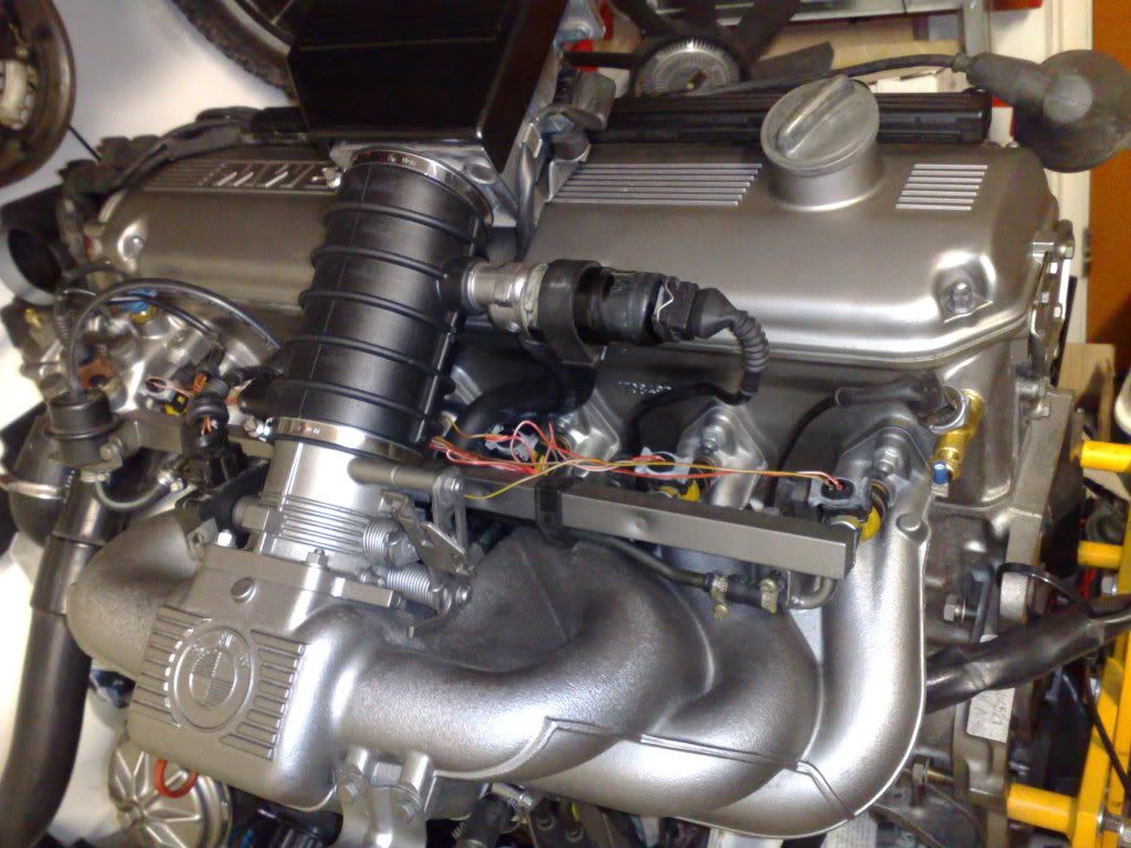

I used a t piece to take a feed from the oil pressure switch at the back of the head (on the right hand side when looking from the front of the car) for oil pressure. Temperature I took from the oil filter housing, but that has been swapped to one from an e28 so I can have an oil cooler.

You can see the sensor in this pic, at the back of the head just above number 6 inlet port.
