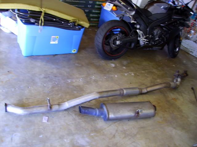

hi all just wanna know what size tube i should use
and what size box i was going to use my old cherry bombs
but not to sure yet can you help
