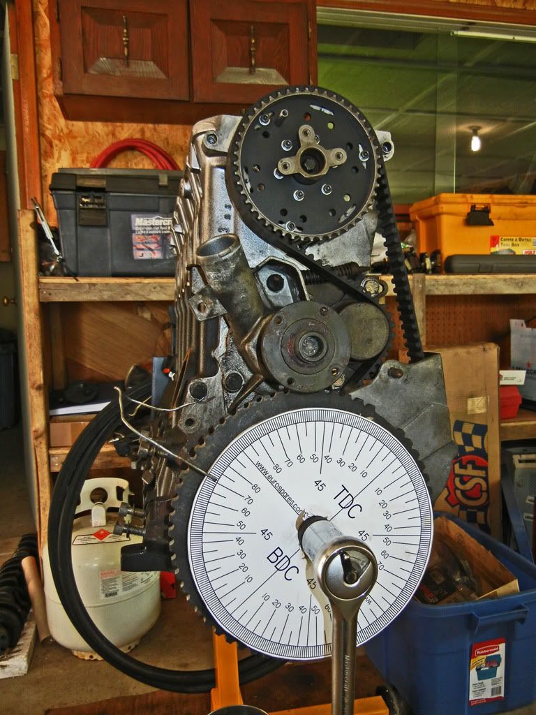

I made one for my 2.8L M20 last year. If you know a shop that can laser cut you some 3/16" plate you can make your own fairly cheaply using the stock pulley.
The idea behind the spacing on the holes on either side of the spoke was for setting the timing by simply sticking a dowel pin in the hole and rotating until it contacts the spoke. As you can see on the top spoke the holes are touching, that's for setting back to stock timing, then each consecutive spoke the holes are spaced 1 degree further apart. So I have +/- 5 degrees of adjustment on the cam pulley and since it's 2:1 ratio to the pulley on the crank it's really +/- 10 degrees (in 2 degree increments).
I can email the CAD file to anyone who's interested.

Top job that! Dave, send it back, we have a new plan

Saw that when you posted it on another forum, thought it looked like a good job then and now its on the engine is looks even better.
Go with that kedge, at least you know your getting a well made pulley.

Well you can't really see it since I'm running the stock dizzy stillHairyScreech wrote:Saw that when you posted it on another forum, thought it looked like a good job then and now its on the engine is looks even better.
Once I finish my ITB project the next project will likely be converting my MS to wasted spark so that I can get rid of the stock dizzy and show off my timing pulley
