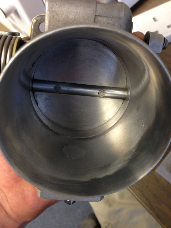

throttle body knife-edged, i wish steel was so easy to polish out!

Did some throttle body work, the idle valve has been bunged up as you can't weld it. I made a part on the lathe out off aluminium and also modded a bolt to block the other one - both flushed off internally. Also in the picture is the ali temperature sensor mount for the audi AIT sensor.
