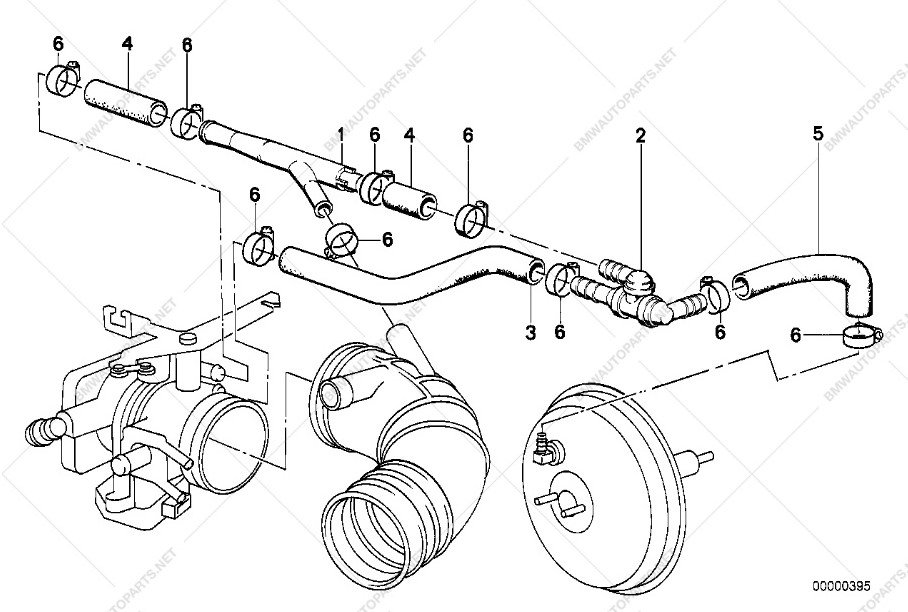

Can any one confirm the Part No. for the pipe outlined in below pic?
Car is a 1986 320i (Auto).
The pipe is torn and I want to order a replacement, but can't identify it on the REAL OEM Diagrams.
Thanks

The early 320i is a nightmare of bits of rubber hose, as you probably know, and I try not to get involved with them!
Have you entered your VIN into the ETK version you're using? Although the diagram will be the same, the list below should only show the parts fitted to your car.
The hose is ordinary straight vacuum hose (12mm?), and should be available by the metre from motor factors or ebay as an alternative.

i think it is this 34331115926. simply 12x19mm vacuum hose
