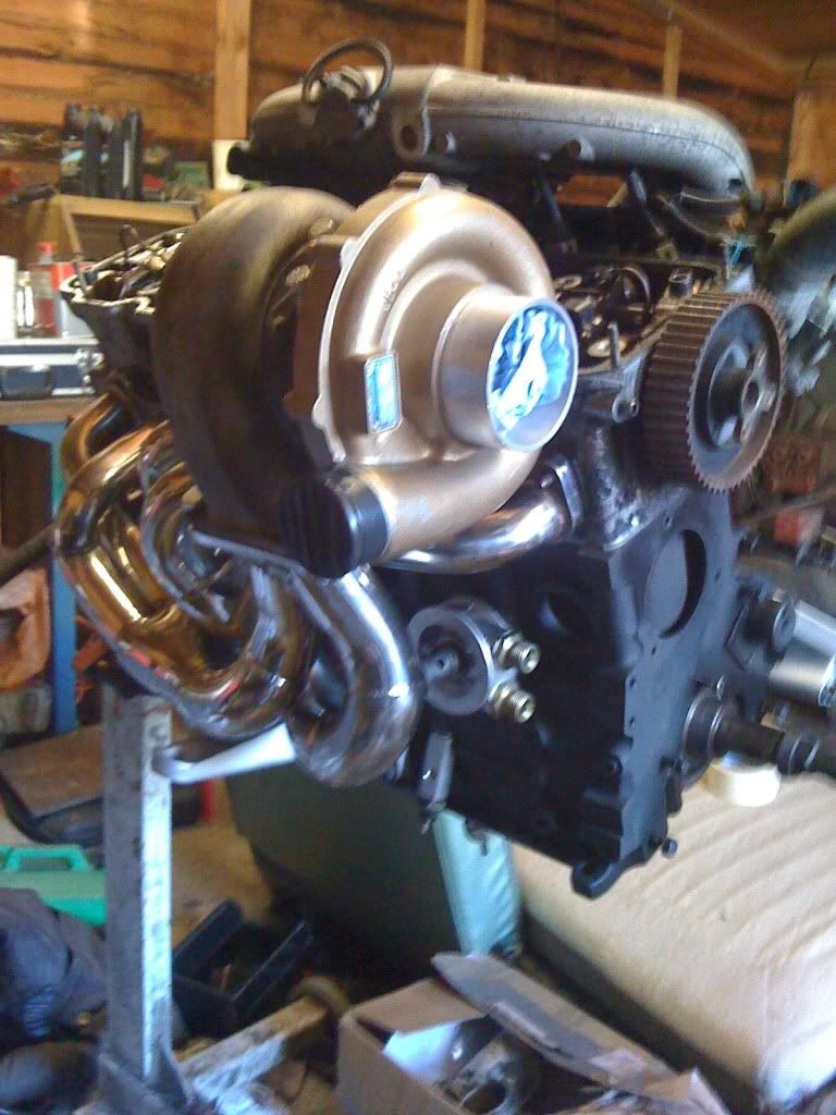

Both really half way through painting the body and half way through the engine complete fresh bottom end crank done new bearing all round new rings just gotta get a new oil pump core plugs a few more gaskets and the engine is near enough done
I would put a couple of pics up but don't know how :(

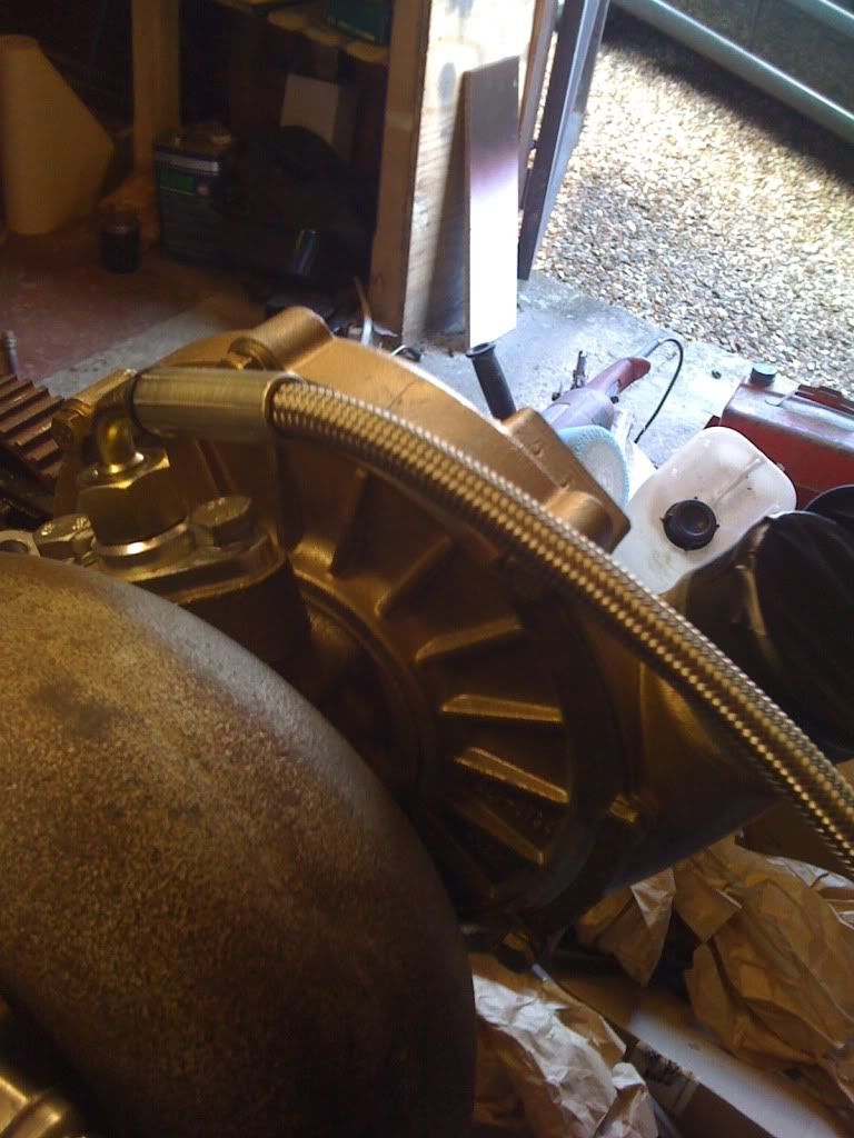

I'm tryin to do it on my phone but uploaded some pics and took the page dunno if it's right but here goes :)
http://m924.photobucket.com/albums/Ross ... giAVvvs%3D
god that's long lol

Wed Jun 02, 2010 9:25 pm
Mmmm shiny.
