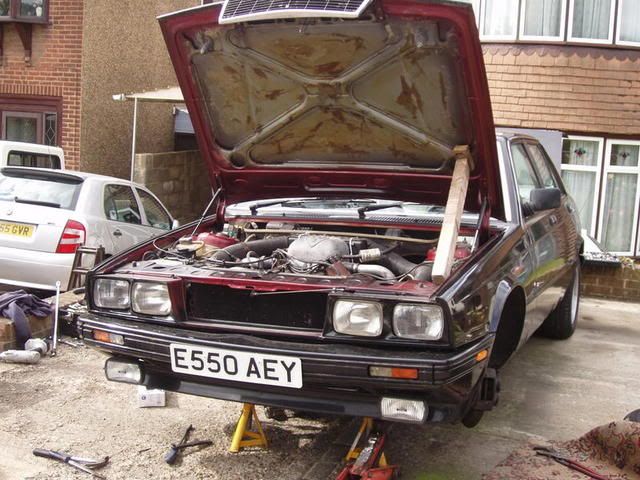

Team Maseratty started work today! :)
First thing we looked at was the front brakes which pull hard to the right.
The right hand (4 piston) caliper has one particularly poor piston that is holding the pads against the disc.
No amount of working it in and out helped much so we are going to try and re-seal it or source another caliper.
The front pads are all cracked too and coming away from the backings so new pads are on the shopping list.

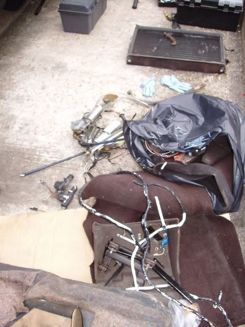

We then set about stripping what we could out of it.
This included the glove box and brackets / hinges, front fog lamps (that weren't wired to anything), air conditioning (and we didn't pollute the atmosphere - there was no gas in it anyway!), boot trim and carpet, rear central locking and electric windows, alarm and some sound proofing.
It adds up to quite some weight and maybe a few bits to sell on Ebay! :D
We also need both steering rack gaiters, some new fuel hose and a few rubber boost hoses.

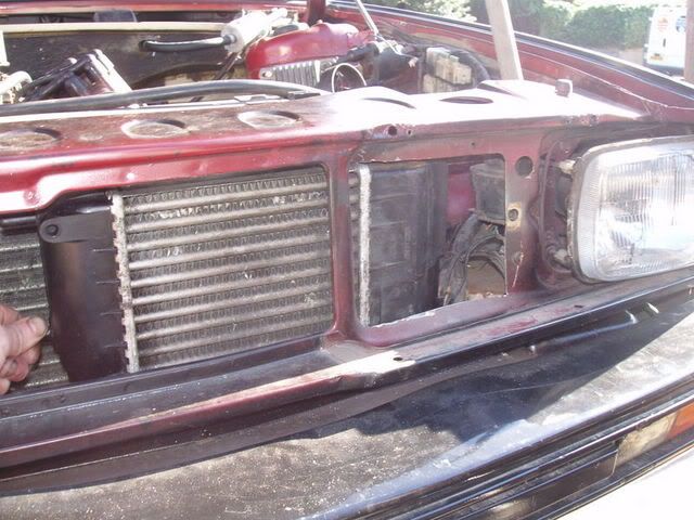

The air con condenser removal has left a nice big hole to fill with intercooling! winkeye

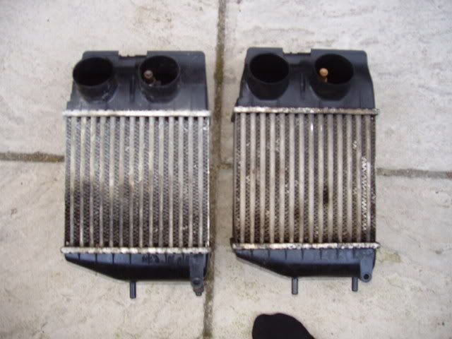

- Removed and measured boost hoses.....
...to plan fitting these! :D
A pair of intercoolers from Renault 5 GT Turbos!
Bought for £35 from a breaker!
Also awaiting the delivery of a boost valve (like a bleed valve) so we can start cranking up the power! :twisted:
It's getting there but still plenty of fettling to do! :)

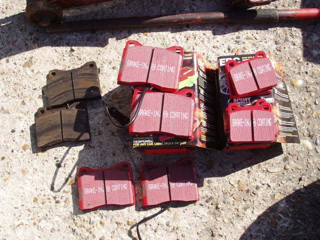

Got a few more bits done today!
More new fuel hoses, carburettor cleaned out.
Brakes bled and fitted wit new, and rather coool, brake pads! 8)
Renault 5 GT Turbo intercoolers moved into place.
Just got to sort out the plumbing for these now.

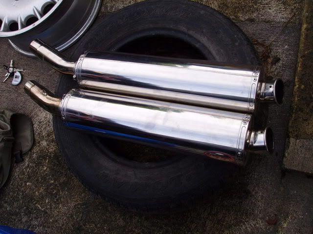

We've also won the bidding on a pair of motorbike exhaust cans with removeable baffles today. Pics coming when they are fitted, but they should look :cool:

side exit cans? winkeye
can a screamer pipe be fitted?
Posts: 14059
Sun Sep 16, 2007 10:31 pm
Looking suitably 'ratti' 8)
Sun Sep 16, 2007 10:36 pm
side exit FTW!!
DRIFTBOY
Posts: 3131
Sun Sep 16, 2007 10:45 pm
Hmmmm, side exit! ?
I like the idea, when we pick up the exhausts I'll have a measure up to see if that is feasable!
Gareth - forgive my ignorance, what is a screamer pipe?!
Sounds great whatever it is! winkeye

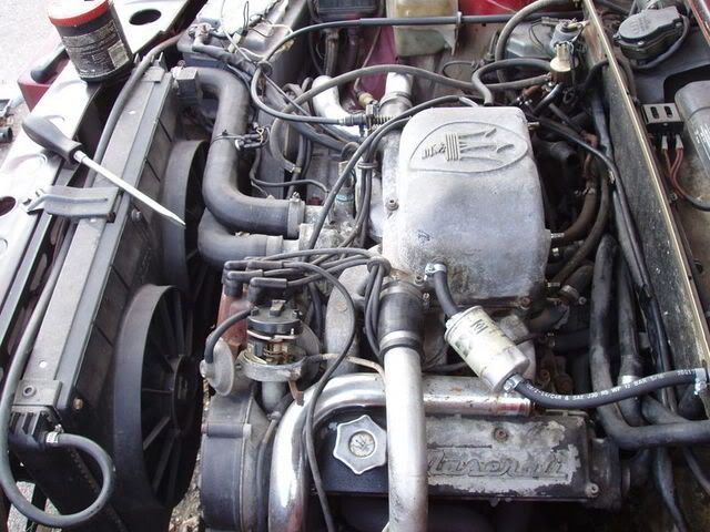

The rear brakes / handbrake have been un-seized, cleaned, adjusted and bled on one side but on the other side a broken caliper bolt is causing a bit of hassle! :(

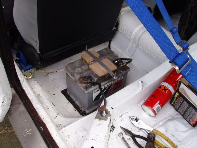

As the proposed intercooler pipes got right in the way of the battery, that has been moved to behind the passenger's seat.

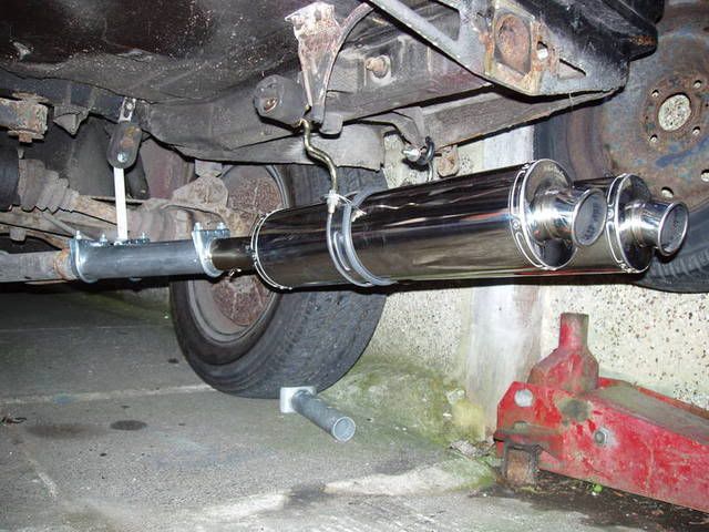

My team mate Rob found these beauties on Ebay only a few miles from home!
Yes, they are for a motorbicycle but at £81 for two stainless steel rear silencers with removeable baffles ( :D ) and convenient pipe size we, couldn't resist!
It was very straight forward to get a length of exhaust pipe to sleeve the original system to these and knock up some hangars from spare parts in the garage.
Sounds nice deep, V6 throb at idle but it hasn't been driven since fitting them so we don't really know what it will sound like yet!
