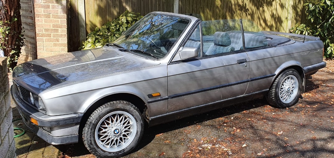

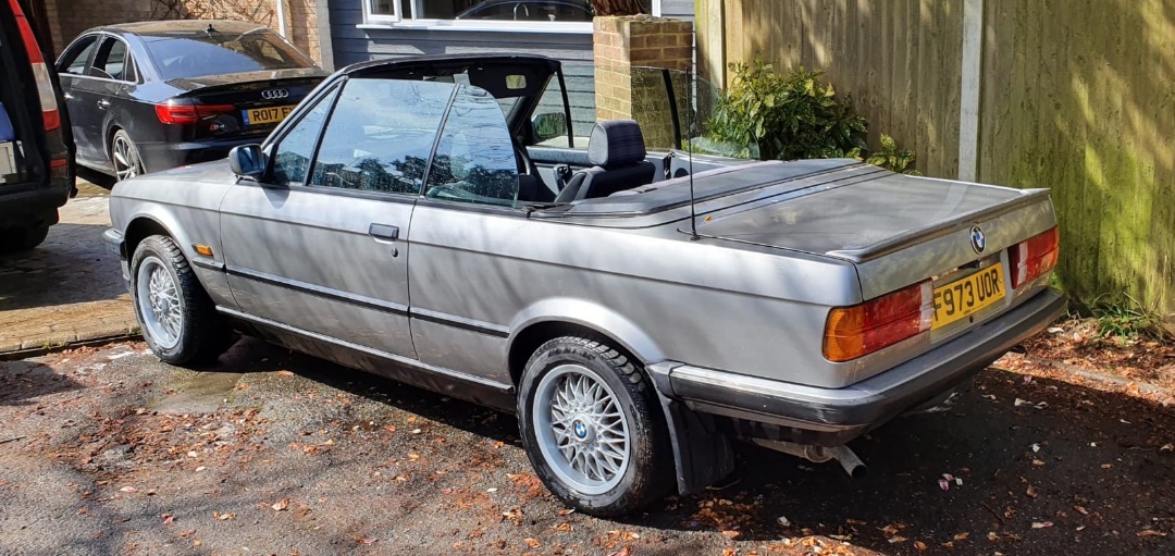

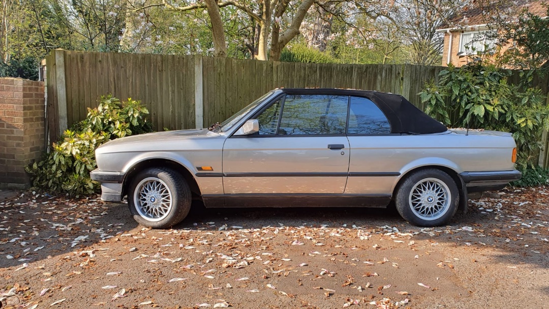

It would be great if I could get some advice from you all as I own an F reg e30 320 convertible which I unfortunately blew the head gasket on.
At this point I decided to upgrade to a 325 engine and purchased one and the ECU for the same vehicle and took the car with the parts to a garage to get the work done. The guy managed to swap the engines and ecu but said he couldn't get a spark from the plugs.
I have been told it may be the immobiliser causing this issue so I was curious to find out if anyone has encountered this before or have any suggestions?
Any advice would be appreciated as, stay safe and well!

That is a good looking convertible you have there.

The car looks very neat with the Shadowline (black trim).

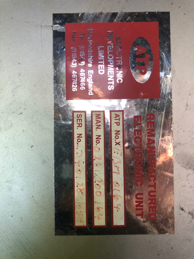

So crank sensor has been changed but still no spark.
C101 - not all the pins line up, there wasn’t a pin 20 on the car loom but there is on the engine side. Also a brown wire has been cut
As for the fuel pump there isn’t any sound coming from it when I crank the engine and no power going to the 2 pin plug.
I have also attached picture of the ECU if this helps
Any ideas?
