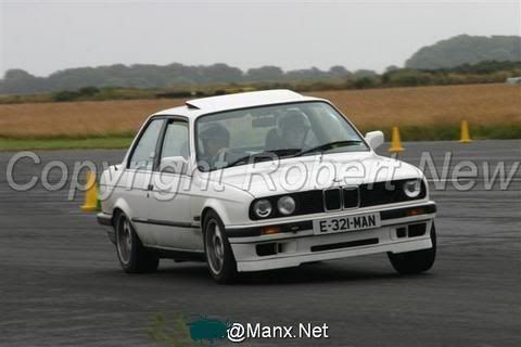

I just feel on the track the fast sweeping bends in particular (around 80mph and 100mph) the back end seems 'twitchie' so I feel it's the rear ride height. A pal of mine was following me and said he thought it looked a bit high, I'm keeping it 'smooth' and not unsettling the car so I'm going to try the ride height for the sake of the cost of some springs...Agent006 - any thoughts welcome..... :)

From those photos yours actually looks lower on the loaded side than that racecar. I'd look at other things before just lowering it more. There are some excellent flowcharts on handling problems on the net somewhere, i'll have a dig around and see if i can link to them.
