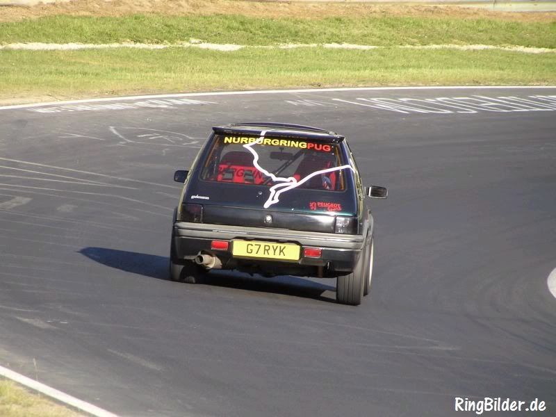

I spoke to you guys, infact I took some pics and sent them to some of you. James wheeler was one I think?
I was in this

northloop wrote:I spoke to you guys, infact I took some pics and sent them to some of you. James wheeler was one I think?
I was in this
Yeah, I recognise that car, was behind you coming out of the car park at one point.....I'll keep an eye out for you next time I'm up there, though prob wont be till May.
