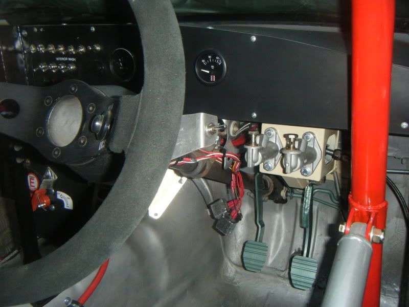

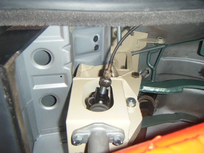

Hi Theo,
Hope these help. Sorry for flooding your thread with pics. Even though we have very different cars I think you may find these helpful since our inlet manifolds are in a similar position. You'll see that I had to angle the frame/body of the pedal set downwards in order that the master cylinders emerge below the plenum. I think what may also make these pics useful to you is that in some of them the firewall is absent, which makes it that much easier to illustrate the position/mounting of the pedals.
Please keep in mind that these pictures were taken in the very early stages of my build, so please excuse all the rust.
To make my life easier I made up my bracket (visible from the top) and fixed everything in place before I then rebuilt the firewall around the pedals.
This picture most clearly shows the bracket I made to which the frame of the pedals bolt.
This was after I started rebuilding the firewall.
You can mount the fluid bottles directly on top of the master cylinders if you have room, but in my case it was easier for me to mount them remotely. Of course its not a good idea to mount the bottles on the cylinders when they are at an angle
My plenum sits comfortably between the clutch fluid bottle and the two brake bottles.
Viewed from the interior.
I tacked a piece of plate across the top of the steering column to which I attached my clutch and brake switches. My accelerator pedal is my own contrived contraption.
I realise that your own setup will be very different from mine, and in particular you'll have to find your own way to mount your bracket (I also expect that you'll have a lot to move around under you dash) but hopefully these will give a few ideas to help get you started.
Regards
Geoff

Thanks for all the pics Geoff, I think I've got a fair bit more space to play with compared to you, so it shouldn't be too tricky. I think I'll mount the pedal box to a bracket like you did, determine the position I want it mounted and then modify the bulkhead accordingly.
I see that you used a significantly larger master cylinder for the front brakes, how did you decide on sizing? I was thinking .625 for the rear and .700 for the front - but that really is just a guess plucked out of thin air.
I've found out that the standard Nissan clutch master cylinder is .625, so that makes choosing the clutch M/C size nice and easy.
