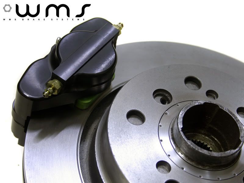

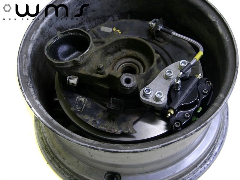

The WMS 280mm kit definitely fits under the 15" BBS on the E30 (it was the "common race wheel" that we designed for!). :)

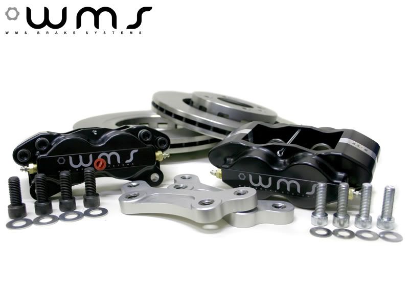

Here are the WMS E30 kits (each includes calipers/brackets+inserts/bolts etc/discs):
4P025 - 280x22 size kit with best wheel clearance (printable clearance test profile: 280x22 kit PDF ) = (£see link at top RRP - 5% E30Zone member discount) = £see link at top

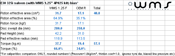

I've been working on bias a bit recently, ONLY as a simplified "brake setup vs brake setup" comparison, not an overall car study - so this ignores everything other than the caliper/pad/disc.
Here are four examples, interesting results I thought!
Standard E30 saloon (not Touring!)
...fitted with 280mm disc / 1.25" piston WMS kit:
...fitted with 298.5mm disc / 1.25" piston WMS kit:
...fitted with 280mm disc / 1.38" piston WMS kit, this is the earlier spec and is still available for people wanting more front bias inside the 15" BBS (due to running semi-slicks for instance):

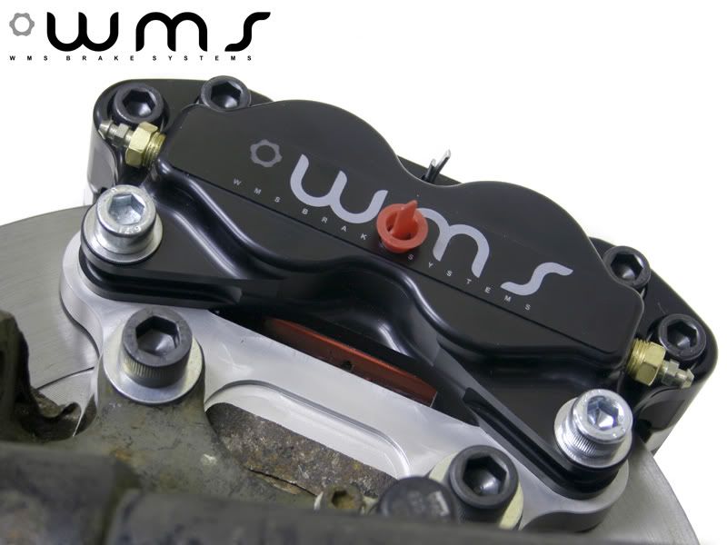

Here's the 280x22 4P025 fitting inside the 15" BBS (made for BMW by BBS) and the FPS-BBS (made for BMW by FPS), but the Alu-BBS (made for BMW by Alu) does NEED the 2.0mm spacer as it's tighter behind the spokes:
290mm vented 2-pot retaining the handbrake, one is already in Beta testing:

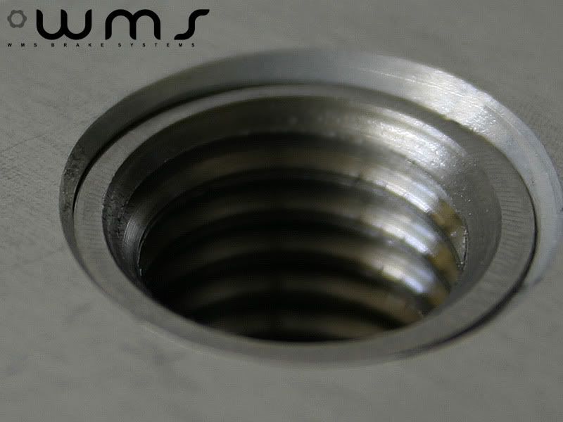

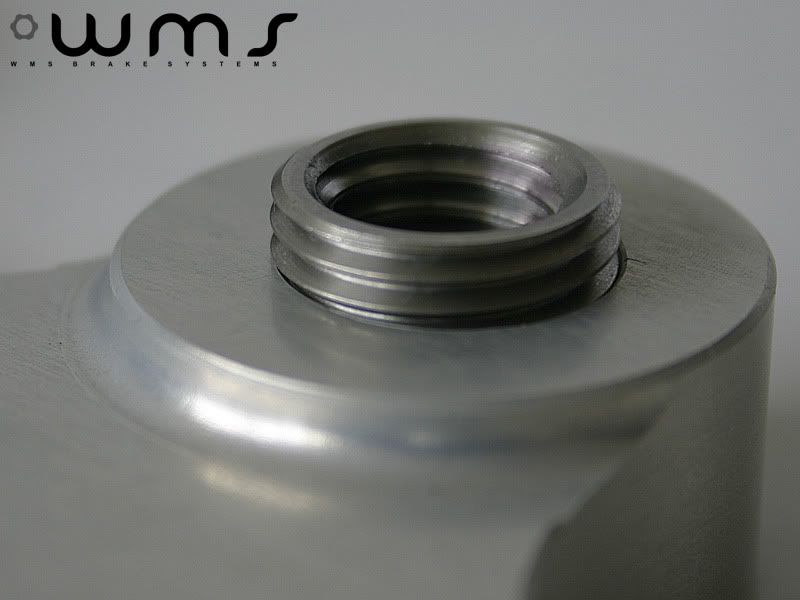

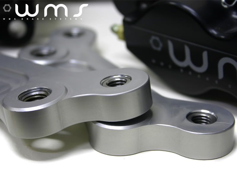

They are about getting the best of both worlds. Aluminium brackets are easily strong enough to take the loads created during braking, but have a few issues:
- Aluminium is a bit soft to have threads in it, especially if the bolt is taken in and out a lot.
- They are also at risk from people fitting extra washers and/or shorter bolts etc resulting in less engagement, or over-torquing, basic human error etc.
Steel/Stainless brackets on the other hand are fine for the threads, but also have issues:
- They are heavy.
- They are also very expensive to machine.
By fitting heavy duty stainless inserts into aluminium you get the lighter bracket, but with the stronger threads! In effect the aluminium "sees" a much larger bolt/thread so it has an easier life. Other things worth noting:
1 - The inserts are 431 or 303 Stainless Steel. 431 is a VERY high grade of steel, in fact its properties and tensile strength are similar to a Grade 12.9 bolt (think ARP rod bolts etc).
2 - The inserts are fixed into the bracket with a grade of Locktite retainer that can withstand high temperatures (the softening/"disassembly temperature" is 250 degrees C) and is fully resistant to motor oil, unleaded petrol, brake fluid and ethanol.
3 - In destruction-testing we tried to pull an M10 bolt/insert out of a bracket by over torquing it. It made it to 80FtLb (twice the 40FtLb suggested for use one the car) before the Grade 12.9 BOLT stretched.
4 - Lastly this is not an untested concept: Wilwood's own USA-market brackets are aluminium with threaded inserts as well.

e30cossie wrote:They are inserts for the spacing brackets as you can see them fitted in the picture.
One looks like a hellicoil and other a reducer for the hole.
Kind off, both are thick tubes with threads inside and out - but the smaller one has a top-hat type flange added. We might drop the top-hat's flange in the next batch though...
I hate helicoils, they are a spring in essence and while they DO work - I still just don't like them! :eek:
