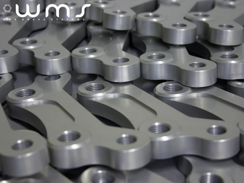

Just a note to point out that I've edited the WMS prices post in this thread.....the spec has gone UP (lower-profile calipers giving about 1mm more room, 6082 T6 brackets) and the price has come DOWN (by just under a tenner)!
The pistons and caliper bridge spacers have been tweaked to the new 2010 spec (along with the brackets), this gives just over 1mm more room to the spokes. Not a lot - but a real bonus if means you can run a daft dished wheel at the standard track.
I'm picking up the new brackets this afternoon!
