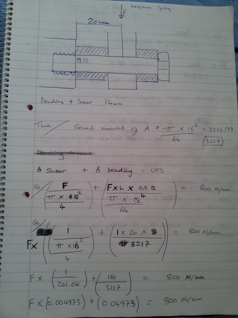

hmm, even with a 60n/mm spring and 80mm travel we are looking at too much force.
theres 3 issues here.
1. spring rate
2. suspension travel
3. distance from the trailing arm to the centre of the coil over eye mount.
without these 3 we will be speculating.

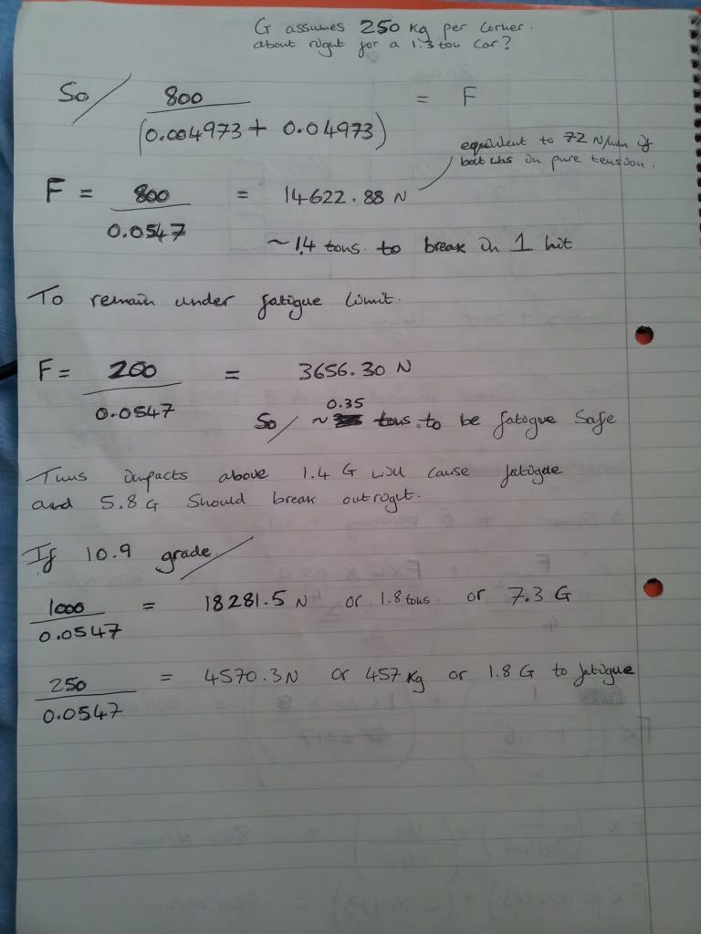

however assuming a 3" travel and an eye centre 35mm from the arm the max spring before breakage is 49n/mm or 279lb/inch. (assuming an 8.8 grade bolt)
Which means if the spring rates were 40n/mm then they were pretty close to the wind. That bolt would have been doing no more than 1 race!
As i say though with out the values for the 3 things above being right this is only speculation.
The calcs above assume the spacer to the outside of the gaz bottom eye is 25mm and the eye is 20mm, thus placing the centre of the load 35mm from the trailing arm.
If the eye is moved closer to the trailing arm then the bending moment is reduced.

if i remember then ill take some measurements of mine tomorrow so we can get a proper answer.
i think want is certain is the bolts are in a situation where fatigue is an issue, its just a question of how bad it is.

I think you'll find that's the yield strength at 80% of UTS in tension Screech. You can expect to see a bolt fail at around half that value in shear.HairyScreech wrote:going at 80% uts as the bolt is stated on the last page as a 8.8 grade.
Thus 800n/mm^2 and 80%
I do believe, however, that if you are concerned with spring deflection then you should be looking to calculate that deflection as a function of the applied load (due to the action of the un-sprung mass upon the sprung mass while riding a defined terrain), and not the other way around. The deflection of the spring is little else other than an indicator of the load applied to the spring (much like a spring type bathroom scale), it does not define it.
I believe that you are correct Keri. It is often forgotten that while a spring resists deflection, a damper resists rate-of-change of deflection. That is to say, the force exerted by a damper is a function of how fast it is being displaced (that really is what defines a damper). A step-change in terrain (such as a curb-stone or pot-hole) results in a significantly greater reaction force from the damper than from the spring.keri-WMS wrote:My understanding is that it's shock (fast) loadings that will carry the highest forces - not springs which carry a fairly smooth/even load.
So increased shock rates will have a bigger effect than adding springs and using a coil-over design...
In most cases adding a spring to a shock-mount is fine, it's adding shocks to spring-mounts that tends to break things.
Despite expecting the bolt to fail in shear at a lower value than indicated by screech, I still would not expect to see that bolt fail. If we assume roughly 230kg of static load over each rear wheel then you’d require a dynamic load of near 15 times that to get that bolt to fail (by my estimation) and near 30 times that by Screech’s. Around a well manicured track I would not expect to see dynamic loads that high.
But honestly gents, that’s just my opinion with some very rough calculations thrown in for measure. I’m not looking for a fight and it certainly is not my intention to diminish your efforts Screech.

Obviously not geoff, open and clear discussion is the only way to hash these things out properly.
as for the yield yes your right that is in tension, but then the yield doesn't actually factor into anything if you just do the bending and shear stress calculation.
I too have been told the largest force is in the rebound, although with a spring over damper the spring and damper are acting on each other directly with this load never being transmitted to the mounting points.
Which leaves the largest force on the bolt in a coil over application the compressive loading.
Which would certainly follow what i have seen, i have always questioned the damper loading thing, certainly when applied to coil over units as i have only ever seen them broken at the mountings in compression.
We cannot quantify the load spike produced by the damper in compression so all we can do is look at the spring force.
I was after the damper travel as the spring rate is in N/mm or lb/inch, so any spring load needs to be looked at as the rating x the deflection.
Although this may be an over simplification, as that would assume a correctly sprung car to fully absorb highest load, which a track car on coil overs is most certainly not as the spring rates are being used to control pitch.
Perhaps a measurement of the wear mark on the damper might be more helpful at that will tell us how much load is applied during day to day depravity.
We will be better served looking at the load as a function of the damper travel seen in normal use than guessing at a maximum loading.
at least if we times the used damper travel by the spring rate we will have something reasonable go on.
Tbh, none of this has considered bottom out forces, which that bolt is no way able to handle, one trip up the mountain at Cadwell or over the curbs and the compression spike is potentially massive.
Again if it was me i would still be running the bottomout bump stops on the trailing arm pad, where they were originally.
For illustration our formula renault a 540kg race car bent a 10mm axially loaded pushrod adjuster the other week after a bit of a corner cut and the curbs at pembrey are no way near the suspension smashers at some tracks.

Ok, i have just measured my "normal" damper mount on the car, its 20mm to the center line of the eye.
However there is a 14mm tube that the rubber damper bush is centered on.
This 14mm tube will take some of the bending load.
Do the GAZ dampers have a mounting tube or are they direct to the bolt?
Do the sleeves either side of the eye mount hold the rose joint tight?
If so a simple bending and shear analysis wont be enough, and frankly that's deeper than i know how to go and gets pretty damn complicated quickly.
What i could do if that's the case is get some higher help that may be able to give an answer.

i checked up, we need to treat the thing as a whole.
Basically where its has spacers we can just treat it as one solid steel bolt the same diameter as the outer diameter of the sleeves.
Which is what i was thinking and as long as the bolt is correctly torqued then it will behave as a solid piece for all intents and purposes.
So assuming the spacers are about 2mm thick we can just treat it as a bolt 16mm in diameter and the answer produced will be close enough to make no odds. (the thinking being if your close enough to the max stress that the error introduced matters then your either in f1 and should be using fea or its time to fit a bigger bolt anyway.)

i have assumed 16mm outer diameter for the spacers here (ignore where is wrote 14mm at the start, i wrote that while at uni)
If someone would like to check the math (as i'm prone to stupid errors) then we can assume this is the acceptable minimum loading for failure and fatigue to occur.
Thought i would just do it as maximum safe wheel loads, then once we know the spring rate we can see if its above or below.
Pretty much from that we can see it doesn't take much to produce a fatigue effect in the bolt.
Its 100% a bolt i would be replacing at least yearly if i was going to rely on it to hold the car up and i think that's a small concession given the consequence of it failing.

Been a while since I worked out shear and bending moment diagrams on beams, but I follow your working OK Screech.
I see, however, that you are equating the sum of the shear and bending stress to the UTS of the material. The shear stress (on the left) is the usual applied force divided by the cross-sectional area of the beam, while the bending stress on the right is the bending moment (force x distance) divided by the section modulus, where the section modulus is by definition the 2nd moment of area divided by the maximum distance from the centroid of the beam (which is, in this case, the radius). So all good so far.
Only thing is, the bending stress determined by the right hand term is in a direction parallel to the axis of the beam. It's at 90 degrees to the shear stress, so you can't simply add the two directly to each other. Think of a cantilever beam jutting out from the side of a wall. The force applied to the end of the beam (pushing it down) tends to tear the beam out at the top edge where it connects to the wall, but push it in at the bottom edge of the wall. Top edge is in tension, bottom edge is in compression ”“ the bending stresses run parallel to the neutral axis while the shear stress is parallel to the wall.
Not that it makes a huge difference, mind you, as the bending stress clearly dominates (by an order of magnitude) over the shear stress. So, as I think you have clearly demonstrated, if the bolt is to fail it will be as a result of bending, and at an uncomfortably low value as well. Good on you since I initially only considered the shear stress.
Considering the bending stress only (ignoring shear) it works out (using exactly your values above) to a static weight of 1.6ton required to break that bolt. That’s a bit too low for comfort in my opinion.
It’s also worth keeping in mind that the bolt plus spacer only behave as a 16mm diameter beam so long as the tensile force in the bolt (after tightening it up) compresses the spacer between the bolt head and the shoulder of the mounting hole. If that bolt were to come loose that spacer would simply be along for the ride and you can treat that bolt as a 12mm diameter beam, which would bend and fail under a static load of only 680kg (again ignoring the shear stress).
I think you were right to do this calculation Screech. Well done
. I retract my statement about bouncing the car around on one wheel to get that bolt to break, I was wrong. That bolt genuinely is a weak point, particularly if it were ever to come loose. At the very least a 10.8 grade bolt should be fitted.

Well i have never tried doing a stress calc in that manner, i just cooked it up for this, so its pretty untested but does seem to produce the right numbers.GeoffBob wrote:Been a while since I worked out shear and bending moment diagrams on beams, but I follow your working OK Screech.
I figured that if shear stress + bending stress = uts then its a 100% fail.
Thus, taking the Force as a value of 1 i could work out the magnitude of the shear and bending component that the force is multiplied by.
Hence the F*(shear magnitude + Bending magnitude) = uts
Now i'n not sure if that should be 2F*(shear magnitude + Bending magnitude) = uts
As it comes from f*shear + f*bending = uts.
In terms of the other force being at 90 deg it shouldn't matter should it?
as the equation takes this into account by using the force*bending moment*distance from the neutral axis, this is then divided by the second moment of area.
As i say i'm not sure, i might check it on monday, but the figures seem reasonable.
Yes in a case like this bending stress is always going to be the killer, thats the single/double shear issue.GeoffBob wrote: Not that it makes a huge difference, mind you, as the bending stress clearly dominates (by an order of magnitude) over the shear stress. So, as I think you have clearly demonstrated, if the bolt is to fail it will be as a result of bending, and at an uncomfortably low value as well. Good on you since I initially only considered the shear stress.
I too am quite surprised its so low, but then when you consider things like my DH bike using an 8mm bolt with 1/2 inch sleeve just to cope with 1 person then it becomes a lot more reasonable.
If you got 1.6 ton in just bending then i assume factoring it the way i did must be right.
The bolt on the must absolutely be tight, as you say any slack and its game over.GeoffBob wrote: It’s also worth keeping in mind that the bolt plus spacer only behave as a 16mm diameter beam so long as the tensile force in the bolt (after tightening it up) compresses the spacer between the bolt head and the shoulder of the mounting hole. If that bolt were to come loose that spacer would simply be along for the ride and you can treat that bolt as a 12mm diameter beam, which would bend and fail under a static load of only 680kg (again ignoring the shear stress).
I think you were right to do this calculation Screech. Well done. I retract my statement about bouncing the car around on one wheel to get that bolt to break, I was wrong. That bolt genuinely is a weak point, particularly if it were ever to come loose. At the very least a 10.8 grade bolt should be fitted.
