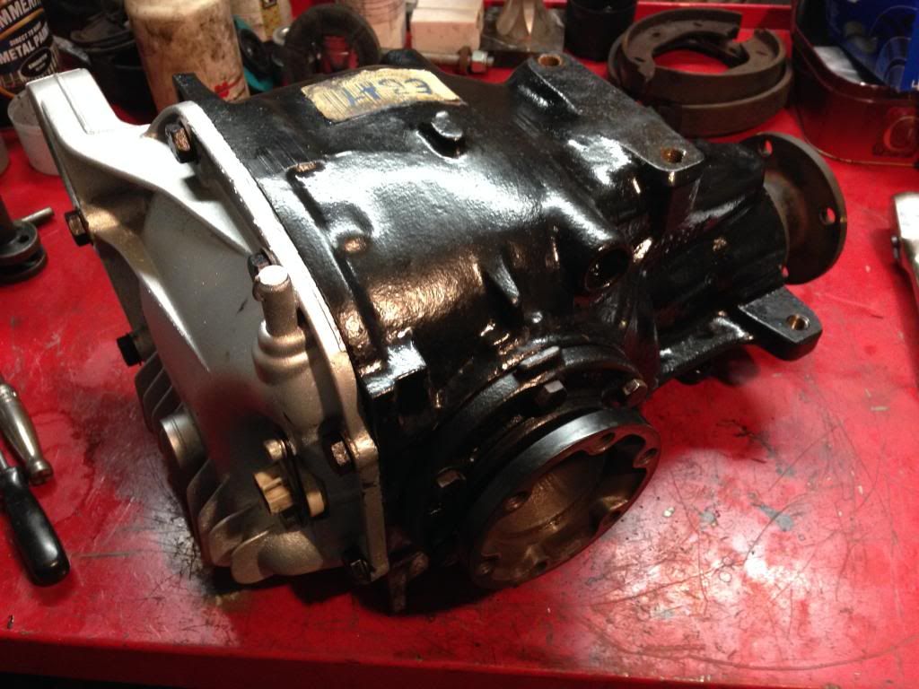

Demlotcrew wrote:Could you do me a favour and take a photo of the pulse disk at the opposite end from the cap. :)
No problem. Do you mean the pulse disc for the speed sensor?
Demlotcrew
Posts: 13329
Location: East Anglia
Tue Dec 10, 2013 6:22 pm
Yup that's the one.

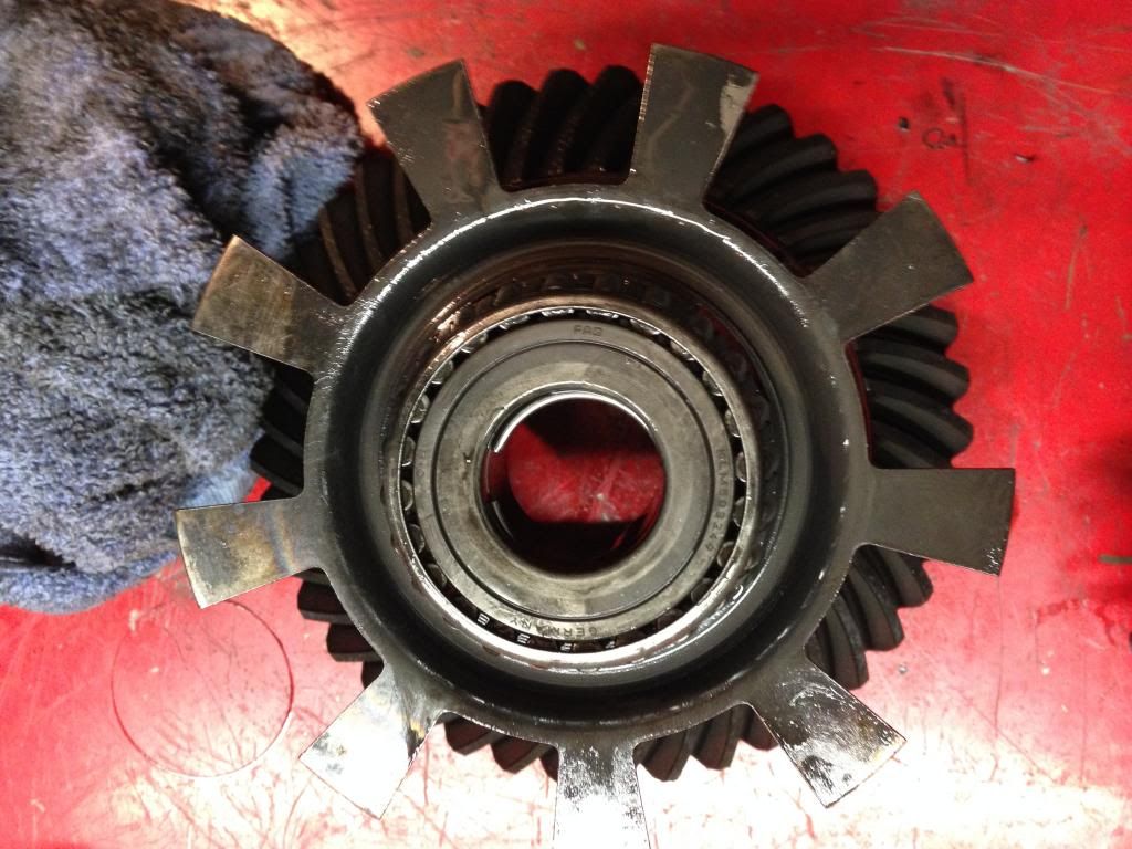

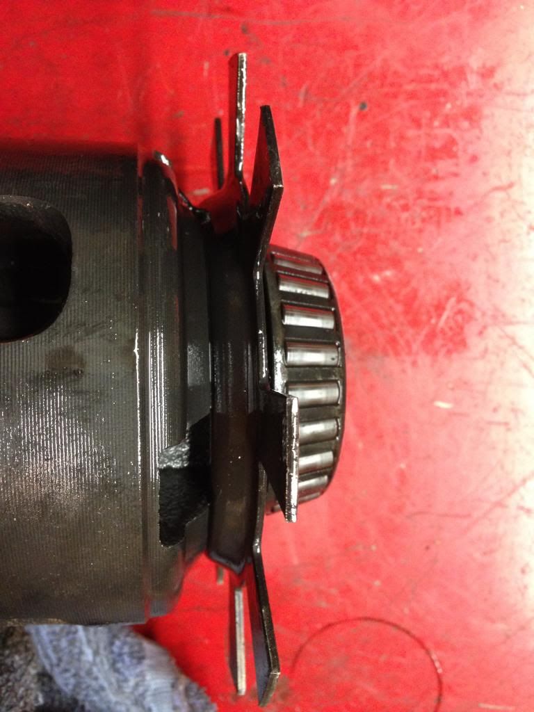

Here y' go.
I'll give it all a clean perhaps tomorrow. Let me know if you want more pics. It should be easier to photograph with it not covered in old oil residue. :)
gareth
Posts: 11009
Wed Dec 11, 2013 1:00 pm
I'd replace those plates personally. They tend to glaze up then finally once they wear through the very thin coating, chew themselves to death and fill the oil with shredded metal. Then it's full rebuild time once the bearings run in the residue...
A lucky find though :D

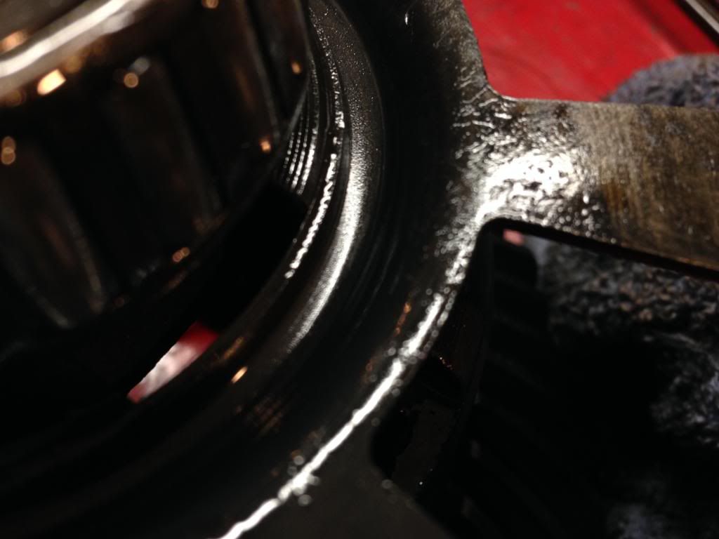

The dog ear plates are in decent condition. Here's one after about twenty seconds with a bit of scotchbrite:
I've ordered a new set of friction plates. :D
