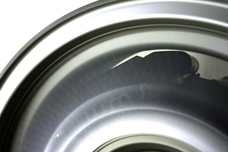

I have to get back to the M3 strut etc but for now here's the first production 298.5x24 4P028! :banana:

15" BBS / 4P025 eye candy!!! :D
keri-WMS
Posts: 1269
Thu Mar 04, 2010 2:41 pm

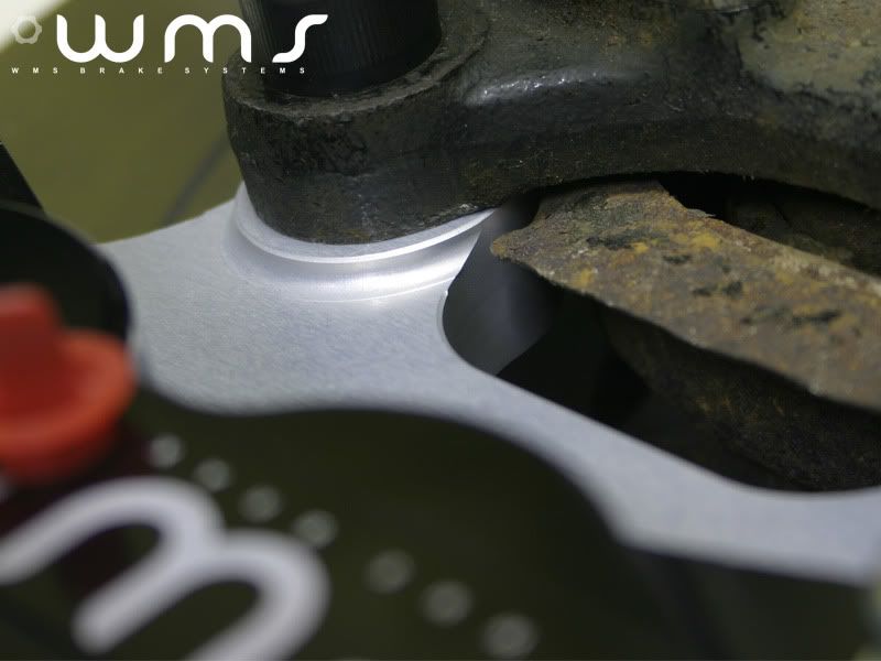

I've just been messing about with the Alu version of the BBS and it's got less room for brakes due to small wedges behind the spokes!!! Barstewards!
The photos above are of the fit inside the FPS-BBS, the Alu-BBS does need the 2.0mm spacer being tighter but does still fit, the BBS-BBS is to be confirmed but should be fine...

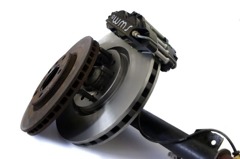

Here's the (random but E30 diameter!) 260mm disc vs the 4P025 (G60) disc vs the 4P028 disc:
Detail of the 4P028 bracket!

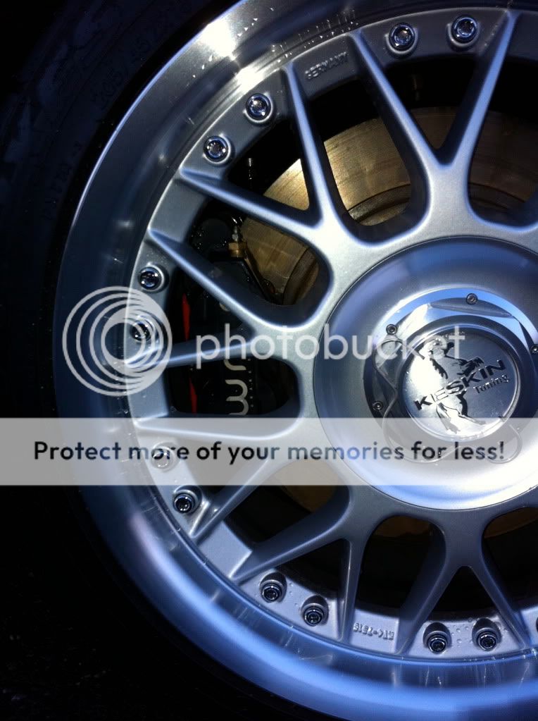

Keri, Keskin KT-4 alloys fit 16x7.5 et 20. About to fit Compomotives TH Mono 1680s, will let you know how they fit. The brakes are awesome, very happy!

I've had this kit fitted to the car now for a good couple of months and as such would like to add a few words to the Zone in case anyone was thinking of taking the plunge.
The kit I have fitted is the 298.5mm (G60) setup with Red Stuff pads and thus far has been nothing short of fantastic. To qualify my opinion I have owned cars with very good Brembo 4-pot systems and as such compare the WMS kit to those.
The main reason for such delight is the difference on initial application of pedal between the systems. The Brembos would bite hard very soon, but with the WMS kit there seems to be a lot more feel and progression. It is as though you take your first estimate and are then free to add or remove braking friction as you so wish.
Longevity doesn't seem an issue yet, but then they are new. By longevity I mean the way they stand up when they've been used hard for a significant amount of time. There doesn't appear to be any difference between 'warmed up' and 'hot' discs. I must add though that they are quite vocal, squealing at many people quite indiscriminately! This happens with brakes that are performance orientated so it doesn't bother me too much at all.
You will struggle with wheel selection. Alpinas and BBS wheels below 17 inches are out. Forget 15 inch for that matter too! Another reason for the feedback now is the fact that luckily my favourite wheels (TH Mono) will fit in the 1680 fitment, but alas these will hide the great looking and yet subtle calipers. It is very pleasing to look at the wheel from a distance and see a rim-full of disc too!
They get my utter recommendation. With Keri's unflinching support and assistance in all matters relating to their fitment and shoehorning into a set of wheels right through to stupid questions post delivery I can't imagine any need to look elsewhere for fantastic stoppers for your E30.
