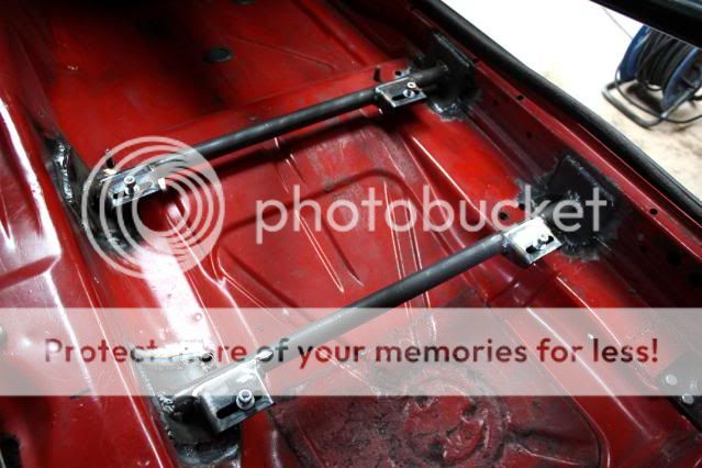

Seat rails:
Bought from here: http://www.topcatcustom.co.uk/?page_id=336
You can mount sliders to them no prob an it won't raise the seat that much they're only an inch is so tall. Where I have those weld in rails set to, you'd have no problem with the seat being too high on runners.
http://www.ebay.co.uk/itm/Universal-Roa ... 3a78d0bc45
DanThe wrote:I wouldnt fck about with a sliding seat, you just make it higher up in the car and a complete ballache, plus the safety side.
You say that but all GT car seats are mounted on sliders to allow for different height drivers to share cars for endurance races. I don't think there's as much as a safety issue with them as people seem to think.

Cheers mate that looks good. Do you have a passenger seat fitted? Did you do the same at all?
Not too bothered about putting that on sliding runners obviously.

rix313 wrote:Image
Way way too heavy, probably heavier than a decent bucket seat! (well maybe not, but close!).
Ferg, have you seen?
http://www.massivebrakes.com/accessorie ... sidemounts
Much better and lighter :)

Andrew as good as they look and with a reasonable exchange rate etc this car is not going to be a serious car with thoroughbred pedigree, it is just for a bit of hooning :)
Also the car has 4 doors which doesn't help my cause lol
The seats I have appear to bolt from the bottom rather than the side? They were local and super cheap 8)

Yeah it weighs a couple of kilos, but it ain't going any where. How much do you think a full cage weighs? Be like saying nah I won't fit a chassis cage I'll just fit a hoop made from Ali tube because its lighter.
