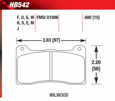

mmm the 7754 does not look right theo.
it should look like this as per the HAWK pads for the Dynapro and midilite:
I am waiting for Rix to send a pic of the pads he has got from PF.
maybe you can cut the 7754 to fit the caliper fairly easy by removing excess area.
DC

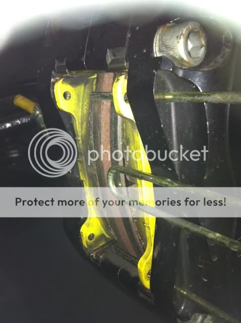

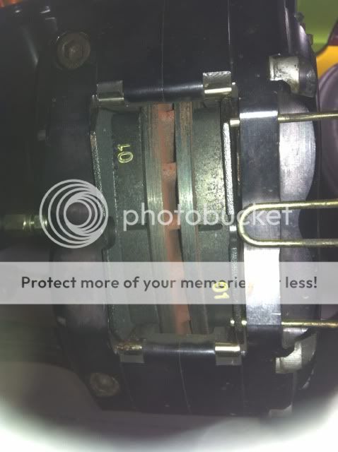

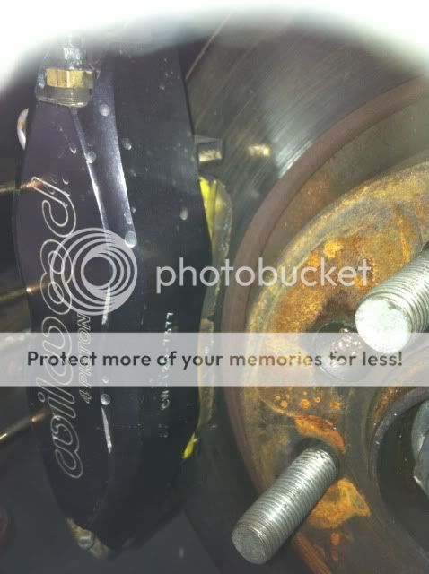

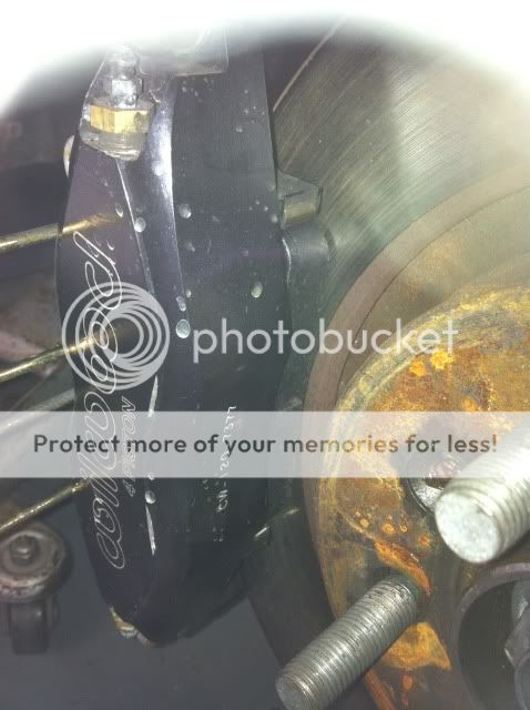

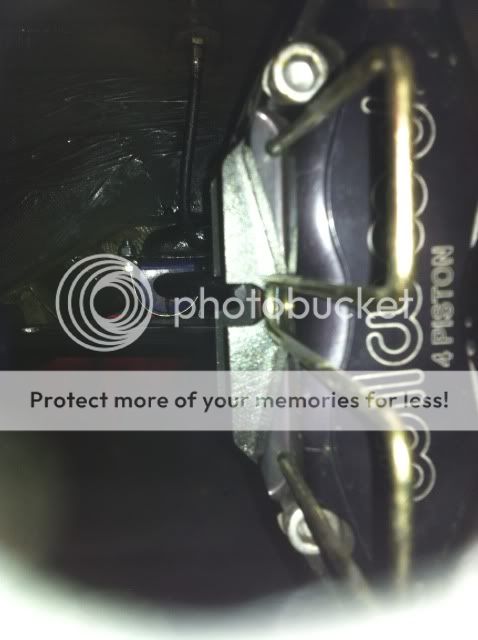

Had a play with the 7754 pads (16mm thickness) today on my calipers and compared them with the EBC Yellows I have in there at the moment.
The holes for the securing pin are in the same place as the EBC pads, it's just the backing plate needs modifying to allow the whole pin to pass through. This should make a better picture then what I am explaining:
How it should be:
Aside from that where the pad sits on the disc is the same as the EBC pads:
PFB:
I am taking my caliper and pads into PFB one morning this week to let them have a look and hopefully get something sorted.
How it should be:
PFB:
rix313
- Posts: 4942
- Joined: Fri Oct 31, 2008 11:00 pm
- Location: Silverstone
- Contact:
Went into to PFB the other morning. Advice was to mod the backing plate as the decision to 'commision' a new pad lays with America and would be very pricey. So I'll be marking the ones I have up and getting them on the milling machine.
