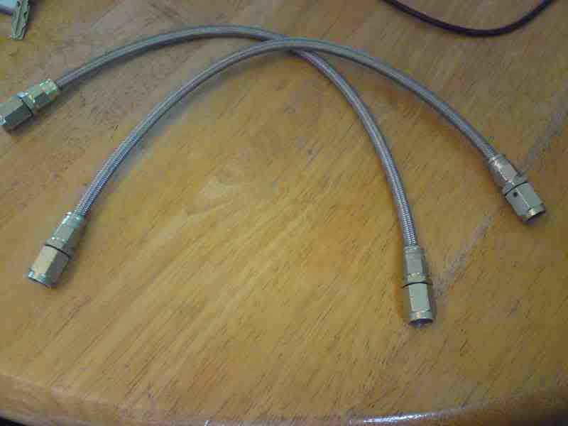

furbster wrote:I already have braided lines fitted to the car, would I need to replace them when I get a new kit?
You would need to replace them, or if they are compatible with the Earls lines you might be able to send them to Earls to be rebuilt!
