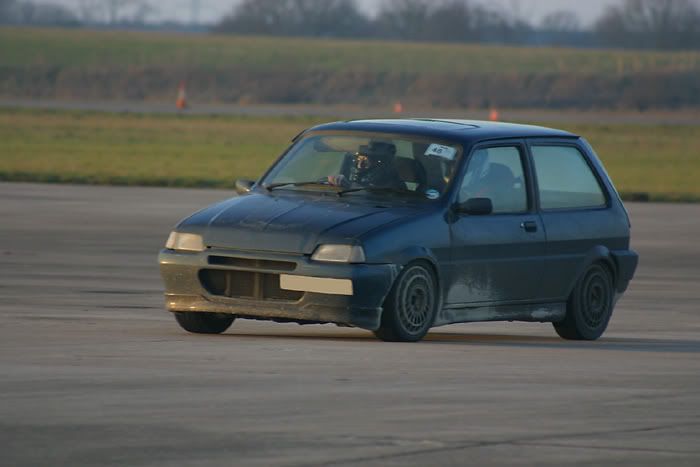

I lunched the gearbox on Friday in the 205 keeping up with a Caterham.
Enjoyed spanking 'a lot faster cars on paper' as usual
Love this weapon
On the plus side, the adjustable suspension works quite well. Goes sideways if you try a bit too hard. Found that full slicks on the front and r888's on the back work really well. Trying to get heat into the rear tyres is always a challenge in a FWD car with no weight in the back.
The car still made it back 65 miles with no gearbox oil at 45 mph on the a34
A shorter ratio box will go on now so that it can embarrass even more expensive machinary.

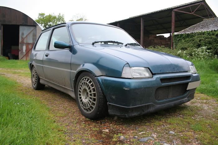

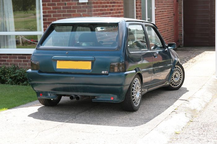

here's my (non e30) track toy. reading this thread the other day reminded me of the poor neglected car, unused in over a year, although i did go and make sure it was all ok and ran not long back.
story starts back in 2001 when i bought a standard l-reg 1.4 16v metro gti, did various bits and pieces over the next few years whilst at uni and ended up with a janspeed manifold, decat, custom exhaust, stripped interior, 15in compomotive alloys and 285mm front brake conversion, lowered and stiffened and on bilstein dampers.
oh, and some dubious body mods, including some home brew 'angel eyes' years before you could buy off the shelf kits.
it looked something like this...
always dirty, and with rust somewhere on almost every pannel.
after years of endless abuse the 120000mile old k-series lump started getting a bit smokey so i decided to upgrade it a bit.
it just so happened a mate of a mate had moved to australia and needed rid of his metro project sharpish. a deal was arranged and i bought hi metro complete with 1.8 mgf engine, jenvey throttlebodies and emerald ecu, for much less than you'd be able to buy the bits on their own for.
eventually those bits, combined with some of the bits i alraeady had on my 1.4 got put into my cars shell
the interior was already partially stripped, and had the boot floor modified to fit my centre exit exhaust, and we sunk in a battery tray to free up space i nthe engien bay, and shift a large chunk of weight bioth further back, and lower down, the bottom of the battery is now level with the bottom of the rear subframe and the floor pans.
the running gear is currently as folows
1.8 mgf k-series
pair of k-series vvc exhaust cams, one used for inlet, one for exhaust,
emerald m3dk standalone engine management
janspeed 4-2-1 manifold
decat
free flow exhaust
fse
jenvey direct to head throttlebodies with short carbon trumpets and pipercross sock filters
1.4 flywheel
rover 216 gearbox and clutch
grifeng quickshift
should be somewhere around 140bhp, with much more to come from a big valve head and proper cams. sounds insane
then i went a bit further with the stripping, removed virtually everything not needed, doorcards, carpet, covers, brackets, and all of the tar sound deadening stuck to various places.
amazing just how much stuff comes out of such a small car
i've also stitch welded most of the interior for both welding practise and an attempt to make the shell a bit less tin foi like
did have some pics of this somewhere
then did a few trackdays,
and a vid of a mate in his e30 m3 following me
http://video.google.com/videoplay?docid ... snetterton
the cars were perfectly matched o nthe straights, i was suffering from badly juddering brakes and was easy meat around the bends. still fun, and you can hear it pop and crackle at points.
little did i know that less than a year later i would own the m3 from the vid too
by now i'd decided i'd grown out of the boy racer phase, and wanted to titdy the car up a bit, the condition meant every pannel needed paint, and wanting to do it on the cheap, in a colour thats easy to paint, and easy to colour match i chose rover charcoal metallic, and set to work with a load of rattle cans
in progress..
a standard but debadged bonnet was put back on, and a spare set of headlights had their bowls and front facing outer edges painted black to give a meaner look, and the indicators were darkened too.
the bumpers were re-smoothed
and then painted matt black for a street sleeper oem+ look
a couple of weeks after starting it was finihed and back on the road
sadly it's not been used for a long while, i just havent got the time to repair and mot it. it needs a pair of trailing arms which is a sod of a job, and i really want a hydragas pump so i can diy it but cant justify it when i have an e30 m3 and a lancia integrale also competing for my spare cash.
sadly in that company a metro is always going to lose out
it'll be back out and giving plenty of laugh out loud moments sometime, hopefully in the not too distant future
