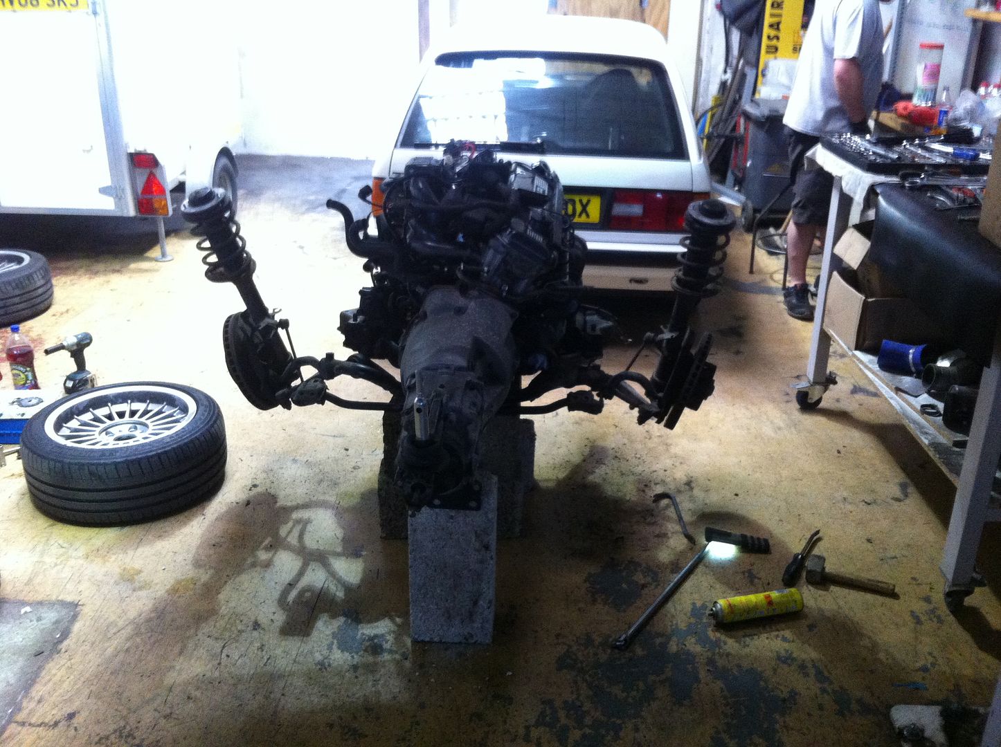

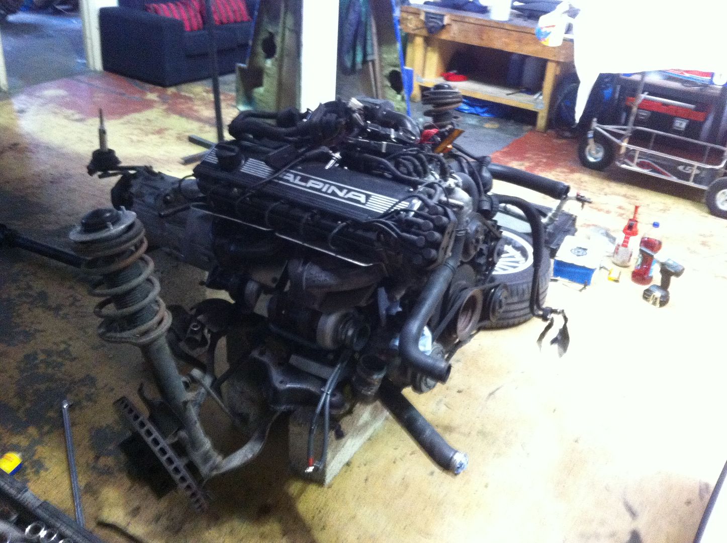

Well its all over, shes sold officially as i've actually had some money for it. After a long and drawn out affair an munich legends since the 28th june odd the car has been there.

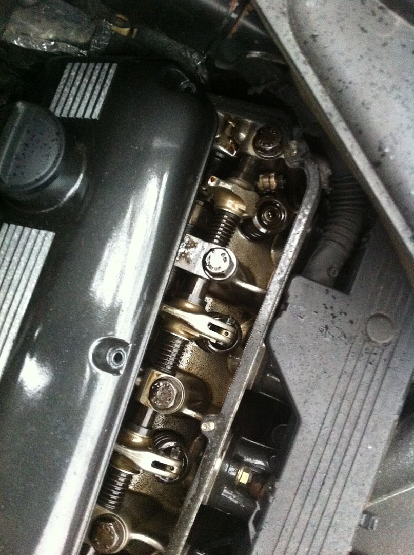

Anyhow the straw that broke the camels back happened in May on the way home from work.............. the engine suddenly went "ding" and then brrrrrr and running very rough, no power and just horrible. There was no smoke but i had a fairly good idea by the time i got home what had happened
A quick peek under the rocker cover confirmed my thoughts. Snapped rocker on number 6 inlet great. When i got the cover fully off it turned out to be 2 snapped rockers! Joy, so both rockers on number 6 snapped

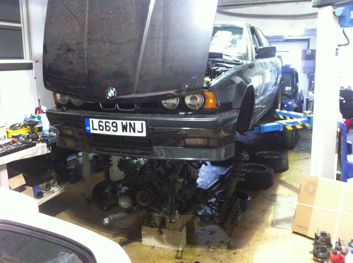

Que another few weeks sat on the drive with me having the arse with it. Then a phone call asking if it was still wanting to be sold as a customer had walked in at munich legends stating they wanted to buy one! We had been thinking for a while about moving it on

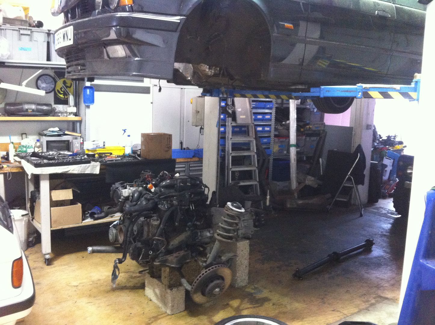

So back to henrys workshop for a repair. I disconnected the injector on number 6 and removed the broken bits of rocker and drove the bitch up there! Ran alot smoother with no fuel going in, tramped up the motorway to henrys ok at 70!
It grew into this, it seemed the most logical way to perform the repair
Henry helped with the rocker replacement here. The camshaft has zero wear, the other rockers had zero wear so i guess it was a bit of bad luck to cause the breakage.
So we literally undone the headbolts to get the rocker shaft out and replace the offending item, re torque head bolts and repeat on the other bank.
Re fit the engine and run it up to temp and then re torque the head bolts.
Going back in, naturally there we a few extra bits done along the way like rear discs and pads, plus the radiator top hose stub snapped so had to be raplaced. Plus other things i forget now
And this was the last time i saw her. Its kind of sad but not in a way.
How could you sum it up?
Epic car, epic repair bills. I doubt i'll be driving anything quite as heroic as this for some time. I hope the new owner has more luck with it than i did as having the engine out twice in 18 months wasn't very funny and the overiding memory for me in a way. Although my last drive home in her was great, so quick on the right roads
Bye number 445
Bye number 445
