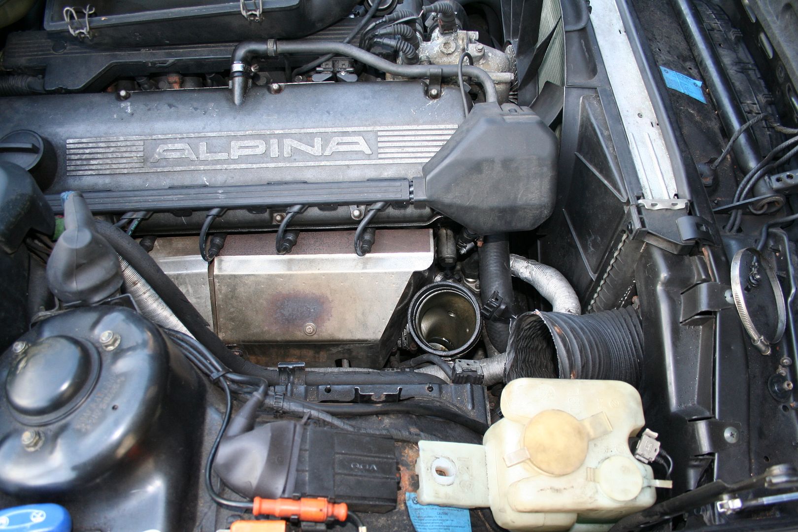

It sounded like it was coming from the front turbo, so i'm my wisdom i thought i'll remove the air box............
You can't see the front turbo from underneath or from the the top.
Then the stainless heat sheild off, which burnt me a bit! Then fit the airbox back on a run it. Which is what happened. Its not blowing on the front :mad: I guess the sheild was throwing the sound about! So i thought great, a bit more room on the rear turbo and i can see it from underneath.

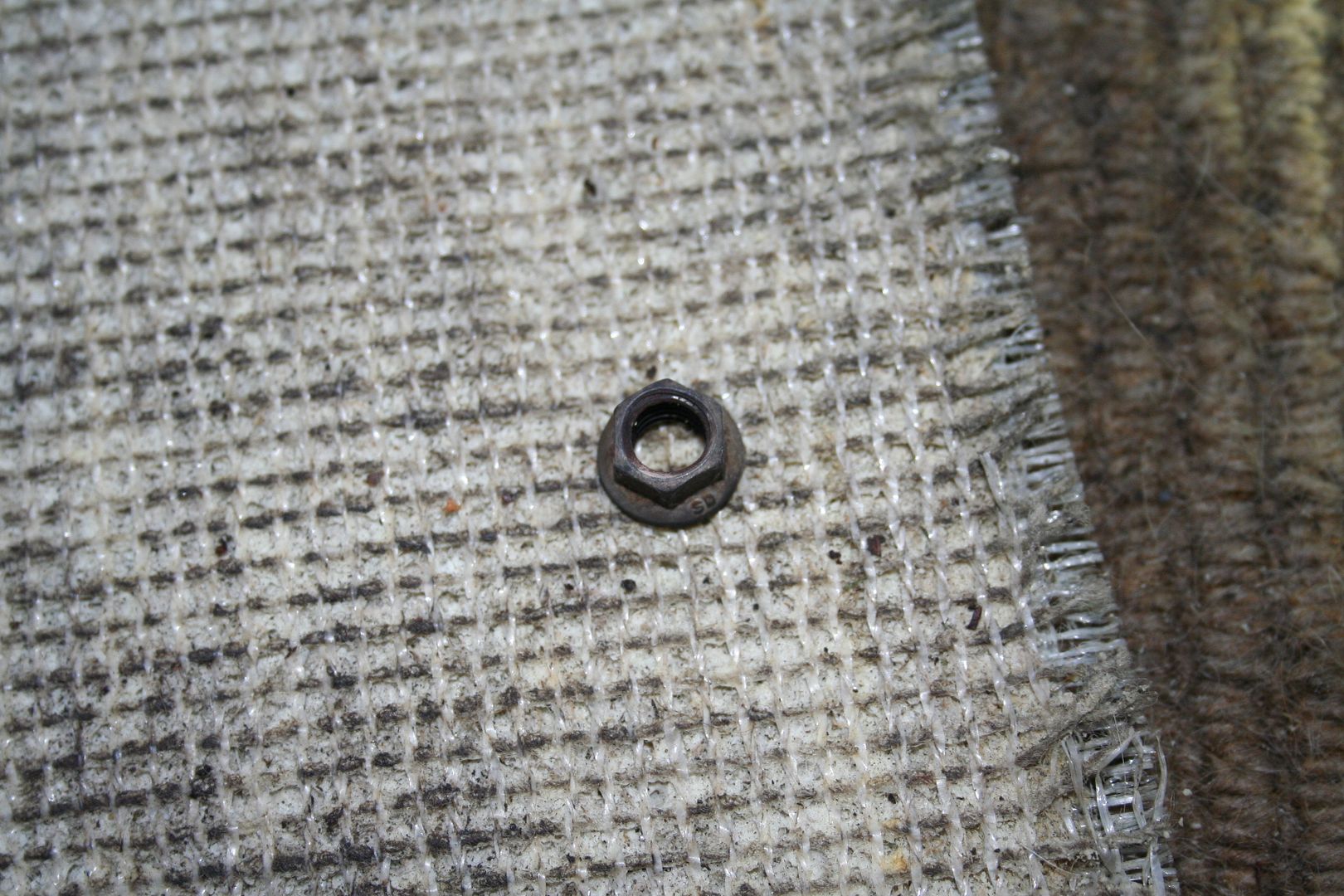

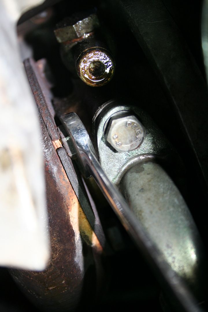

This bolt was loose on the rear turbo, tightened it and nipped the others. Seemed too easy started it up, still blowing but from elsewhere!
Theres 4 of these 10mm copper nuts, it was blowing here from the top corner, i could feel it.
Top nut didnt have a washer like the other 3, and was loose. 2 others were a bit loose so i nipped them up a touch. Fitted a washer and put the nut back on.

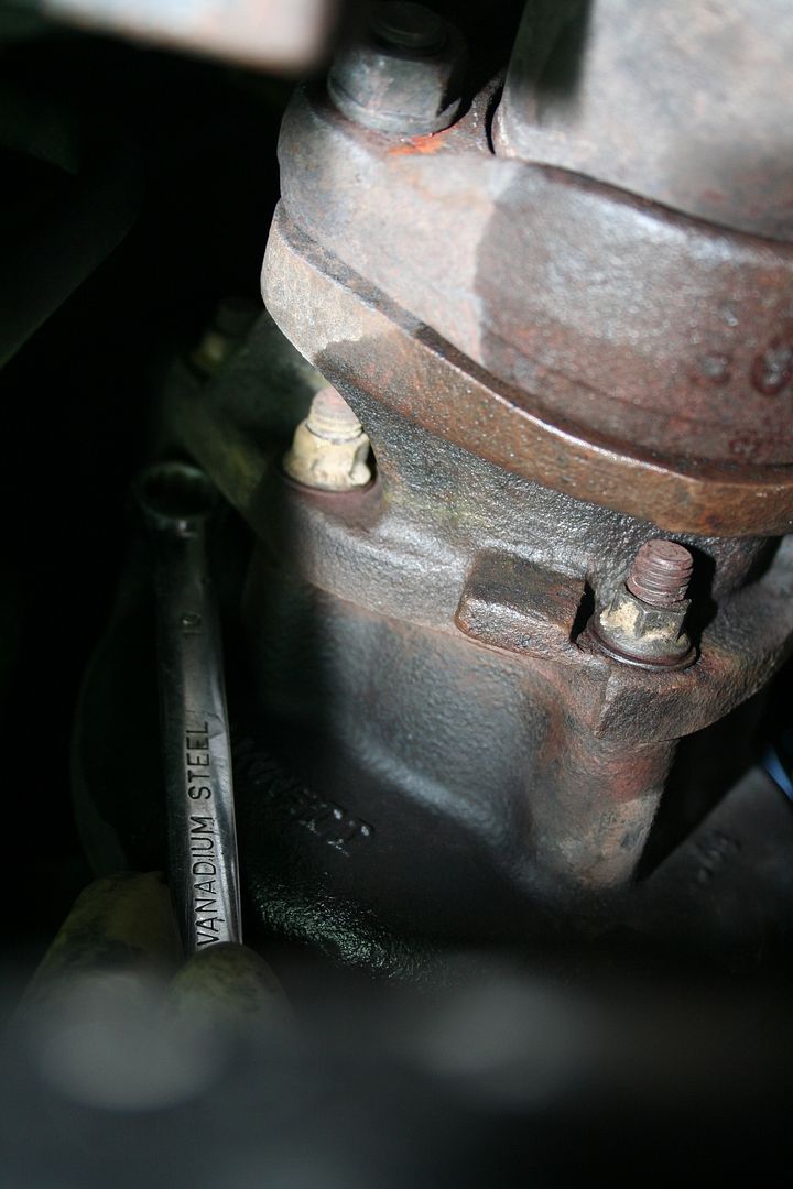

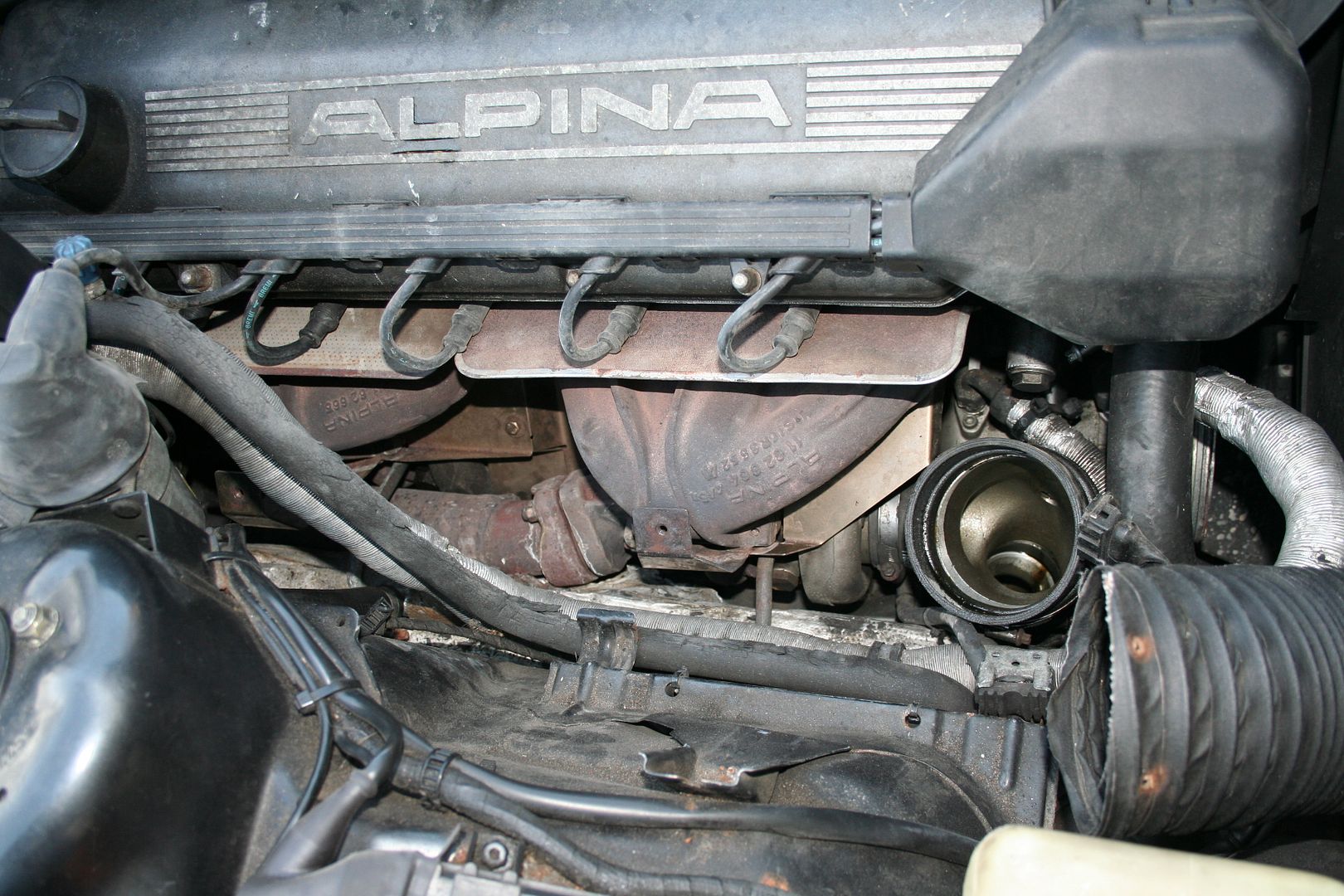

Moving onto the front turbo, there were more loose ones same places as on rear turbo
Theres not alot of room,
Or f**k all and this one really was hand tight. I'm suspicious someone has been here all before as there are 12mm nuts on the exchuast manifolds and 10mm ones. The down pipes are odd, front turbo has 12mm's and the rear 15's Strange if you ask me. I know birds have been here before though from receipts
Theres still a slight blow, but i can't get to anymore bolts without taking the bloody car apart. Its alot alot better but not perfect, nearly gone when engine is warm.
I mean i can see it going an ugly way! Turbos off, the exhaust manifold gaskets are a bit past it. All new gaskets, clean up. I guess you get the turbos overhauled while its all in bits. Gets rid of the blow and its all pimp again in this area.
