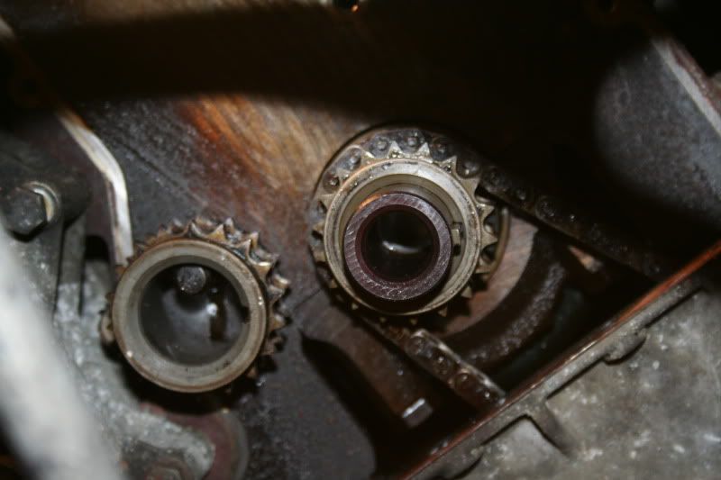

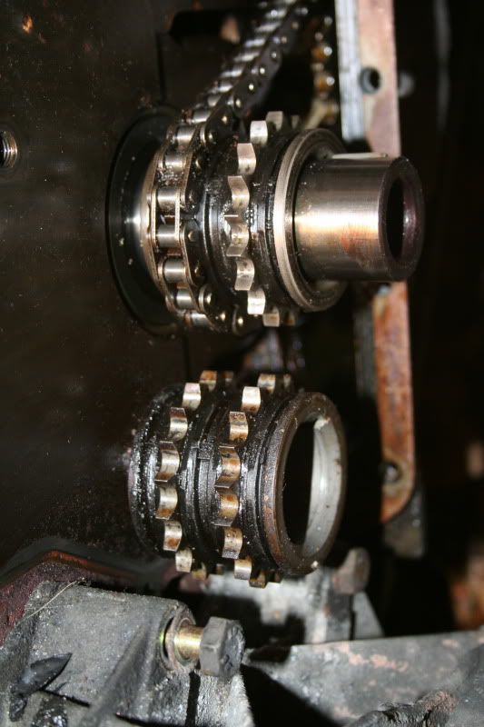

Indeed - a new chain on the existing sprockets will see it right. On my 730i (with 295'000 miles), the cam sprocket looked fine and there was only slight wear on the crank sprocket. I replaced the chain and tensioner rail only. On the 318iS (with nearly 180'000), again the sprockets looked perfect.
It's the crank sprocket that wears first - post up a pic of yours....but I'm sure it'll be fine.

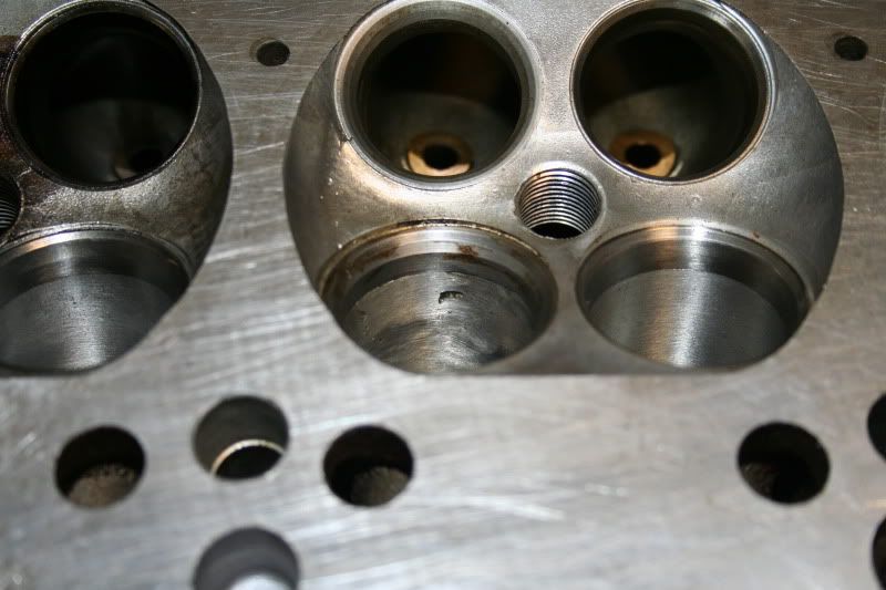

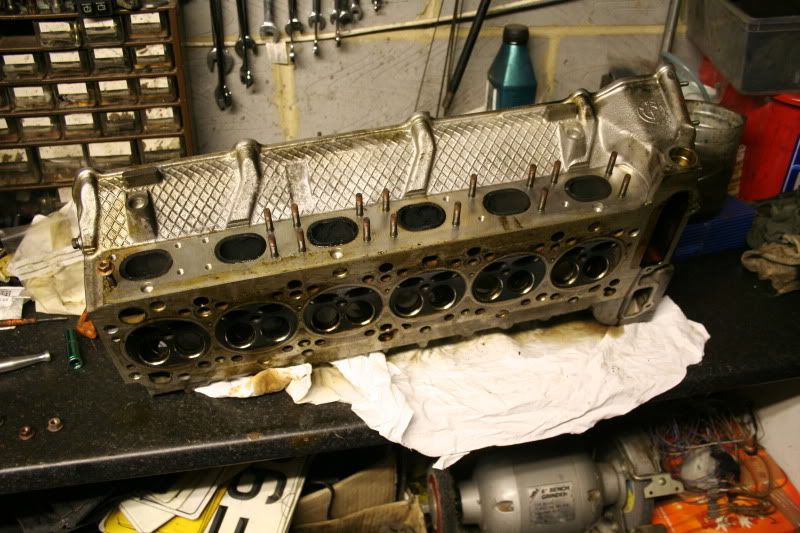

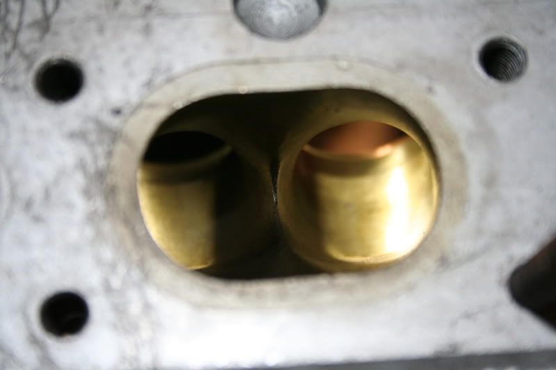

So i've picked up the cracked pina head and compared it with another head i've got
Alpina head

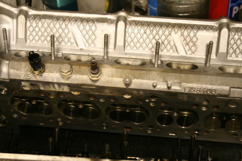

Donor M52 2.5 head from a 65k 323i nikasil failure. They have the same casting numbers. The trader i bought the car from also gave me another head from a 328i, its again the same.
They appear to me to be the same, bar the port work. So from my genius i think that the heads are the same for the following engines M50 2.5 vanos M52 2.5 and 2.8 vanos and this US spec donk.
The heads must be good? the 325i was 190bhp and this pina 265, so the heads must flow very well is my thought on these engines

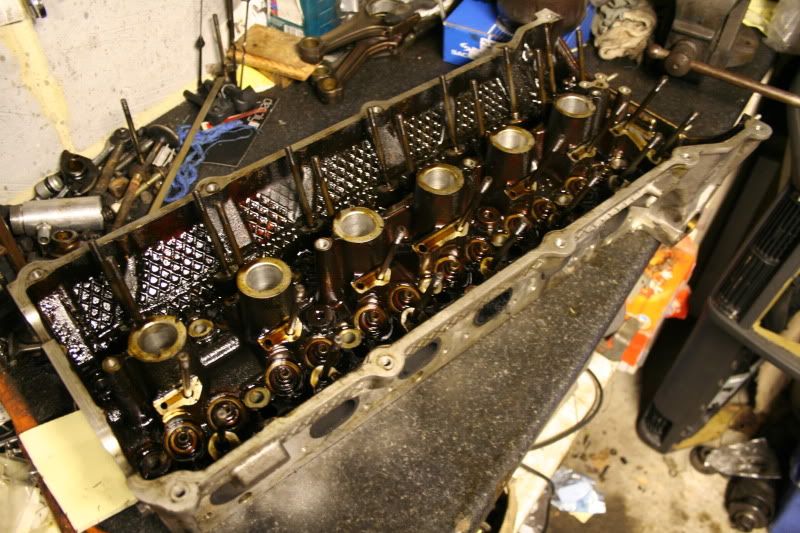

Donor head stripped down, i dropped it at the machine shop today for a clean up, my dad can re face it. The head doesn't need a pressure test as i stripped it from a nikasil failed engine that had been in the familly from new. The car it came from was the same colour so i hope its a good omen!
I've also stripped the alpina head down and heres a better shot of the weld (lower left port) and this is where its cracked. I guess the repair didn't hold very long if at all.

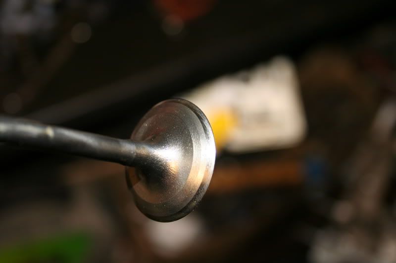

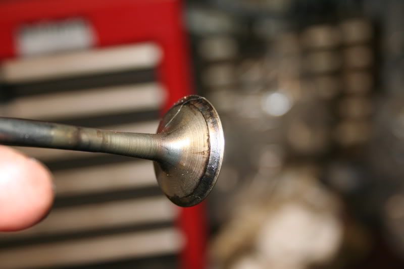

Now i'm being a bit pikey but these are very very clean if not new valves taken from the pina head. Can i use them in the other head?! Doing some reading from the history revealed that munich legends took the head off in 2009. Head gasket failed and the valve seats were all cracked on the exhuast side. So they had new seats fitted and valves. I'll need to carry the valve springs over as RealOEM tells me different part numbers compared to a stock M52. Makes sense as the camshafts are differen specs on each engine.
This is the 3rd time in 3 years the head has been off. 3rd time lucky? i hope so

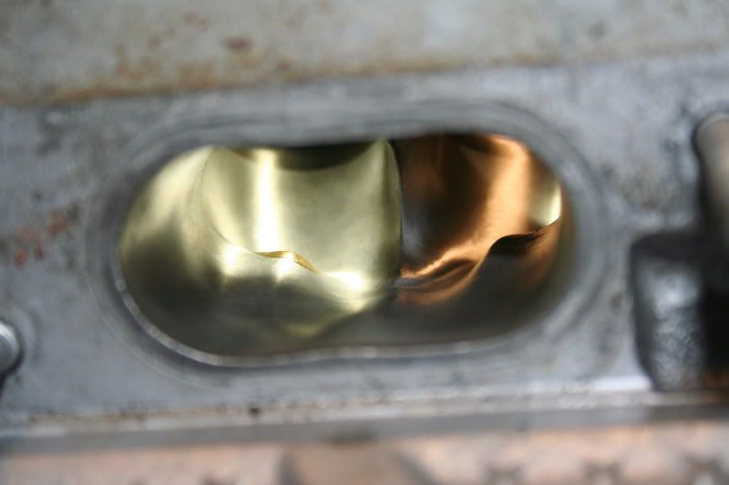

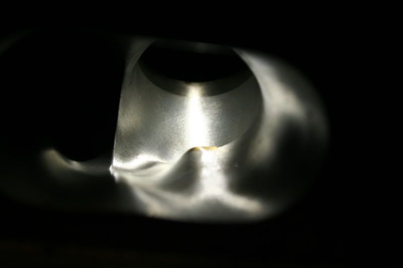

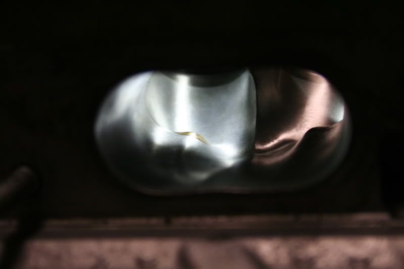

Some shots of the inlet port "work" best i can do.
And the exhaust side. Alpina make a lovely job of their head work! I'll get some shots of the stock ports once the donor head is clean. Then i need to get the same replicated on to the donor head. I'll need this if we want it to make its factory power which we do!!

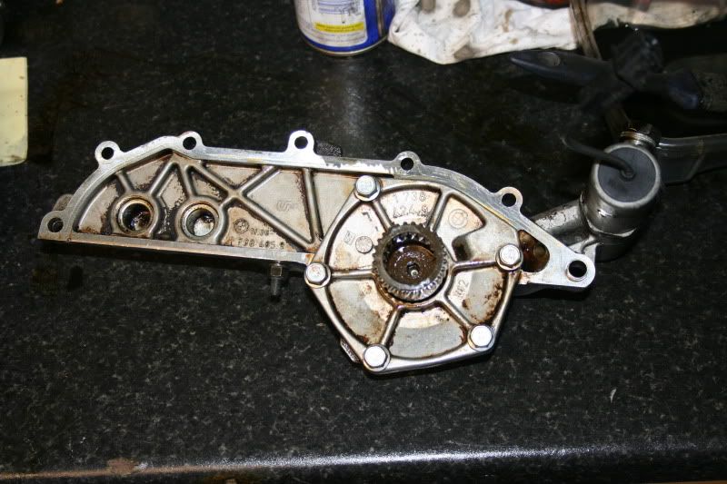

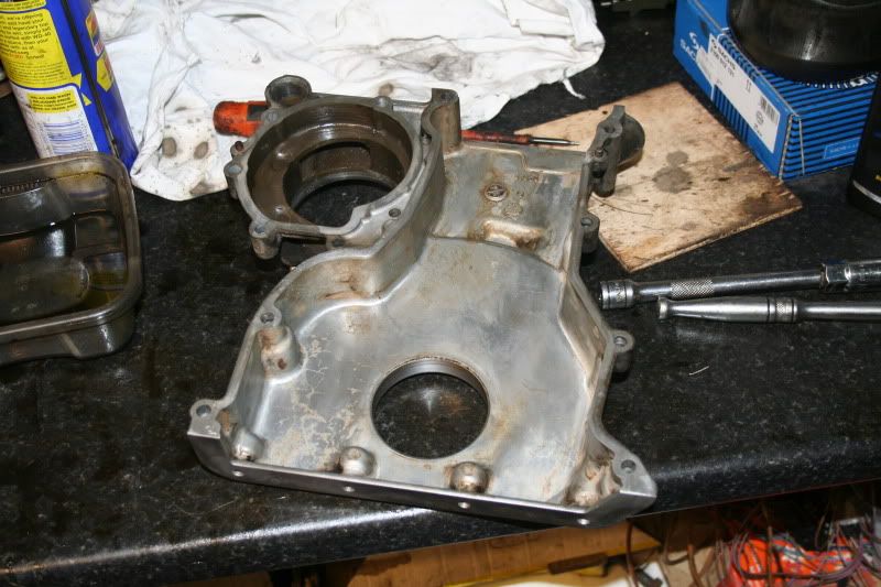

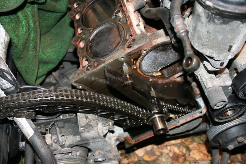

is now the time to change any seals etc in the vanos? do i undo these 10mm bolts to get into the unit as such?!

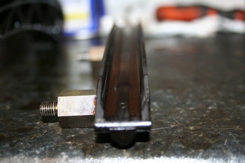

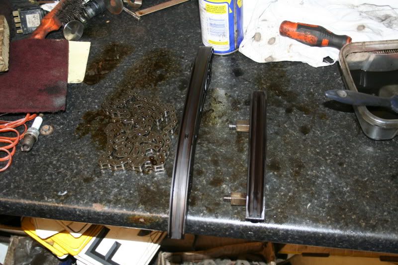

Stripped this lot off earlier, now BMW want £42 for the chain and £37 and £11.74 for the guide rails - which are made by bosch
GSF will supply a chain and rails for £70 made by febi bilstein, gotto go for this i think.

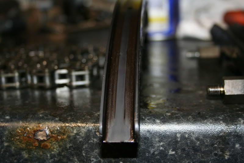

spare sprocket compared to the current one, i can't see any difference. The spare has covered 65,000 this current alot alot more!! What do we think?
cleaned the cover up, i've done some other donkey work cleaning other stuff a tickle
It bit worn, i guess this wears down the chain links a bit also?
Alpina head

The sprockets are perfect, and I daresay the chain will go again. Make sure the new chain (if you bother) is a Jwis one - look for the logo on the links. I've had plenty of Jwis chains in Febi boxes - I think Febi just act as distributors for other stuff rather than actually make it.
I'd leave the Vanos unit alone if it didn't rattle.

Well today i went to the machine shop about getting the head work re done. This lot don't do halfs and have said. Alpina made a good job/know what they are doing but it could be improved somewhat. Its not cheap to do properly, but we'd all guess that. The stock chamber shape is very very good and the heads overall are pretty good. Well done BMW in the 24 valve heads then
He thought looking at the 2 heads there could be a difference of upto 30HP in terms of what could be gained lost with the right camshaft also.
He'd like to look at the special inlets these engines have also. On about removing the valve guides also. Using a special machine that will allow him to get every port the same size behind the valve exactly the same size and a special thing again to cut the valve seats in a special way to get a perfect seat. which is £10 a valve and has to be done really. Its all a bit beyond me and all in its £800 he recons. So thats for all the port work, seating the valves and a refacing.
I'd like to but its alot of money and i'd also have to wait until the new year. I trust his opinion but i wouldn't mind others thoughts on this. I said i just want the engine to be as it was, they're of the opinion that if you want the work replicated/ or done as such on another head they can do a better job than alpina. He said theres more knowledge tools etc around now than in the 90's. Even with the cams being quite tame on alpinas.
He does heads for race/drag engines and often the heads are sent off to camshaft companys who flow the heads and build the camshaft to suit this. All interesting! exhaust and inlets are all tuned around the headwork and cam choices. Way beyond my understanding! Others can do the work of course for cheaper but this is a bit of dark art no?
Is it worth it? probably not but.............we could end up with something a little bit better than it started life as.

Simon13 wrote:My gut is do it, but a large part says bollocks bolt the stock head down and drive it
I'd be tempted to throw the known to be good head on it and drive it!
I'd hate to chuck loads of money at the head, only to find out its hiding more drama's.
- Posts: 24532
- Location: London/Surrey
A man like you with an illness for tinkering could always bolt a "worked" head on later down the line.....
....just a thought.
....just a thought.
Rodderz
- Posts: 3105
- Joined: Thu Nov 24, 2005 11:00 pm
- Location: Southampton
I think you would have to be mad to spend that sort of money on a non original head!
... The only argument is that we all waste money on cars!
