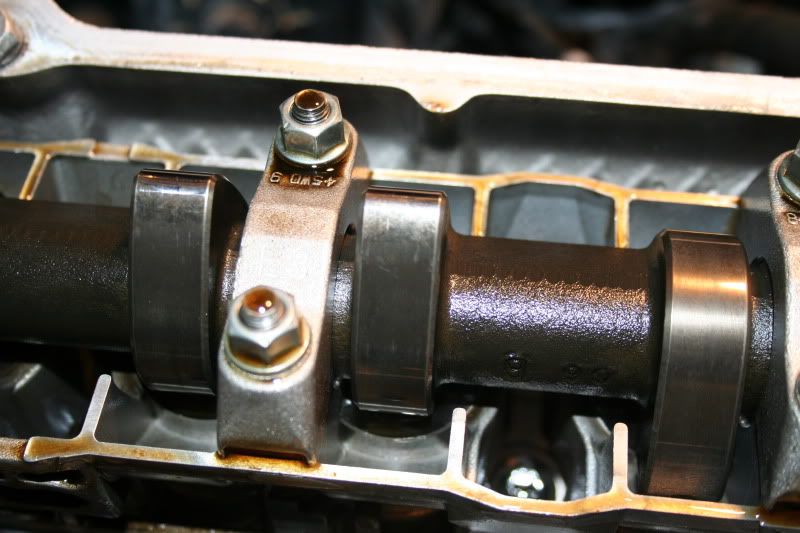

So rocker off all looks ok to my novice eyes on these. I can't see any sign at this stage of any welds its all pretty clean though
imagine an M20 cam with 190,000 on it?! it wouldn't look like this thats for sure, it would be like a toblerone

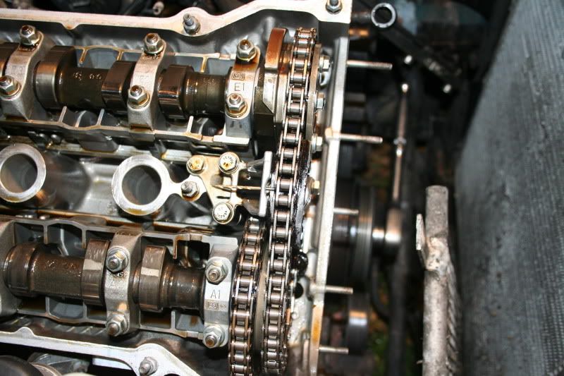

So thats how i left it with the vanos off, i've got some funky BMW tool to use for the next bit!! Which is removing the cam shafts

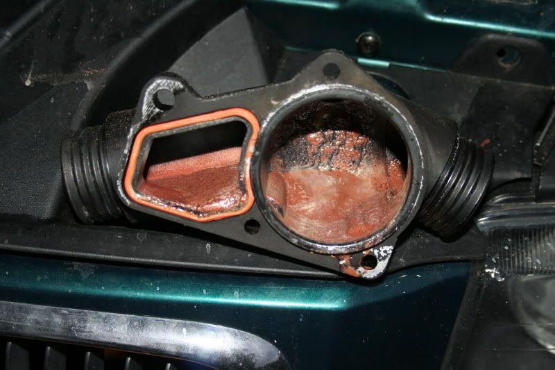

The 328i breaker I raped my donk from had the porridge box and had one of those coolers.
The copper coloured gunge in the thermostat housing looks like K-seal

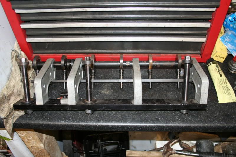

I take it you have the uber cam compressing tool to hand? I made my own :D
Take the head off before you remove the cams, its much easier/safer to do on the bench

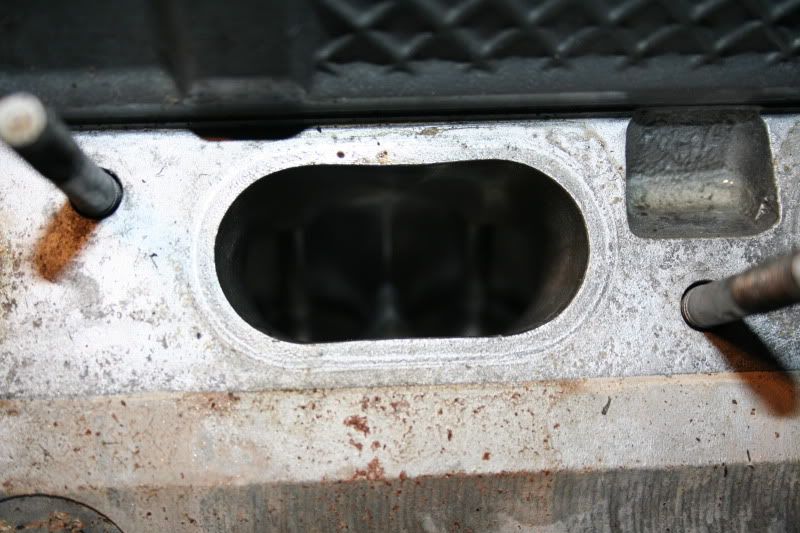

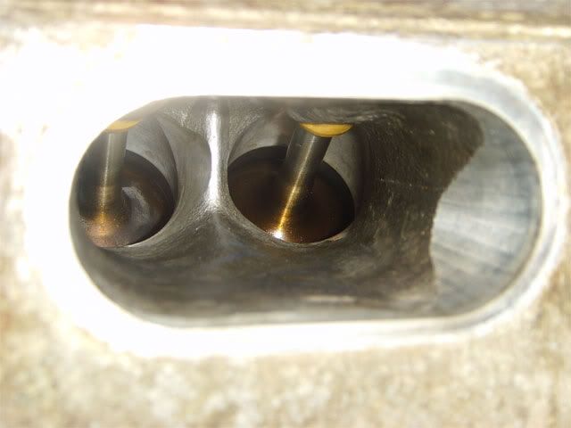

If its been welded it will be around the valve seats, pic of a standard port here for you -
The pina head supposedly has fettled ports and combustion chambers

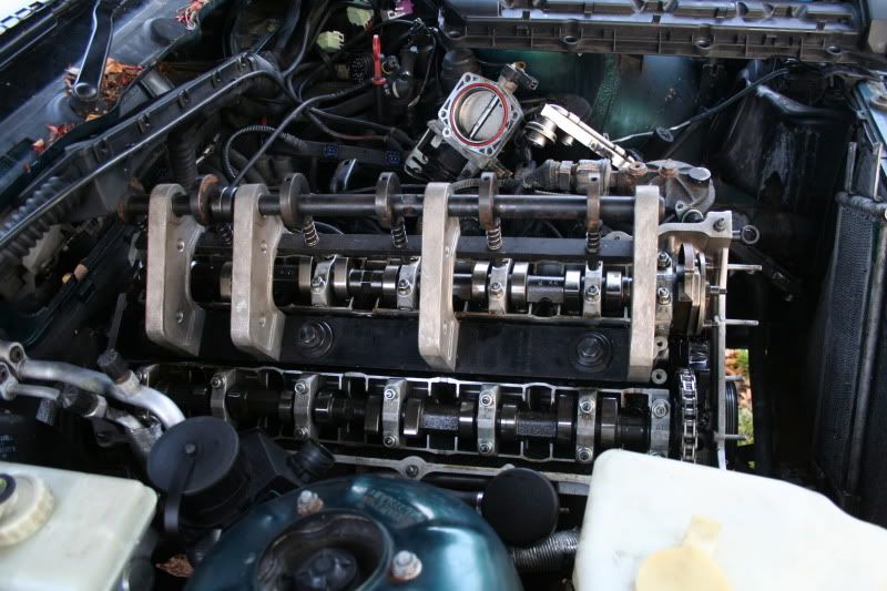

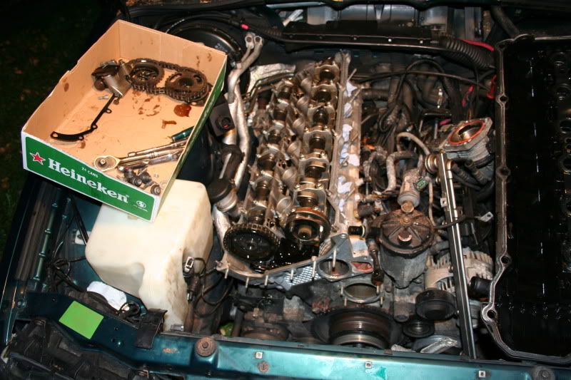

So thursday came and another stab at this thing,
out came the uber tool, its old as its got west germany on it. Must been made for the first M50's in the day!

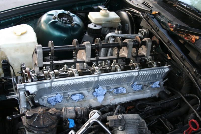

Here it is bolted down on the head, i can see why you'd do it on the bench but i just couldn't help myself! Dans right its a pain on the exhaust side but can be done. i unbolted the air con pipes by the bulkhead, barely any gas in the system so no problem. Great bit of kit the tool though
Camshafts and buckets etc removed

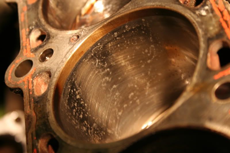

Bang! head off, with the manifolds attached, it worked. So its 110% the wrong gasket. being a bit sad i have a 323i gasket in the garage left over from a nikasil engine i stripped. They're identical down the to numbers stamped on them

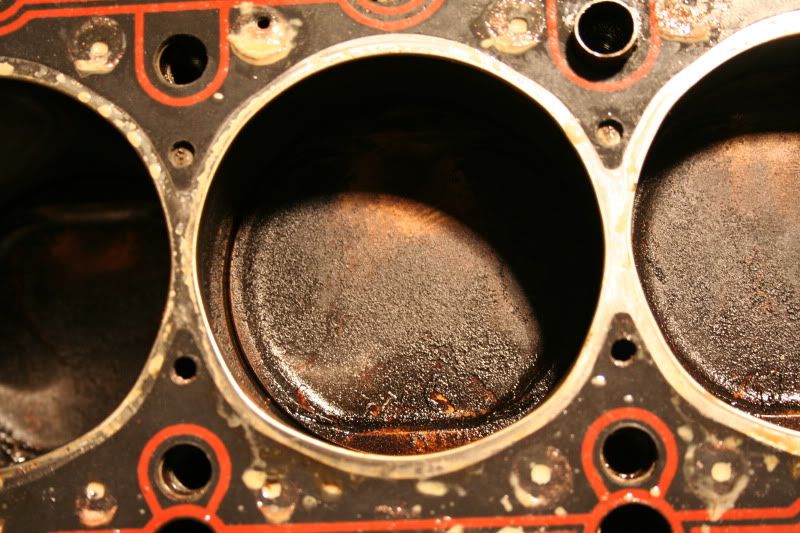

At first i thought look its beaten the fire rings out of round! but when i compared it to the other one they're identical. I'm going to put the gasket back on and turn the botttom end over and see if it hits the gasket.
With the gasket down you could run your finger round the whole bore and feel the lip of the fire rings sticking out
Nice honing on the bores still
Apart from this one which looks like its gone a bit rusty and been cleaned to me :? Incidently its No.4 which has had the piston crown cleaned up which leads us onto the cylinder head
bodge tastic on the exhaust studs only about 4 out of 100 were tight and a fair few where half hanging out!
the head, looks ok by eye but you guessed it no.4 port is very very clean. Its had a tap or something wound through its spark plug hole. I'm guessing this was where the head cracked? The head appears to have unfettled chambers to my eyes but the exhaust ports look tickled like the inlets.

Pardon the 'tarded question but what's that crazy tool actually meant to do :?:

Kedge wrote:Not hanging around at all!
Stops the cams lifting/bending as you undo them, and as a result avoiding snapping them.
There usually that much risk when removing a cam?

Kedge wrote:
Yup, on 24v cams they are hollow, and high risk!

A clean piston/combustion chamber usually indicates coolant has been present for quite a while, the pitting on that cylinder says to me its been left full of water for a long time, wont cause any problems though, at worst it will burn a very small amount of oil.
Regardless of who has done the repair/pressure test I would have it tested again just for reassurance, you dont want to bolt it down to end up removing it again

Jhonno wrote:,
Kedge wrote:
Jhonno wrote: Stops the cams lifting/bending as you undo them, and as a result avoiding snapping them.
Hi risk indeed! Especially putting them back in!
