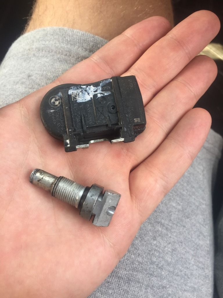

Hi guys, I have a 2014 F31 I had an issue with some tyre valve caps that managed to weld themselves to the valves. My mate in trying to get them off managed to rip the head off the valve completely. RAC came and put a replacement standard valve in for me at the roadside but I need to sort out the tyre pressure monitors.
Is the valve and tyre monitor all one piece and therefore the whole lot needs replacing, or do I just need a new valve fitting to the exisiting sensor and refitting? Will the car need programming again to accept either a new or replacement sensor?

If you buy one from BMW you get the whole sensor that needs programming and you will need a decent diagnostic machine to programme it. But you can strip the valve from complete unit and just swap valve itself. They’re about £80 from BMW.
Have you got a picture as I’m pretty sure they’re identical to Vauxhall ones which are about half the price.

maxfield wrote:If you buy one from BMW you get the whole sensor that needs programming and you will need a decent diagnostic machine to programme it. But you can strip the valve from complete unit and just swap valve itself. They’re about £80 from BMW.
Maxfield, pictures as requested

https://rover.ebay.com/rover/0/0/0?mpre ... 2619182928
Has the sensor itself been rattling around the wheel?

Blinding. Thanks for that link mate. Yes the sensor was rattling around for a bit, however looks to be undamaged and in one piece
