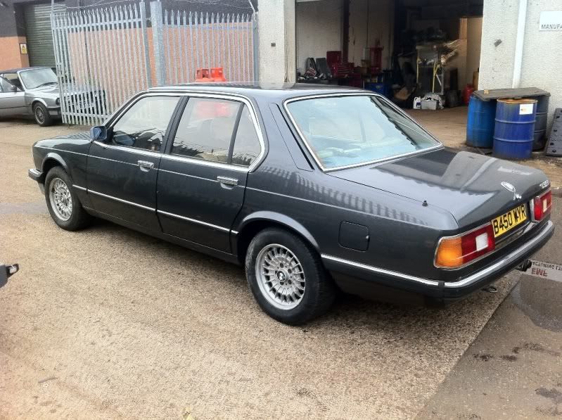

The other lights took a wee while as some of the connectors were a bit ropey, but this old 732i Sport:-
(sadly bought pretty much for its sport steering wheel) provided a couple of much better connectors which were soldered in place of the scotchlock butchery previously fitted. Getting everything working again took a wee while, but now all lights work - in fact everything needed for an MoT works, washers, wipers, horn, lights etc. The aircon doesn't. The headlamp wash wipe doesn't, the headlamp adjusters don't.

The old 732i donated its radiator, various wee clips and spring clips, some wiring, steering wheel, radio blanking panel, HT leads, windscreen trim, bits and pieces and most importantly, a test car to break things off to see how they go back on properly. This sort of thing is so much easier to do with another car that's only biding out its time nearby. I'll save what's useful - including the sport suspension - and should get what I paid for it or very close over the weighbridge.

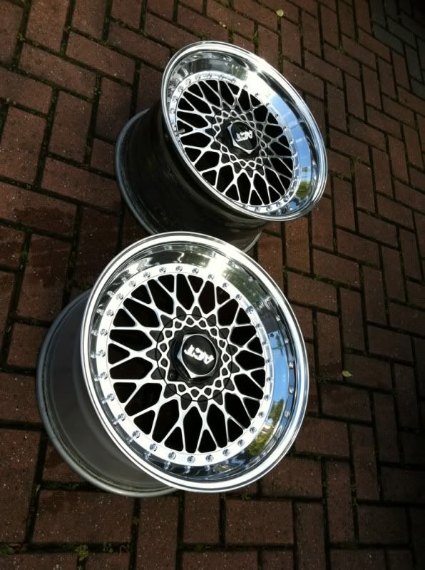

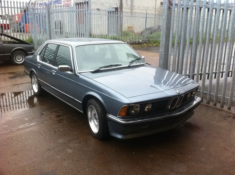

Still needs brake hoses fitted - it has new copper lines throughout, brakes bled and the PAS leak needs fixed, and thereafter its off for a valet and MoT. A set of staggered Style 5s has been sourced and I'm hoping it'll be set to perform its first official duties at my son's graduation in mid July.

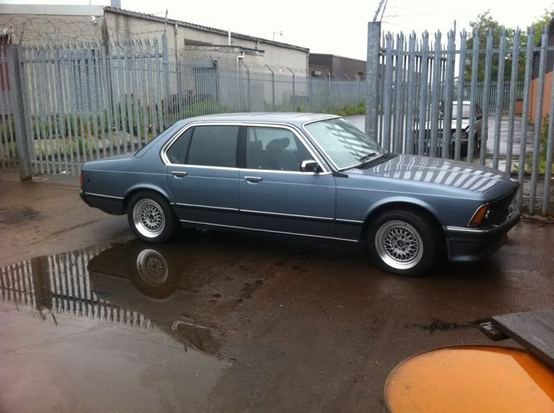

Its first venture outside under its own steam for many years saw it introduced to a typical Glasgow summer.
