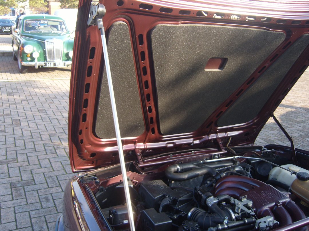

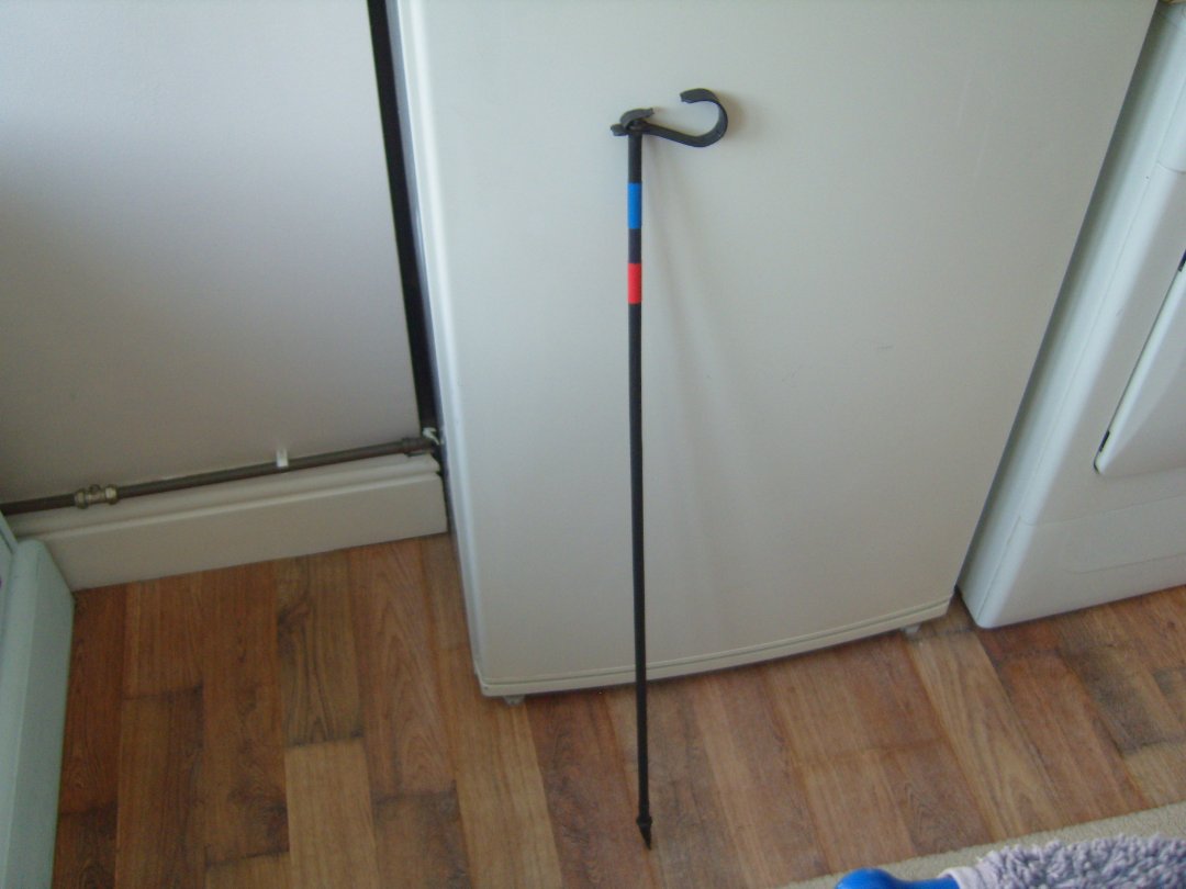

Made these bonnet supports for extra safety at car meets when the wind gets up.
Posts: 6204
Sat Dec 01, 2018 1:42 pm
What a great idea for the heavy bonnet :clap: :clap: :clap: :clap: :clap:
Have you thought of making more of these to sell to fellow zoners as they are good peace of mind for when you are under the bonnet ?? :woohoo: :woohoo: :woohoo:

Just a bit of background I had the bonnet come down on my head putting me in hospital, so never trusted the gas strut even though they were genuine BMW parts. I will look into your suggestion Mart, maybe do a video on how to make them.

I have made a number of what I call safety bonnet supports for friends with E30s and they have been well received, believe me you do not want a bonnet to come down on your head :eek: .
Parts and actions required.
1. Alloy strip, nuts and bolts, metal tube, plastic washer.
2. Shape top hook.
3. Make hook catch with foam pad.
3. Make bottom pin and plastic washer
4. Attach parts 2,3,4 with nuts bolts and pop rivet .

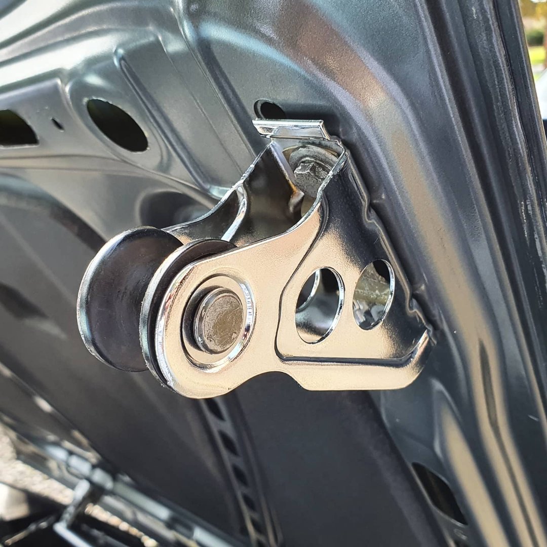

Some jobs on the e30 can be challenging like changing the bulbs at the back of the heater controls or access to the OBC, the bottom two screws holding the control panel can be awkward to access, so I have had made a couple of fixings to make it easier for future removal by hand, and they are shiny. :D
Cloggy Saint
Posts: 8026
Location: zummerzet
Wed Jul 03, 2019 11:39 pm
Now that's smart. It sometimes takes me months to replace the left screw! Put me down for a pair, they don't have to be shiny :wink:

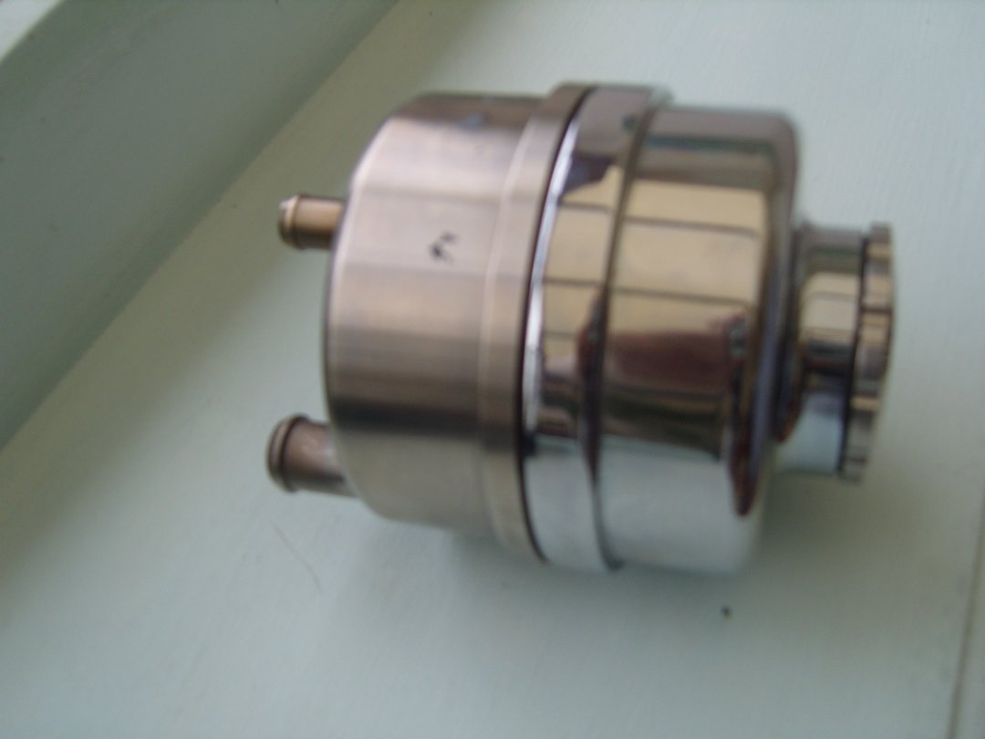

Another example of the Toolmakers skill is this shiny cone air filter adapter.
