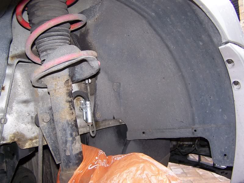

Is this a good underseal to use for the arch's? Also anyone got any tips on undersealing the bottom of the car, think i might aswell go for it if im doing the arch's...
