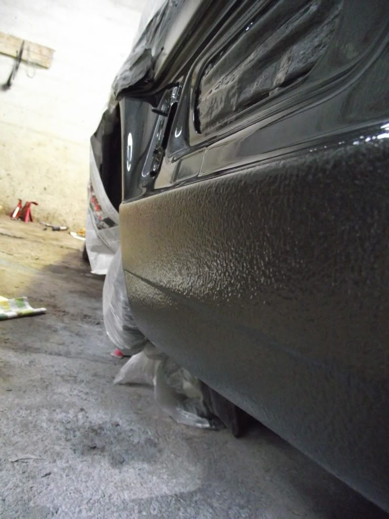

You need a shutz gun, the Wurth stuff does come in an aerosol but you won't get the right finish, gravitex sounds like it might be a better option if you don't have a compressor and gun, an airbrush won't give the right texture either, I doubt it would even come out the nozzle, not sure you can thin it enough.

so i need an arosol version, can i paint over it with body colour? want to match the whole car incl sills in body colour eventually.

Yes, you can buy Gravitex in an aerosol, it is over paintable.

Sorry, my bad. In aerosol form It's called gravi-guard.

Iv used Gravitex anti stone chip with a schultz gun. gives a factory finish

Gravi guard it is then, since i don't have a schultz gun.

One thing though, i have tried the areosol type stone chip and it doesnt give the same results, its the schultz gun gives the rippled effect.

i assume a schultz gun runs via compressed air? if so i am totally screwed then since i don't have a compressor. any idea's on how to get the same or a very similar result without? got filler on the rear valance and need to match it all up with the anti-stone chip suff.

BEMER_LAND wrote:One thing though, i have tried the areosol type stone chip and it doesnt give the same results, its the schultz gun gives the rippled effect.
Have you tried Gravitex in aerosol form???, you are right though most other aerosol stone chip products don't give a suitable effect, I found graviguard to leave a textured finish when I used it to touch in the sills on my old golf, granted it wasn't as good as that of a Schultz gun but in this instance better than nothing I reckon.
