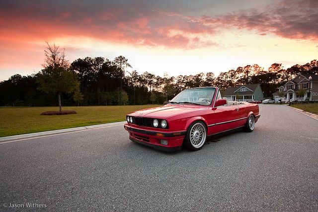

Fair enough, but the red vert has been fill and drilled, i can get the link to his build thread he's a member from stanceworksmrLEE30 wrote:If done correctly then nothing really wrong with filing the holes with aluminium and then re-drilling, if done incorrectyl then the things are dangerous, but that said the internet is hardly plagued with stories of drilled wheel falling off. But you may be lucky if you find a company that will do it for you, and if you do the price will be similar to converting to 5 stud anyway.

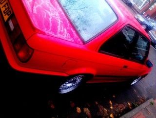

Red Vert:

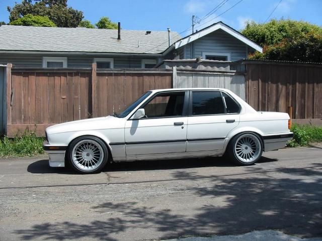

White 4 door with Alpina's:

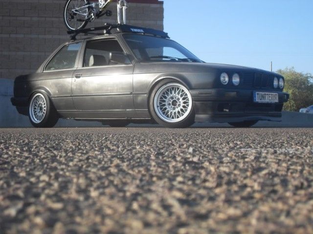

Black 2 door:
The BBS's are from BMW 7 Series E38, and the Alpinas are probably from a 3 or 5 by the looks of it from what i can remember they are 10j on the back.
